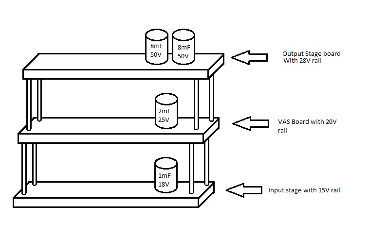

I am planning from initial to have one transformer, one rectifier, and 2 sides of reservoir (stereo). Only reservoir are separated from each other with stereo configuration.
Each rail on board have its own reservoir, so should be no problem. (as I illustrated in picture. 8mF for positive 28V, 2.2mF for postive 20V, 1mF for postive 15V)

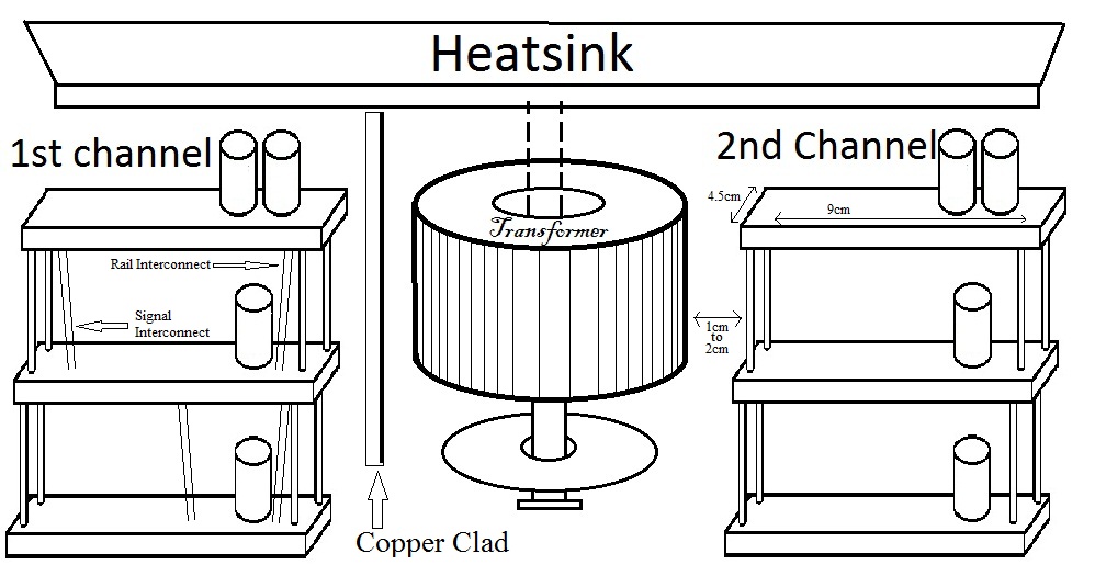

The below attached is my design concept. Everything is below the heatsink, and if the toroid is messing with my circuits, I would eliminate it by putting a copper clad board (un-printed circuit board). Would this be helping ? (I guess it should be grounded ?)
Esperado, you mention about the oscillation for high slewrate, so I should make the IPS & VAS as compact as possible ? (what about OPS ?)
I think i'm changing my 3-board design into 1-board, if there are too much problem. Is it possible to make 2-board of positive half and negative half ? (but its quite difficult to design and built)
Is it unwise to attach transformer near main heatsink ? (my heatsink is anodised surface aluminum)

Stacking boards is not very desirable when thinking maintenance / tweaking.

There is also some thermal and mechanical reasons not to go there, one concern on stacked PCB's is thermal induced mechanical stresses that ultimately leads to solder failure.
The circuit is really quite simple so why not keep it on one board...??

Well... my idea is that common ways of amplifier is making is wide, big but not so tall. (alot of ground area used)
My idea is to reduce ground area used by making it higher with 'racking'. So it will be tall, slim & narrow. I think I had to give up though.... way too much trouble i get into ^^

You can simulate any track or wire by a serial resistance, a serial inductance and a parallel cap, proportional to their length. Any single wire, any lengh of printed circuit track will introduce phase turns and attenuation at HF.
Each amp stage, input, VAS, driver, power, is a pole. any wire between those poles will modify their phase and response curve. All those poles are included inside the global loop, and Mr. Nyquist had explained how it behaves concerning stability.
This amp is a very fast one, we are dealing with phases at 3 to 10 Mhz.
More than that, each wire can act as an antenna, and make your amp more sensible to HF electromagnetic fields.
Your multi stack project seems a bad idea, according to those problems, because it increase the length of the wires between each stage where you need to shorter them.
And, as said bobodioulasso, not very easy to tune the value of a resistance or adding a little cap on a board stacked between two others on a working amp during the tweaking period.
Last, as previously said, each connector is a risk for viability.
So, i you want best performance, and less stability issues, stay with a single board for the amp itself, keeping the total surface and length of the critical connections as short as possible.
No problem to fix a transformer on an aluminum Heat sink, as aluminum is a-magnetic.
But keep your transformer far enough from the low level sensible parts amp circuitry to get rid of electromagnetic leakages from the transformer; both for the 50/60 Hz and the hf parasitics that outlet carries. And remember that a coper shielding will do near nothing against those electromagnetic shield. Only special mu metal can help.
