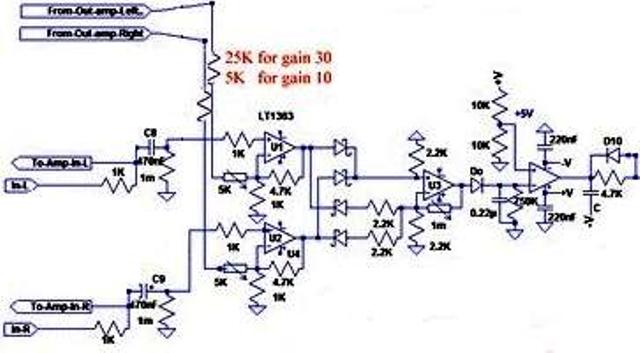

I would really like you to discuss with you about my protection circuit. And to see his "failure" detection part in your final circuit.
Because it is beautiful, and had proven his efficiency on the worse conditions and different amps for decades, in the worse difficult situations (Big PA systems).
The idea is simple. Instead of analyzing the output signal, integrating-it to detect DC in output etc.. witch is slow and complicated, i just compare input and output signals.
If any difference (a working amp is supposed to be a strait line with gain) you can detect-it instant.
The theoretical circuit is very simple. First, you adjust output signal to the same level than the input one (inverse of the gain amp). Then, in an OP amp or a comparator, you make the difference (you can give some gain on this differential signal if needed).
With a second op Amp, you rectify the error AC signal.
Then,you just have to chose the threshold witch will fire your protection.
This error signal is very interesting, in real world, to see how bad is an amp with a loudspeaker's charge on transients signals ;-). An interesting tool for design too.
This simple and economical circuit will detect instant (µs) everything that can happens bad in an amp: HF oscillations, (even only on transients), DC, and, of course, short circuit on the output. It can use only a double op amp and few resistances around for 1 channel, or 3 amps for 2 channels.
One schematic to illustrate here:
http://www.esperado.fr/images/stories/protection-totale-definitive-mini.gif
(Do not take care of my relay command and power-on delays parts)
Fell free to use-it as you like, if you like. You best original amp need the best original protection. ;-)

Thanks for your appreciation. (Yes it was the part i was talking about ;-).Hi Esperado
This part of it, if proven as you've said, is really a pearl.
Proven ?
It need some comments. Using fast op amps (to minimize phase errors) you tune the gain to reach the minimum differential signal.
Then, even with a very powerful low distortion, low impedance power amp with a large over sized power supply, you will see amazing errors on kick drums, listening to music with your speakers.
This can bring the protection to fire at each kick, even at surprising low level..
This will change your mind about the way our "fidelity" dreams are turning in real life ;-)
That the reason why we need to tune a threshold.
This threshold can-be sensitive enough to let the protection fire if the amp saturate, even very few. But you can let some margin, as it depend of the loudspeakers and filter impedance curves and efficiency (moving coils currents).
It with fire with any oscillation (or DC offset, or parasitics), far, far before it can damage the most sensitive tweeters or amp parts. (if the protection can cut the output fast enough)
It will protect the amp for output short circuit even at very low level.
At the time i had this idea, i had made many demonstrations, trying to sell-it. Hundred of output short circuits at various musical levels. With never a failure, never a noise.
And, on my personal amp, my protection circuit using this idea run since decades.
Because it fire instant at low DC offsets, it will protect the system from commutation clics at power on/power off. The loudspeakers will be disconnected during them.
Of course you will add a delay before loudspeakers will be connected again after protection had fired.
On my amp, the loudspeakers are not connected at power on until the original delay is passed and the protection will wait for any DC stabilized before connecting them. On power off, loudspeakers are disconnected instant., long before power caps had been discharged. No slightest noise or clic can be heard at all. I had added a delay to limit the power supply current during the time it charge their big caps. And an other static relay to protect the amp (direct coupled) from any DC in the input
I use this comparator circuit idea as a measurement instrument, looking to the error signal with my oscillo, to evaluate all my amps on the test bench. It is very helpful.
LC, as the part of your protection witch cut the output signal is part of the amp itself, (as you said, i use mine as an universal circuit), may-be we can simplify further this idea.
May-be we can take the differential signal at the input stage's emitters, and, so, get rid of the differential stage itself and the input/output levels balance fine tuning ?

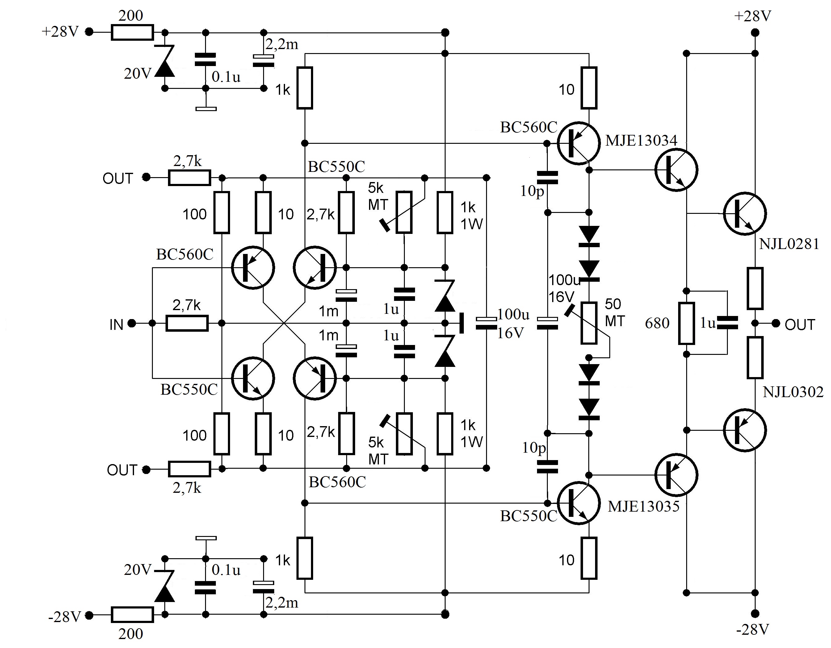

Hi, the experimental LATFET amp with 3 stabilizing Jfets works and plays but I am in the thinking of a servo to free it from periodic re adjustments due to changes of ambient temperature bcs of seasons or environment.
There is Bigun's TGM5 to contemplate too which is Sziklai also but all BJT, finished, has BOM, and of course has LCSSA input topology. http://www.diyaudio.com/forums/solid-state/196973-tgm5-all-bjt-simple-symmetric-amplifier.html
LC, This is the following amplifier i;m going to do. Should rated maximum at 120W @ 4ohm for my situation.
I'm planning to build it in 3 layers (very small board). About on 3board of 4.5cm X 9cm.
First board will consist of Main reservoir(28V) with OPS.
Second board will consist of secondary power(20V) circuit and VAS.
Third will be input stage with its power circuit (15V).

But your project to split your amp in several board is affraying. 1/2cm more on the tracks of the power FETS of mine transform-it in a 150w HF oscillator !
Remember that we are on Mhzs and wires (or track length) are inductances.
By example, non symmetry on the output lines and specially if the point where you take your CR and output connector is not in the middle can increase the distortion by a factor of 10 !
I think he means one 3 layer board rather than 3 separate boards. Thinking through the possible interactions between the layers would be essential. Perhaps going to five layers with 2 ground planes between the others might actually be simpler ? ? ?
The other feature that allows more compact layouts is having components mounted on both sides of the board.
