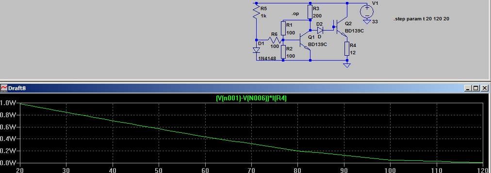

AC looks good , too. Tested with capacitive and inductive looads , next a simulated 2 way speaker.
A test with a practical device unveiled that thermal compensation is not optimal.
In fact an overcompensation happens. Thus after a sine burst with a signal amplitude such that the max power dissipation is reached (Vcc²/pi²*Rl) for each BJT followed by a burst with low amplitude I see crossover distortion
as the quiescent current fell to 10 mA from 78 mA. Thus the Vbe multiplier must not be in thermal contact with a heatsink for the drivers ( not for the power BJT) to compensate for their junction temp.
This is the effect noticed by P. Walker which led him to develop the famous Quad 303 triple cascade "supertransistor".
Without thermal trak diodes a Vbe multiplier mounted on the heatsink would "see" temperatures from events in the past as "heat travels" by diffusion.
If one wants perfect reproduction of "dynamic structures" and is less obliged with lowest thd in steady state this behavior is not tolerable.
Thus this thermal trak compensation requires more research.
The goal is to keep the voltage drop across the emitter resistor constant at 26 mV.

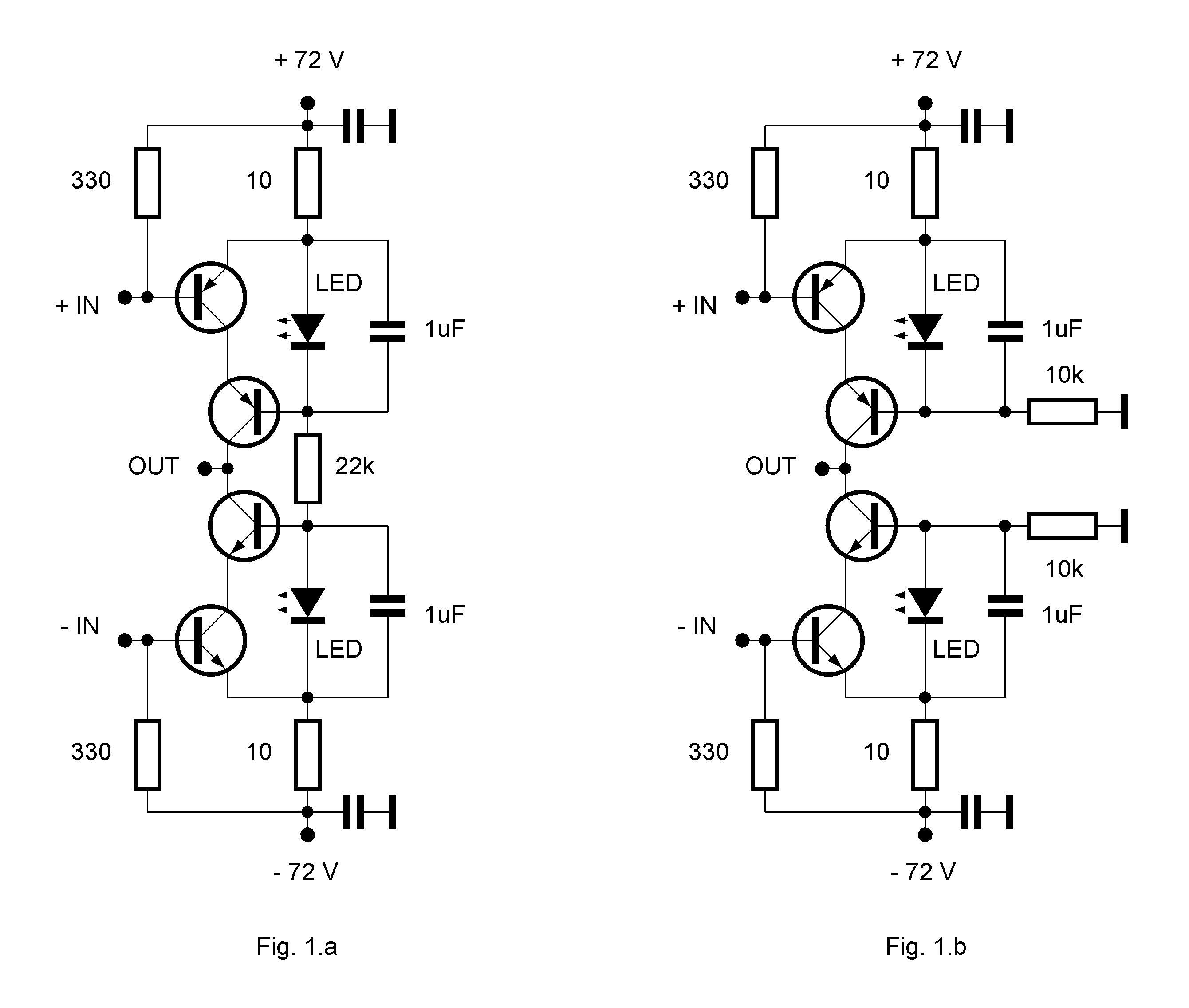

Please guys some comments about Hawksford cascode in attached circuits. Will there be any difference between a. and b. schematics performance?

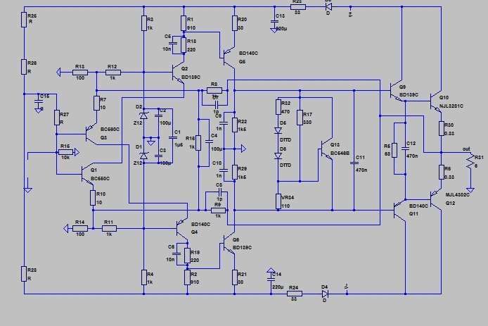

Anyway this EF does not take advantage from the excellent ß/ic linearity of the Eon thermal trak devices , a linearity btw. unmatched by tubes or FETs. Thus in a final version the BJTs must be current controlled that is a current source should force the base current with non linear Vbe following but having no effect on distortion.
Would like to see your final SSA circuit.
This is the first version that lacks some elegance . But data ( simulation) are very nice
nothing to complain. No oscillation on complex loads ( simulated 3 way passive crossover with simulated speakers) . Good thd spectrum but not very good. Could be tweaked to some degree by variation of predriver and Vas op.
Sensitivity to changes of complex loads average.
Will route a PCB . The predriver BJTs and the zeners will be placed on a heatsink held at 70 degrees by simple thermostate circuitry.
Transistors Q2 Q4 (B139 BD140) will be replaced by BC639 BC640 or Japan types with higher Vce max Vcb max ( 150 Volts and up) . Ole CRT video BJTs out of stock.

Common mode rejection better in fig 1.a ?Will there be any difference between a. and b. schematics performance?

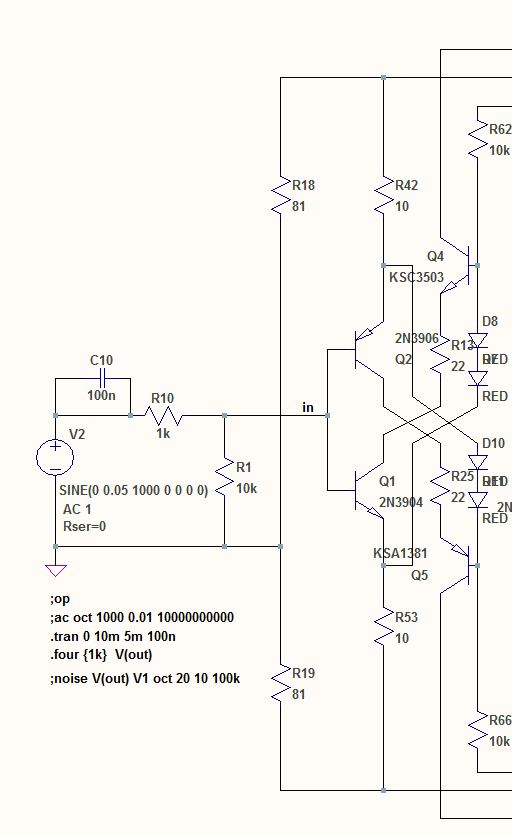

Input cascode could be arranged like this...
... so tracking (Hawksford) cascode at the input as well. Some decoupling for the series diodes? 🙄 BTW nice criss-cross connections 😀
Just measured output impedance without gate stoppers: 4,7 mohm/20 kHz. Razor sharp square pulses at 100 kHz/4 ohm 😉
