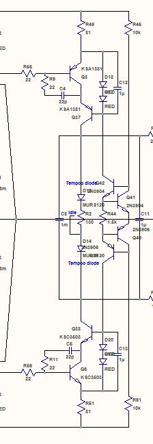

Please guys some comments about Hawksford cascode in attached circuits. Will there be any difference between a. and b. schematics performance? :grouphug:
I prefer the first circuit, as signal currents won't flow through the LEDs and feed resistors. The impedance at the cascode bases is also larger, so less current will flow through the resistors and make the Hawksford cascode more effective (but this might be negligible depending on the impedance of the LEDs). Furthermore, less components needed...
Increasing 10 ohm Re, let's say to 100 ohm will decrease OLG significantly. Isn't the main objective of tracking cascode to hold Vce of VAS gain BJT at constant potential to eliminate Cbc potential variations and thus make distortions independable from bandwidth? How does the value of Re influence enhanced function of tracking cascode? 🙄
The other function of the Hawksford cascode is that the base current (thus all Early and Cbc currents) enter the cascoded transistor's emitter and then the cascode transistor's emitter, so the cascode "drives itself". This cancels all Early and Cbc currents, giving the cascode an extremely high output impedance. However Re needs to be large so the small base currents are confined to the emitter. It is the same principle as the Baxandall cascode.
Now that I think about it there won't be much benefit in this circuit of a large Re because the cascodes are feeding a low-impedance common-emitter stage, so it will probably be negligible.
The cascodes could easily be turned into Baxandall cascodes, rather than increasing Re, but this would probably not bring any technical benefits.
I will prefer [A] just by intuition. From building experience I found that I don't like typical circuits when it is connected to ground instead of floating to the opposite rail. For output driver (EF) I definitely like floating one. For cascoded VAS I like it floating also (such as done by Accuphase, not grounded as in Crescendo). May be this is related to available noise in the ground level, but may be not as I think I prefer an LTP constant current source connected to rail instead of ground (assuming that rail has higher noise).
For VAS the cascode must be floating, if you ground it like suggested in b. The 10 Kohm ground resistor sets the led current. When the signal is present the voltage varies over that set resistor, which in turn modulates the led current and thus modulates the spread in the casode voltage. That would remove any gains from placing it there in the first place..so either the connected resistor or as I suggested a high-impedance floating current scouce. 1mA Supertex depletion mosfet would make a rather nice choice.
