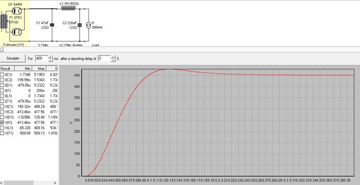

I did a quick PSUDII simulation assuming 80ma for each KT88 and another 20ma for the 12AT7's......I'm a bit rusty here but maybe not too far off. You should end up with around 450VDC.....maybe a little higher. You can adjust this voltage lower by using a smaller uf first cap after the 5AR4. Keep in mind that there is a max uf value for the first cap after the 5AR4, exceed this value and the rectifier may arc over and die. I think it may be around 68uf but I can't remember...
If you want more volts you can use SS diodes, they drop less volts......and as George mentioned in the build instructions current limiters at startup are a good idea. CL60's or CL90's are pretty typical and easy enough to wire in. SS diodes also don't have the constraint for the max value of the first capacitor like vacuum tube rectifiers do.

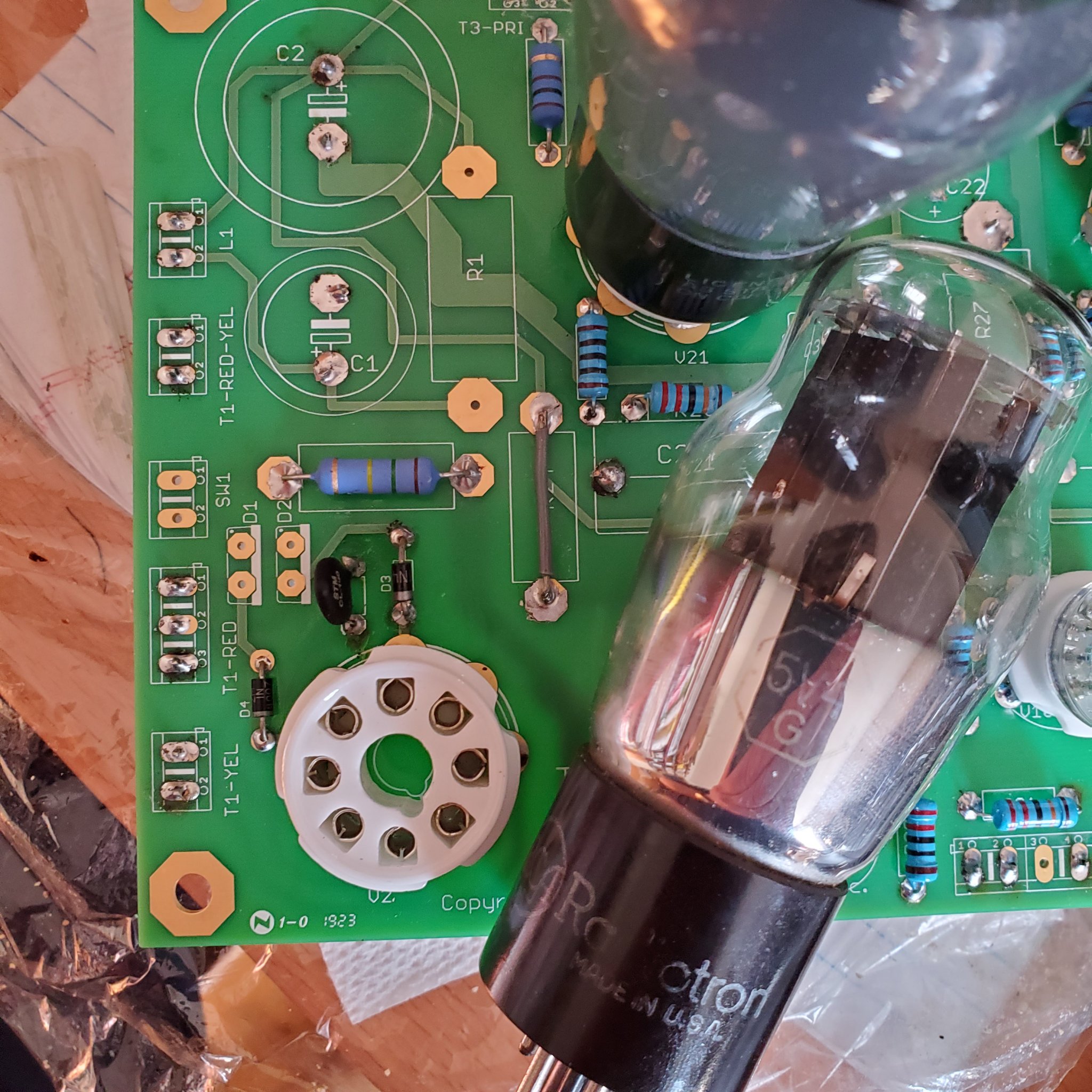

There may have been a bit of crossing information.
If you look at the PC board top, lower left, you'll see pads labeled D1, D2, D3, D4 & TR1
D1 & 2 are for the hexafreds for SS rectification.
D3 & 4 are where I was saying it's fine to use 1n4007 diodes. They are for some protection of the rectifier in case of a hot switch scenario.
TR1 is where the CL-140 lives.
The current limiters go on the AC mains input...don't worry about them, you'll figure that out later. They are easy to wire in.
