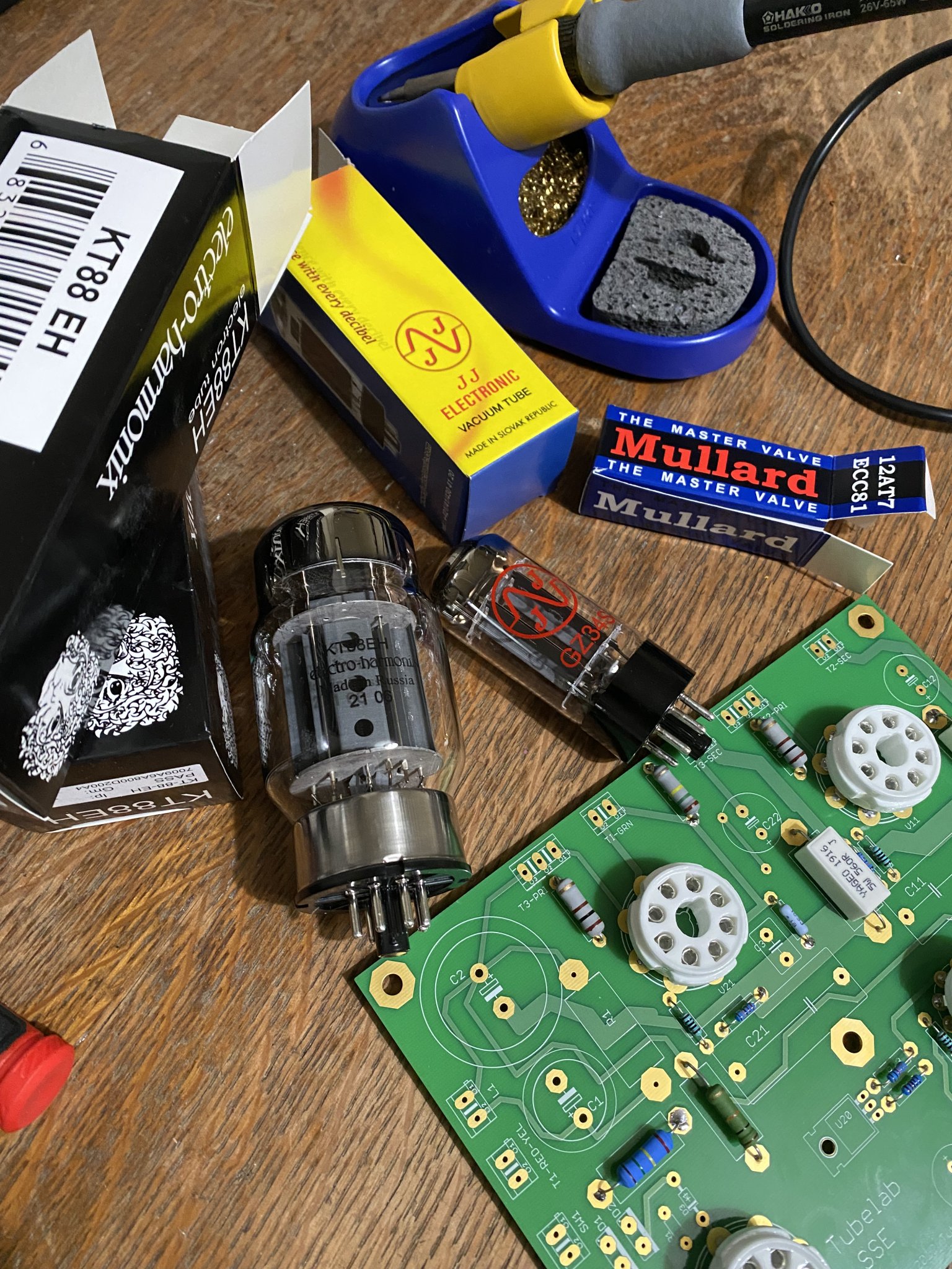

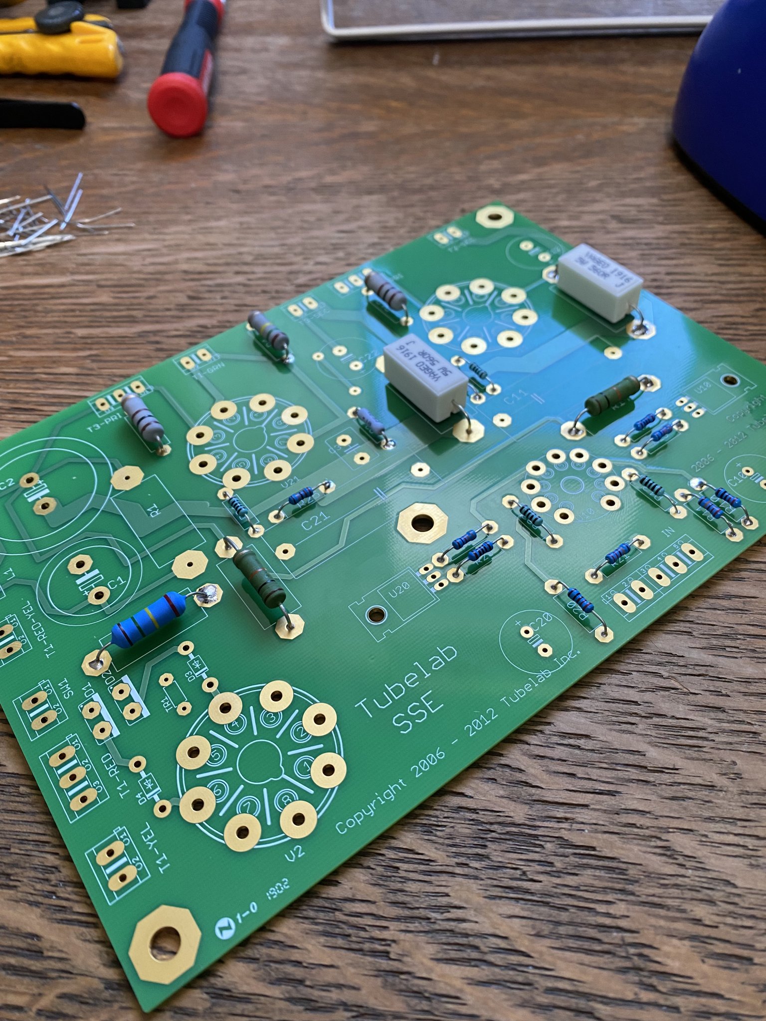

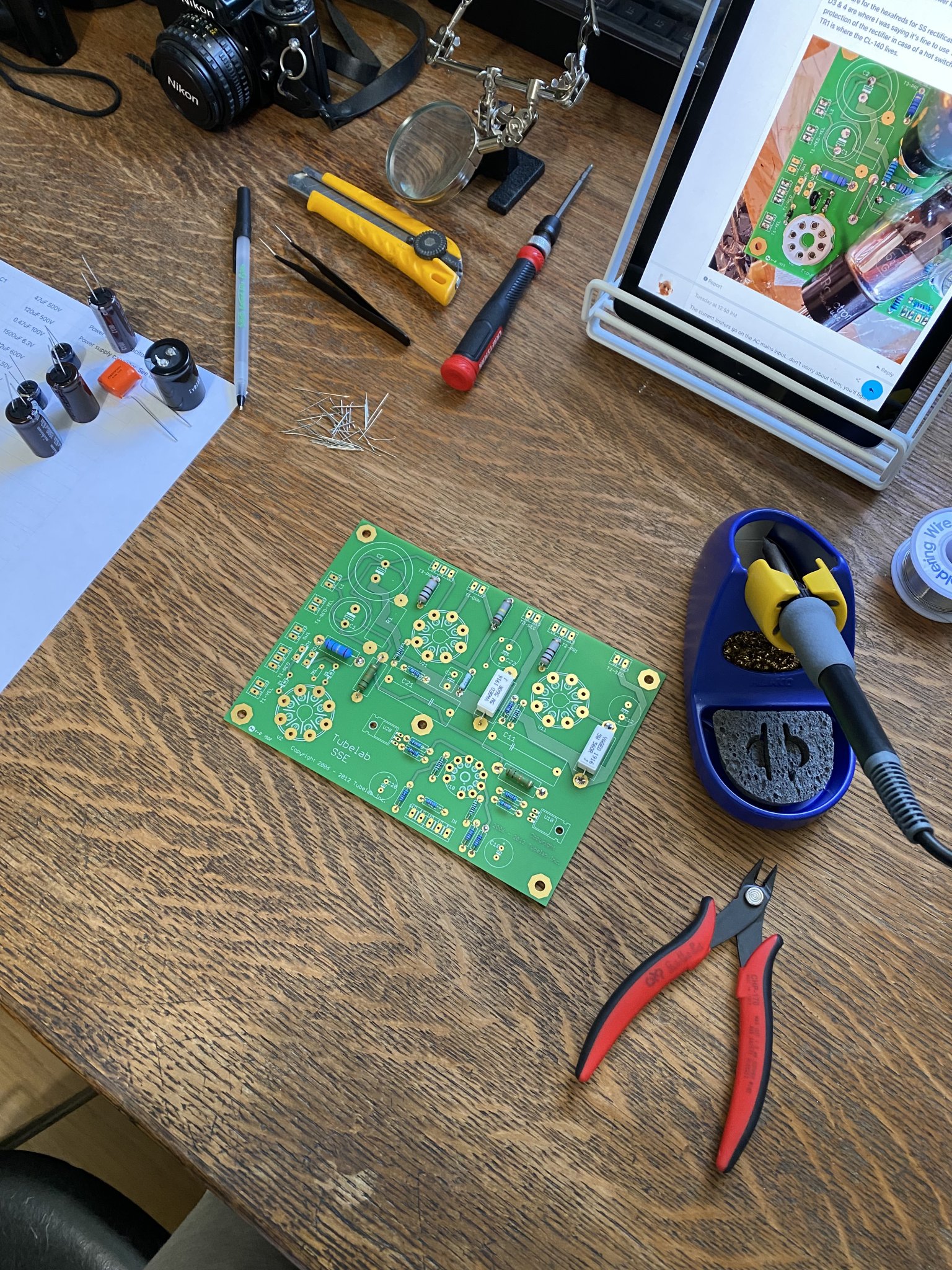

Parts are starting to show up! I started soldering the resistors today. Coupling caps and tube sockets should here in the next few days 🤞
Little update- tubes showed up today! Sockets too.
Not only that, Edcor emailed me to let me know they shipped out the power transformers I ordered! Their website said I shouldn’t expect them to ship til April so that’s quite a surprise.

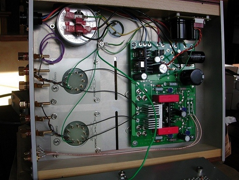

The cat5 wires are for the RCA's to the board; the speaker binding posts will get transformer output wires connected directly to them. Twisted pair CAT5 wires work well; if you want more shielding there are small coax wire types available. You want to keep the input wires from the RCA's away from the mains wires and heater wires as these are AC and they can induce 60hz hum on the input wires.....and if you use the cat5 wire keep it tightly twisted. You should be fine..but sometimes you will need to chase down hum.....and it can be a PITA.
I suggest doing a star ground scheme....there are a few ways to avoid ground loops (which make hum) and star grounding is simple and effective. Keep in mind that you have two grounds....signal ground (like speaker negative, RCA negative, etc) and chassis/safety ground. Pick a fastener on the top deck (like a transformer hold down screw..any screw really) and terminate a green wire safety ground from IEC inlet to this fastener. This is the most important connection in the amp......it keeps everyone alive if high voltage gets on the conductive chassis.
I develop medical devices for a living and there are lots of requirements for this ground......but here's the basics......use a ring lug on the end of the wire (not a spade or a faston) and build the following sandwich on the threaded stud/fastener sticking through the top plate....star lock washer then ring lug then another star lock washer then nut. The star lock washers Bite into the aluminum deck and the ring lug and the nut to get a low resistance ground connection. You will then ground the signal ground from the board to this stud/screw as well using another ring lug and star washer...so your signal ground/chassis-safety ground (and any other grounds that you need) all terminate at this point. If you add another ground use a ring lug and star lockwasher....just like adding beef patties and lettuce to a double/triple burger. :p Ring lugs are used so that if the nut loosens the ground leads won't fall off the stud.
You want the signal and chassis grounds to meet only at this connection.......that means your negative speaker binding posts and RCA terminals need to be insulated from the chassis if you are mounting them to the top plate or other chassis metal, otherwise you will have multiple ground points and ground loops. If you install the binding posts though exotic hardwood ;) they're already insulated. If you use a metal bottom cover tie this to the star ground point with another green wire with rings lugs on both ends and star lock washers. I usually use one of the threaded fasteners holding the feet on the bottom cover for this connection. All of your exposed metal chassis surfaces should be tied to the star ground point and if you check resistance between them with your meter you should see less than 1 ohm of resistance. If the metal is painted or anodized sand a bare spot around the studs where the lockwashers bite into the metal.
You will likely need some 600V rated wire for a few things like a motor run cap or any other caps that you may want to run off-board. You can use 600V rated wire for mains stuff from the IEC inlet to the board, it just has thicker insulation than regular 300V rated wire...again make sure that the voltage rating is inked on whatever wire you are using if it involves mains wiring or other high voltage wiring.
You only need a mains power switch...if you want to switch between 5AR4 and SS diodes make sure that feature isn't easily reachable.....you only want to switch that when the amp is powered down and the caps are discharged (give it a minute or two before powering back up).....bad things can happen otherwise. This may already have been mentioned before...when using SS rectification your B+ voltage will be a bit higher than when using a tube rectifier, as the tubes drop more volts (higher forward diode drop).
You can see my star ground here.....near the motor run cap.......(and embarrassingly.....a loose short ground wire hanging out in the breeze!!) :oops:
...and note the ground strap tying the top and bottom panels together....and the RCA input leads are routed away from the rat's nest of other wires; they are an example of small coax wires. Start with Cat5 wires, they work well too.
