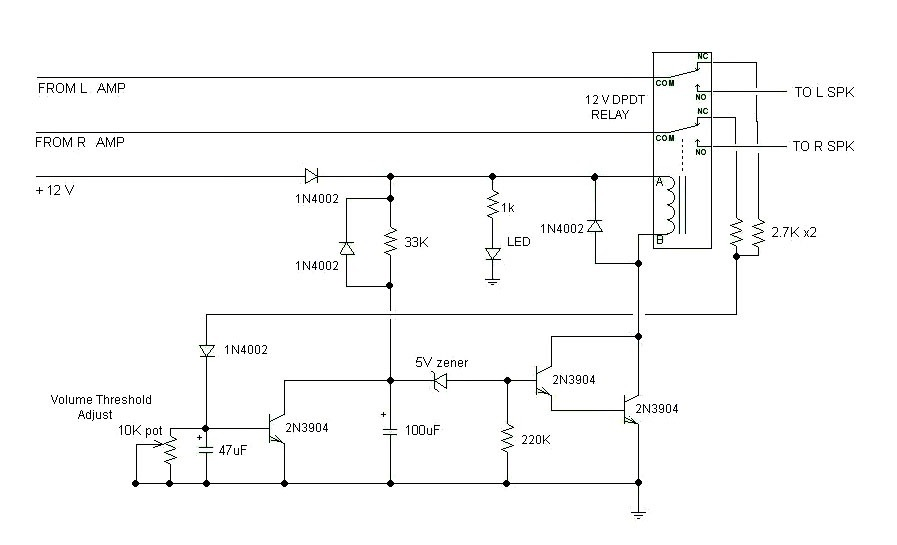

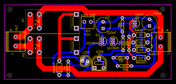

Hy, can your share the PCB layout? Thank's in advance.I made a simple delay/protection circuit that works well.
Senses DC or loud volume levels, and keeps the relay open.
Turn down the volume to a reasonable level...... relay kicks in.... music!

I built the circuit on a perfboard, it's quite simple to do.Hy, can your share the PCB layout? Thank's in advance.
Koda...The 2k7 resistors should go to COM, not NC, otherwise when the protection kicks in it will lose it's input and turn on again.
I wired it that way on purpose.
In case a child plays with the volume control, and you don't notice it when turning the amp on.
On power up, if it senses if DC or a loud volume level, it prevents connecting the speakers.
If volume is at a reasonable level (adjusted by the pot) then the relay closes, (after 5 second delay) and removes volume sensing, and allows normal operation even full volume.
So if you turn on the amp with no relay action going on, simply lower the volume momentarily.
And yes, this is designed for cap-coupled outputs, single-supply, and transformer/tube amps.
And for those cap-coupled amps, it eliminates the POP noise when they charge to the half/v state.
So it's latching? Because it looks like as soon as it turns on the speakers, it can't detect input voltages anymore unless I'm missing something.

Basically, yes.So it's latching? Because it looks like as soon as it turns on the speakers, it can't detect input voltages anymore unless I'm missing something.
If it senses an issue before the relay kicks in, it simply won't trigger it.
The DC voltage across the 47uF cap must be zero to allow the 100uF to charge during the delay.

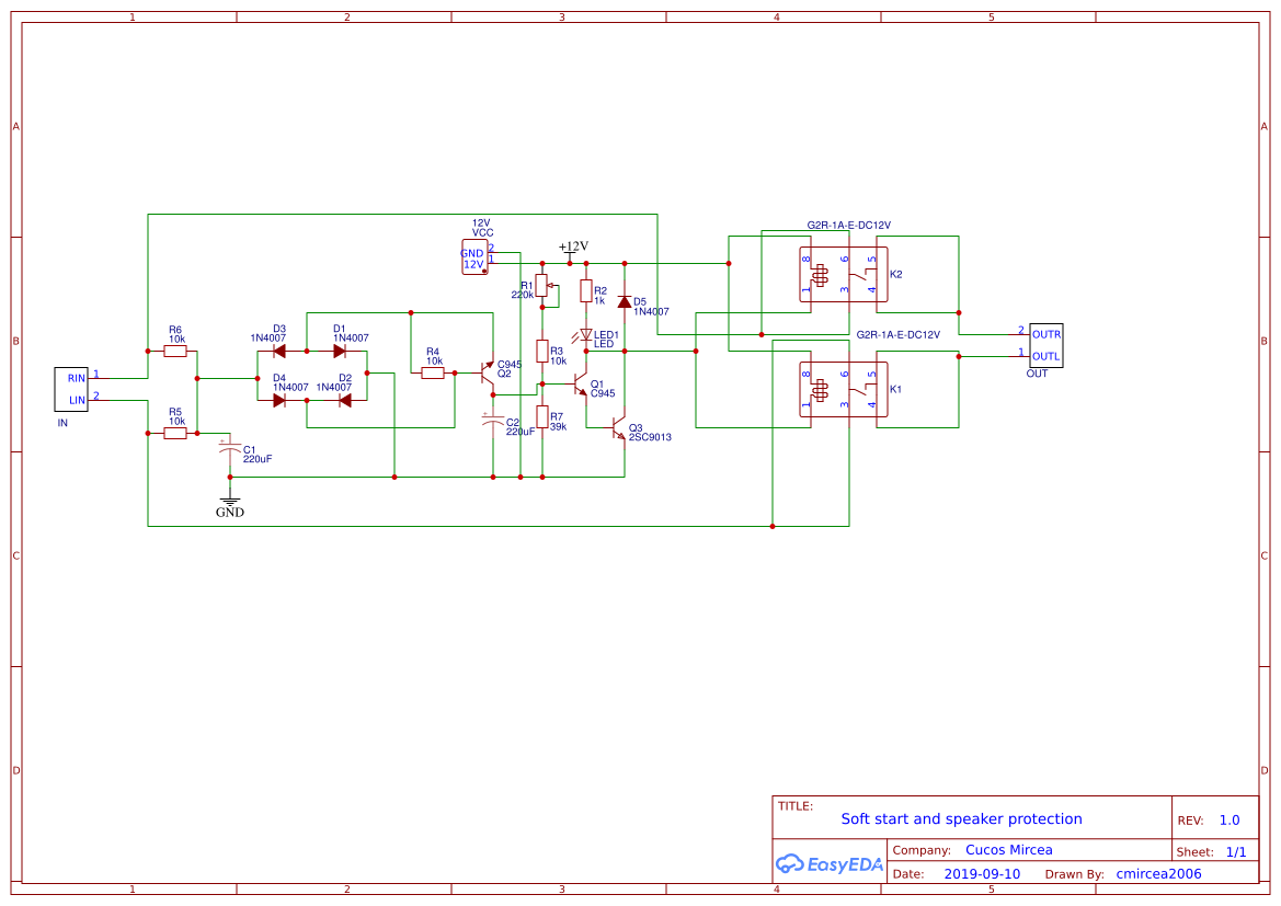

Here's an open source speaker protection board on Open Source Hardware Lab.
https://oshwlab.com/cmircea2006/soft-start-and-spacker-protection

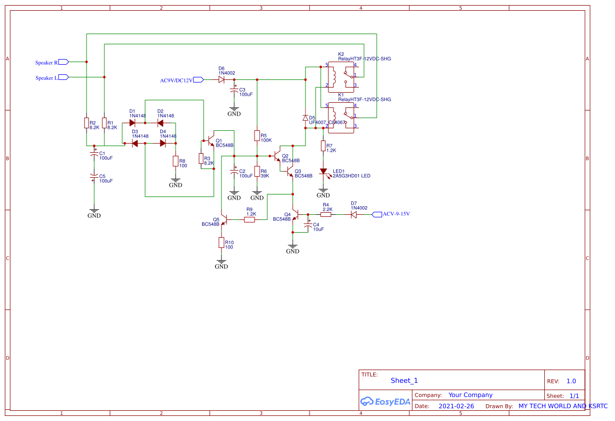

No it makes no sense to do so for line level applications but what line level application should endure 20A? That is heavy muting 😉
BTW the relays are 16A rated.
- Simple protection with relay for amplifier up to 100W
