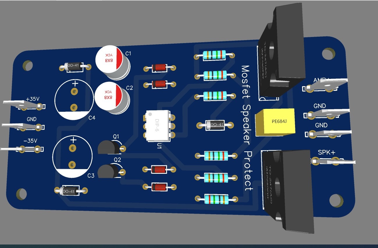

Relays with MOSFETS?! Avoiding poor quality parts is not that hard, just choose quality parts. No worries at all. It is old fashioned but using semiconductors for switching has not brought me much satisfaction. Even source switching with special ICs is worse sounding than relays.
OK, so I'll stick with the classic relay and try to choose some good quality...Relays with MOSFETS?! Avoiding poor quality parts is not that hard, just choose quality parts. No worries at all. It is old fashioned but using semiconductors for switching has not brought me much satisfaction. Even source switching with special ICs is worse sounding than relays.

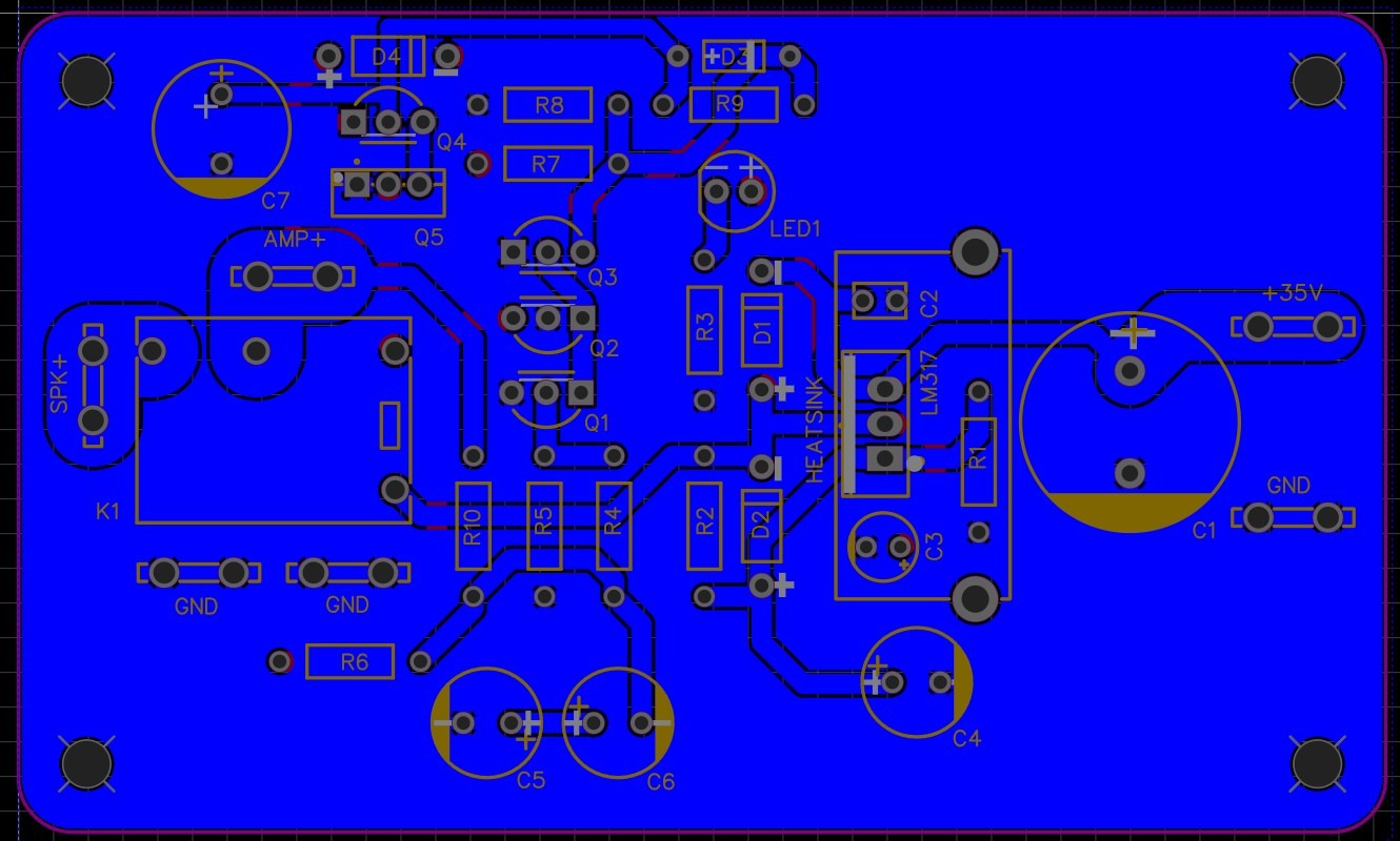

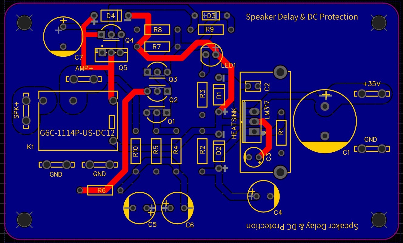

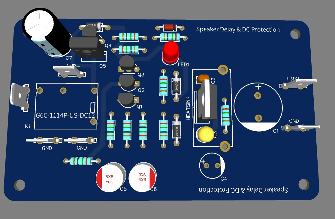

Friends, I finally chose this type: G6C-1114P-US-DC12, looks good quality 🙂
@Fully sealed, contact material: Silver Alloy (Ag), Price: 8,27 €
So if there are no objections, I will modify the board for this type of relay tomorrow.

Can switch up to 125 V DC as long as the product of the DC voltage and the DC current doesn't exceed 300 W and it has a specified minimum load of 10 mA, 5 V. Sounds like a good choice.Friends, I finally chose this type: G6C-1114P-US-DC12, looks good quality 🙂

- Simple protection with relay for amplifier up to 100W
