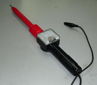

Off topic: I once built an amplifier that could produce 2 kV peak differential output voltage to directly drive an electrostatic loudspeaker made by a then colleague of mine. The supply voltage was 2.66 kV and the supply's short circuit current was well above what is needed to kill someone, making it by far the most dangerous circuit I ever built.
It sounded very good (in an informal uncontrolled test), but as soon as you turned up the volume a bit higher than for background music, the clipping LED would start blinking...
Then familiar tools like these should be used in a home environment to be able to work safely. Insane. Never got used to those ESL's, many of those I heard were arcing when the weather was moist. Cats did not seem to like them either 🙂
https://www.horstmanngmbh.com/fileadmin/products/Earthing_and_short-circuiting_devices.pdf
