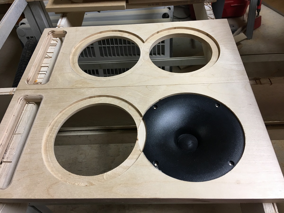

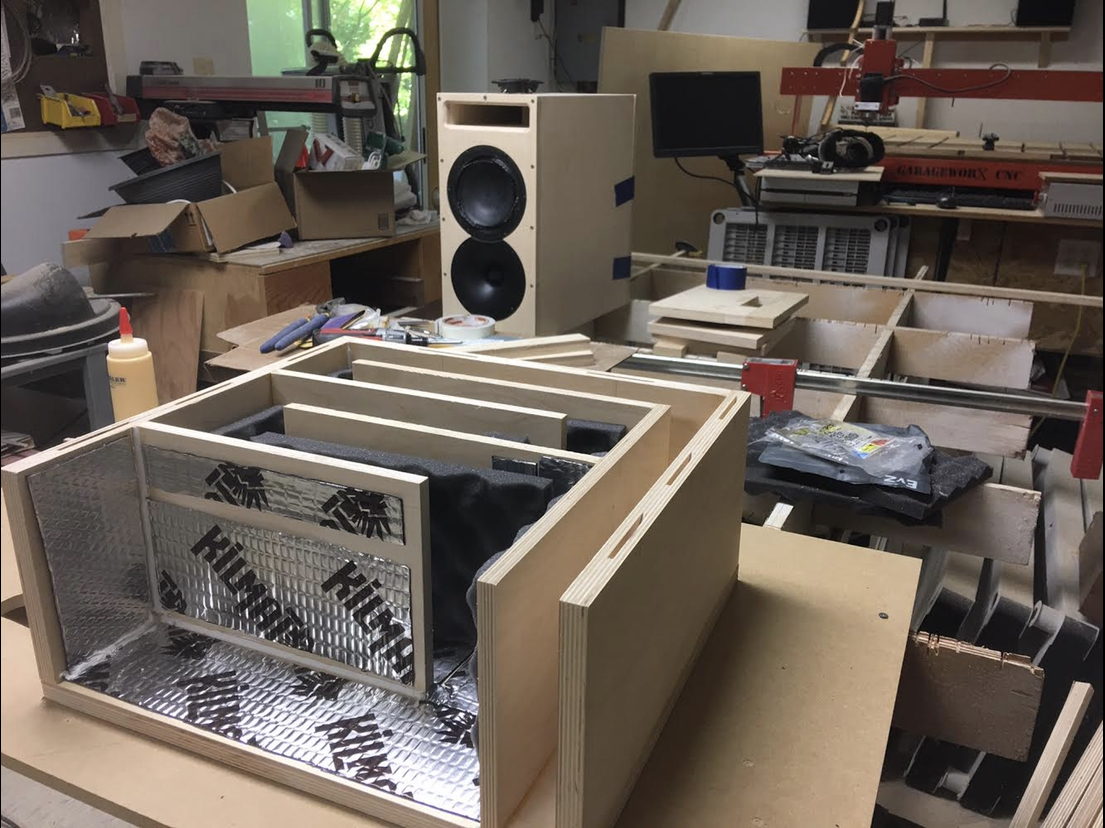

Yes, Friday evening I should have 1st sound. Some weather stripping gasket material will have to be applied on the rebate for the waveguide to make sure it’s air tight. Mount and connect the crossovers. Install the drivers. Install some fiberglass stuffing in the main rear chamber. I am also excited about the ability to swap baffles and listen to this speaker with a RAAL 70-20xr. Truly high end tweeter and woofer on a TL. I wonder what the crossover is going to end up as for the RAAL version.

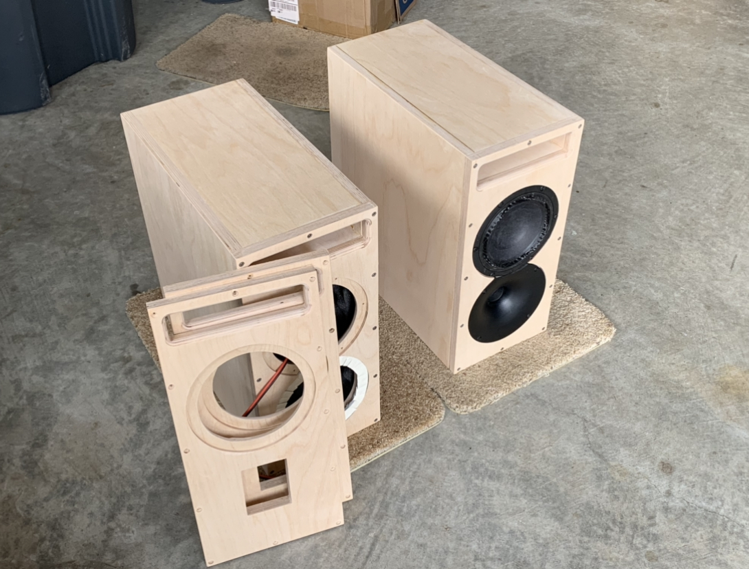

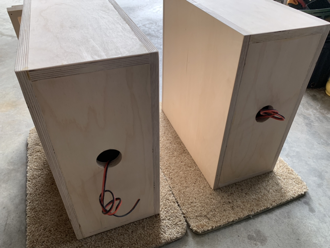

TL’s Delivered

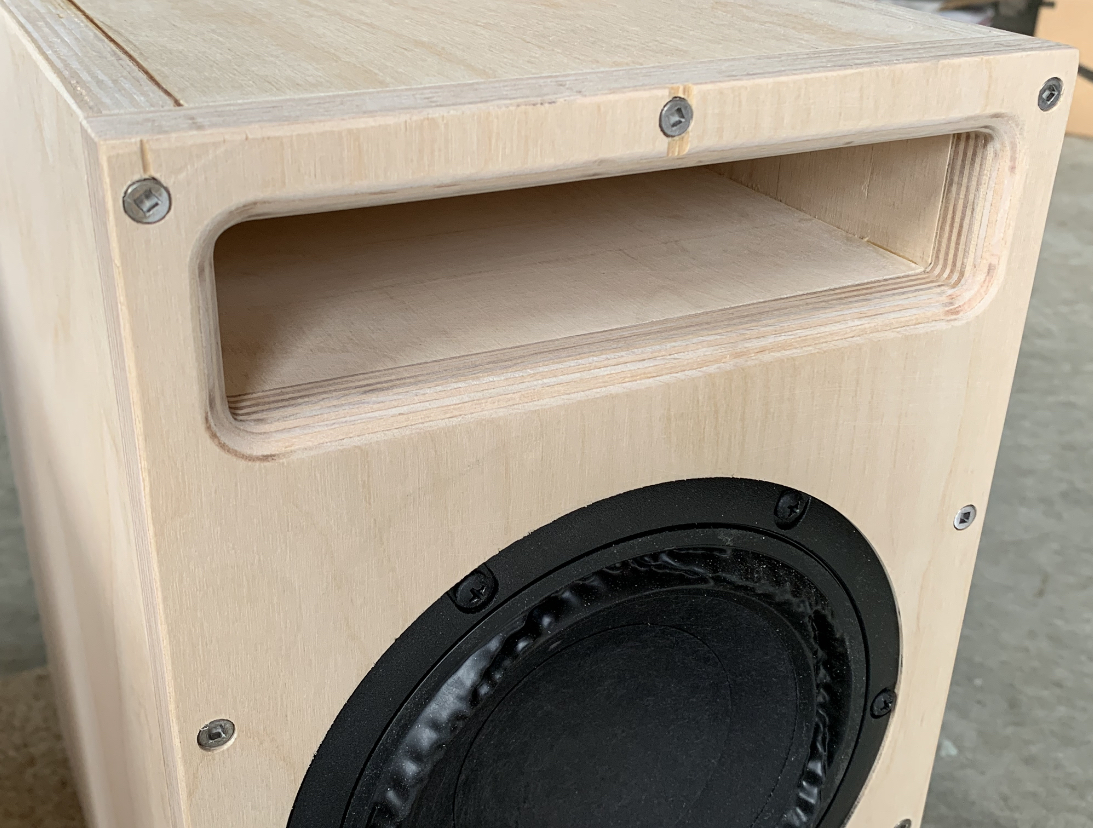

I just got the TL’s and they look great! Not too heavy nor bulky. Very easy to pick up and move about. Almost small enough to be a “bookshelf” speaker.

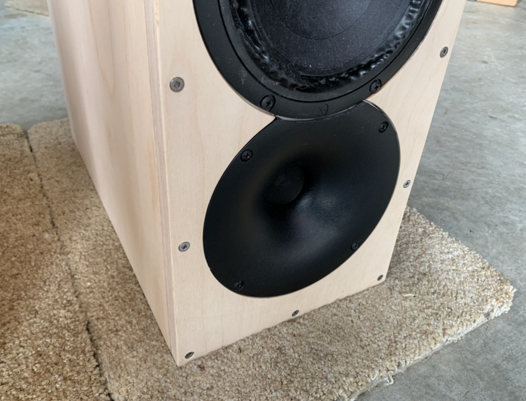

Is it possibel to mount the tweeter above the Purifi instead?
Switch position of them.
Yes, just put the speaker upside down... 😛

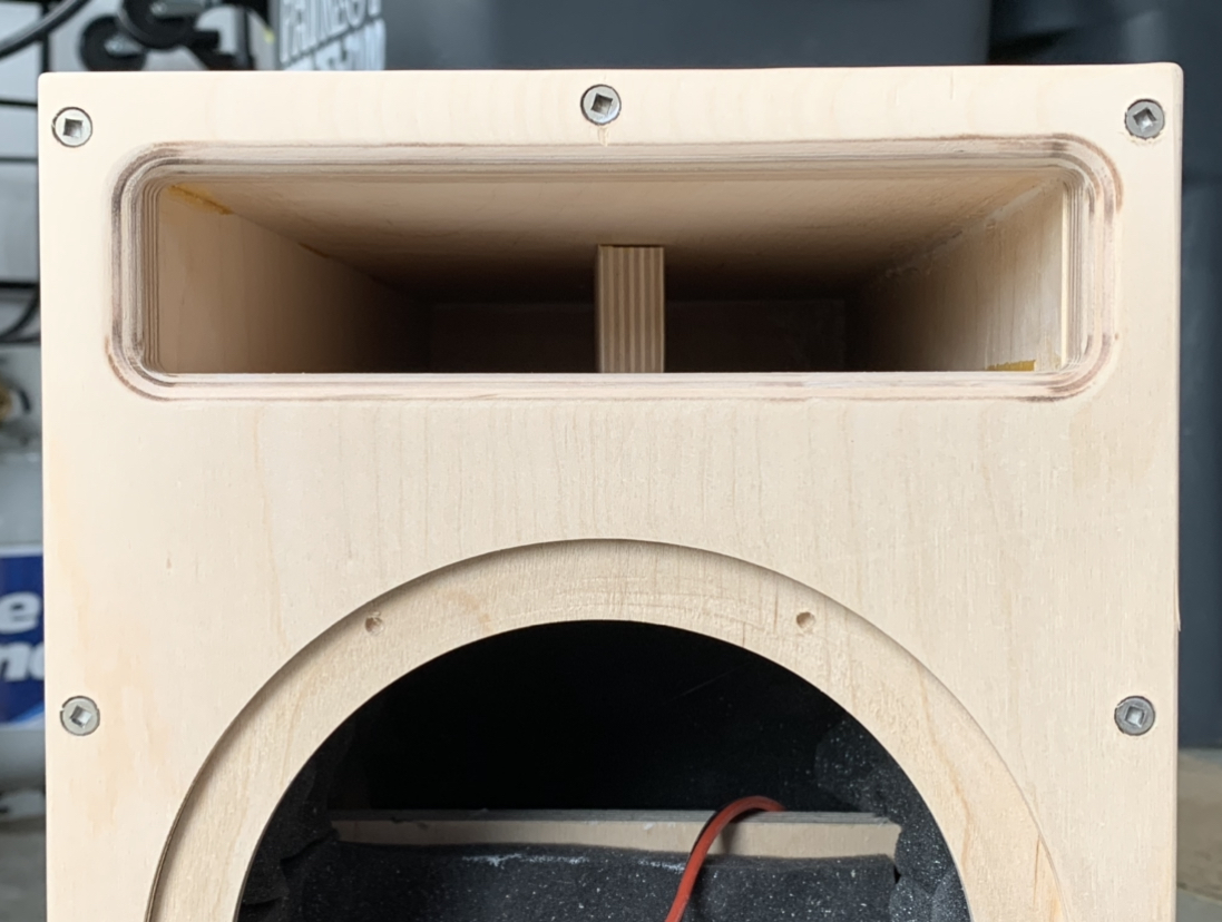

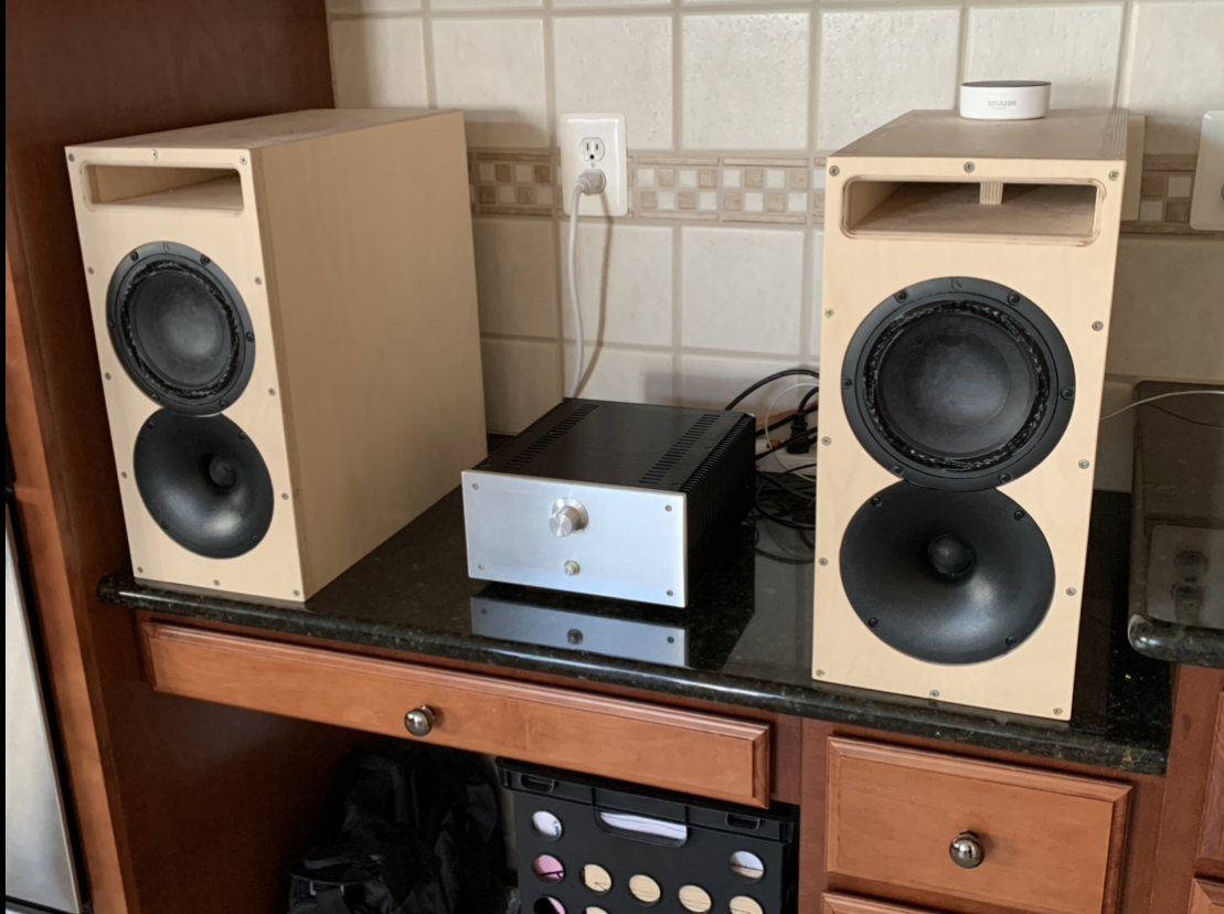

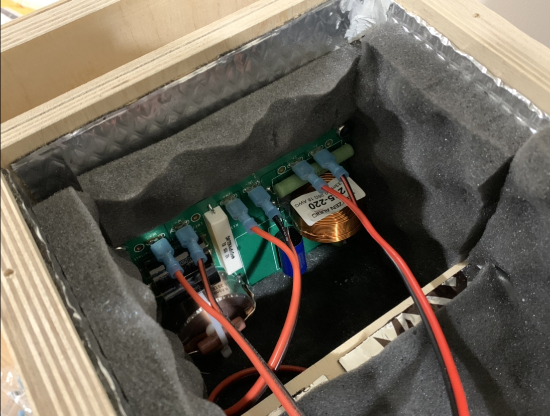

The new TL’s are assembled and currently playing music in the kitchen for some casual listening. The crossover boards ended up on the bottom side of the divider vent wall just as I imagined. The rest of the assembly went smoothly and I used a closed cell foam weather stripping gasket material to make the front baffle air tight.
The speaker has a very wide 3D holographic soundstage with a huge sweet spot. I like how natural it sounds and percussion is on the mark. The relatively flat phase of the Harsch XO combined with the waveguide in stereo is something new for me - never heard imaging quite like this from a “bookshelf” speaker.
The bass is quite powerful and digs relatively deep (better than the passive radiators) and it really moves air as evidenced by how much it makes a small strip of paper placed over vent opening will buzz and flap when the music has bass.
I will listen for a week or so before giving a full assessment and measurements. So far it’s showing very good potential. It can play very loud and still sound clean. I think the TL really opened up the midbass and lowered the overall distortion of the speaker according to my ears.
