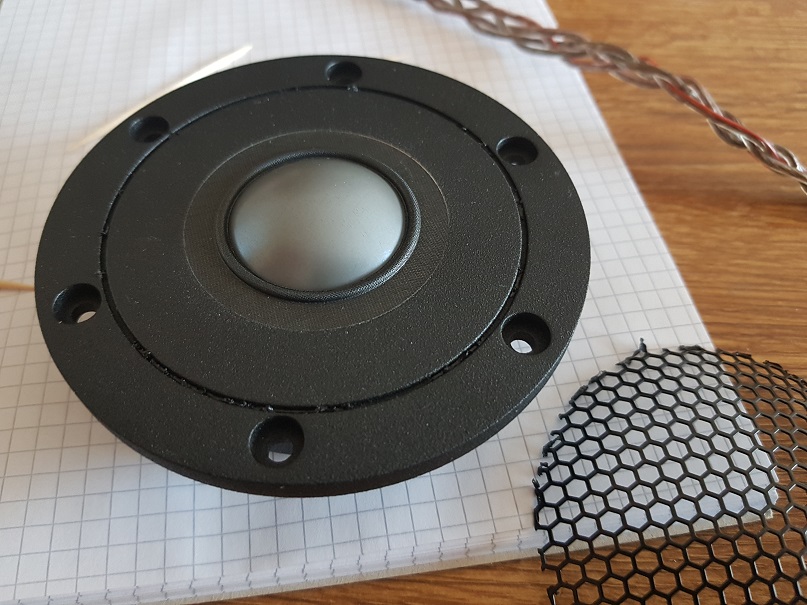

Hmm... Might just have to look into waveguides for the t34a I've got here first.
You may need to design a custom WG and get it 3d printed - unless the size of the mesh basket on the Bliesema T34A is standard diameter. The WG300 for example is 40mm dia throat.
I would guess the jantzen waveguide made for the TW034 tweeter (which funnily enough I also have a pair of in my JBL SVA2100's) can fit the T34A, but no way I'm paying that price to find out. 3D printing looks like my only option
The Jantzen WG for TW034 tweeter is 48 euro each - seems reasonable price if it fits. You will spend at least 15 Euro to print one, after you design it. The Jantzen one is machined hard plastic vs 3d printed so might sound better.

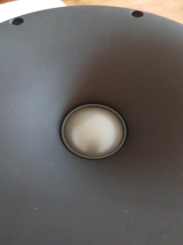

What is the diameter of the T34A mesh basket?
The grill comes off pretty easily. Nice flush surface to work with.

WG300 is 40mm throat so seems perfect for T34A. I guess the grill is much bigger than the dome.
I was lucky enough to have a friend in EU give them to me as a gift. They were designed for the DT300 tweeter which might be pretty good. You could save yourself the trouble of making an adapter if it fits. Priced well at 50Euro too.

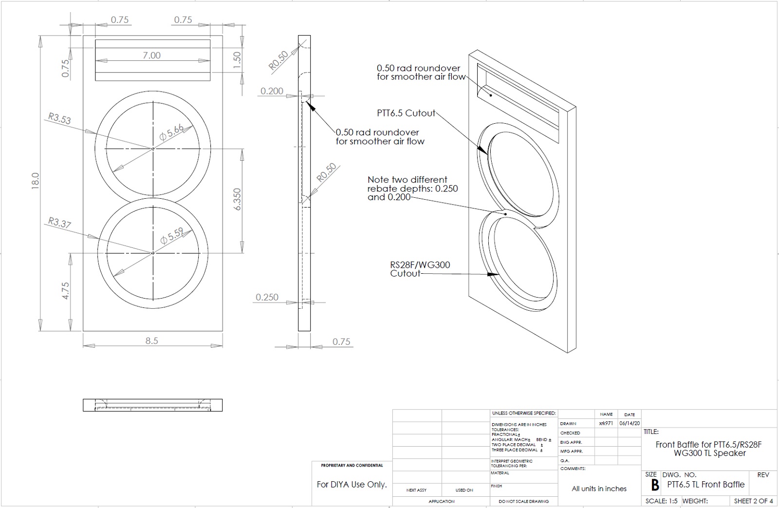

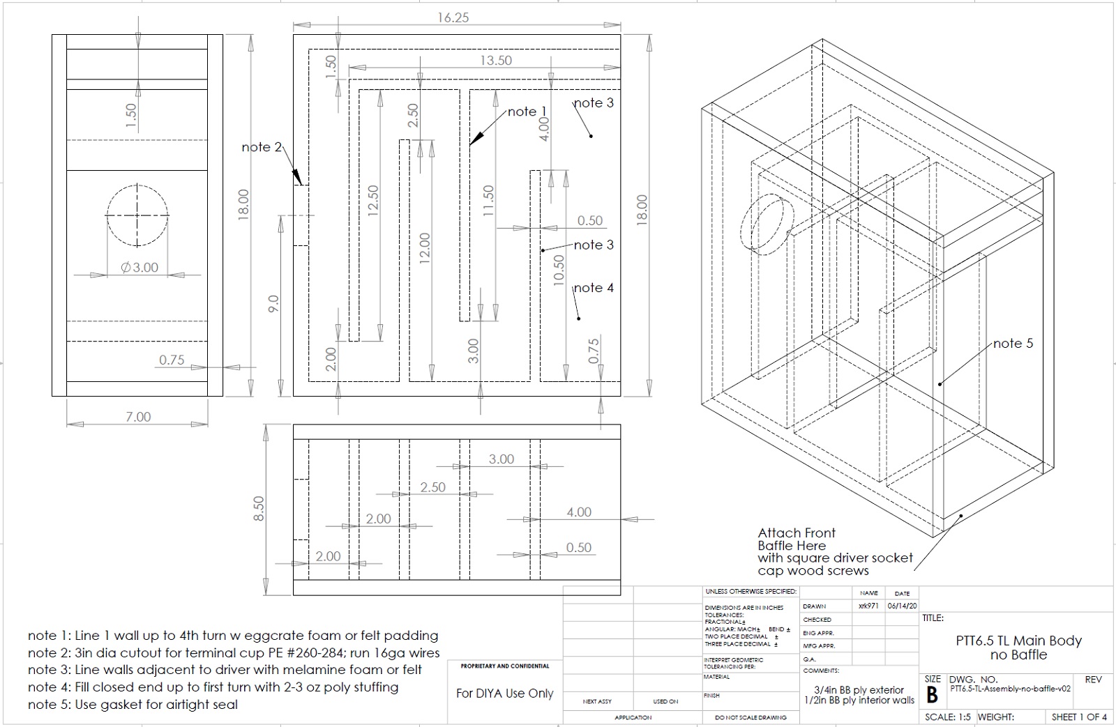

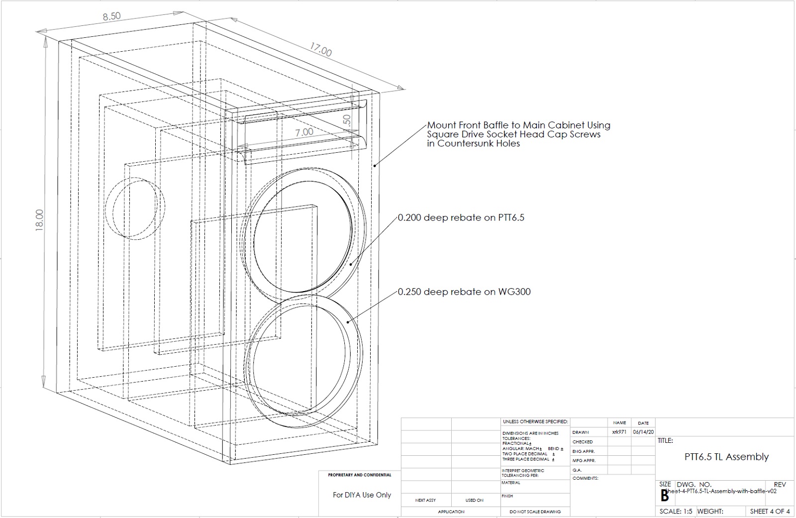

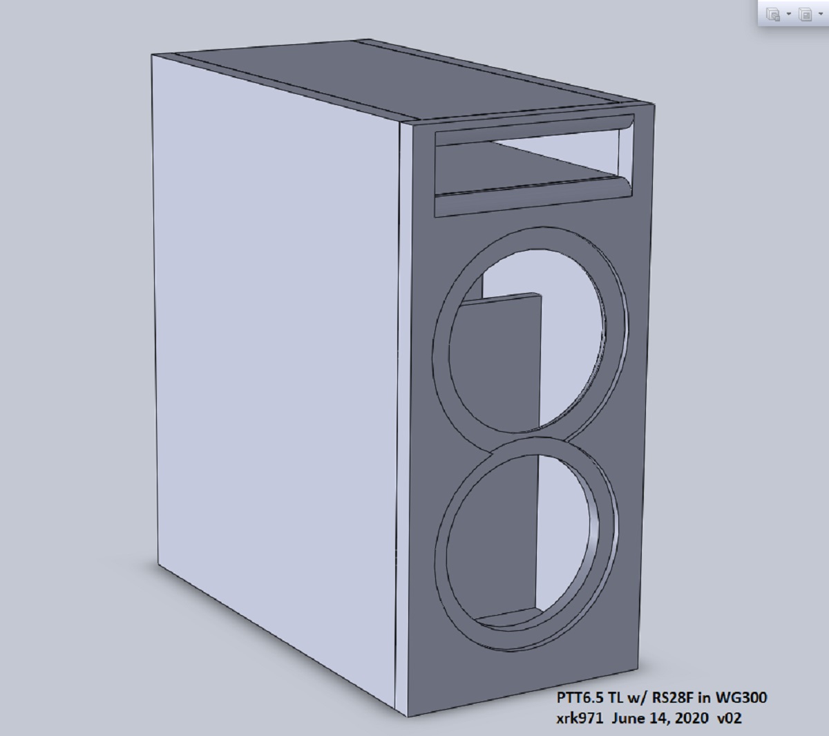

Revised Plans for TL with Corrected Baffle Cutouts
Updated drawings for the TL with a removable baffle. I re-measured the driver cutout diamters, depths and CTC spacing. The previous drawing is incorrect for the baffle cutouts, please use these drawings. Drawings are available in PDF and JPG below.

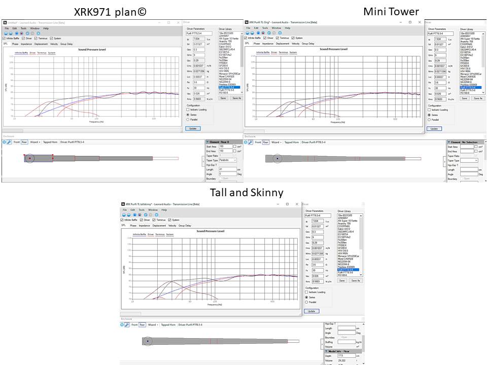

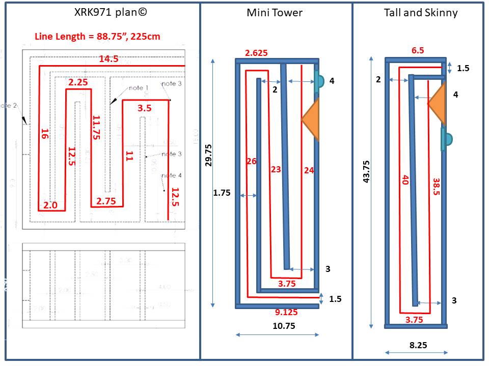

I have been having a play with the Leonard TL calculator and would appreciate opinions on the mini tower and tall&skinny tower TLs that I have (very badly) sketched up and modeled. Both attempt to keep the same line length as XRK's (calculated at 88.75", correct ?) but in different form factors. I prefer the tall&skinny but thought welcome. The models come out pretty similar (I think the T&S has slightly better response but this is in the rounding of the measurements so not significant).
