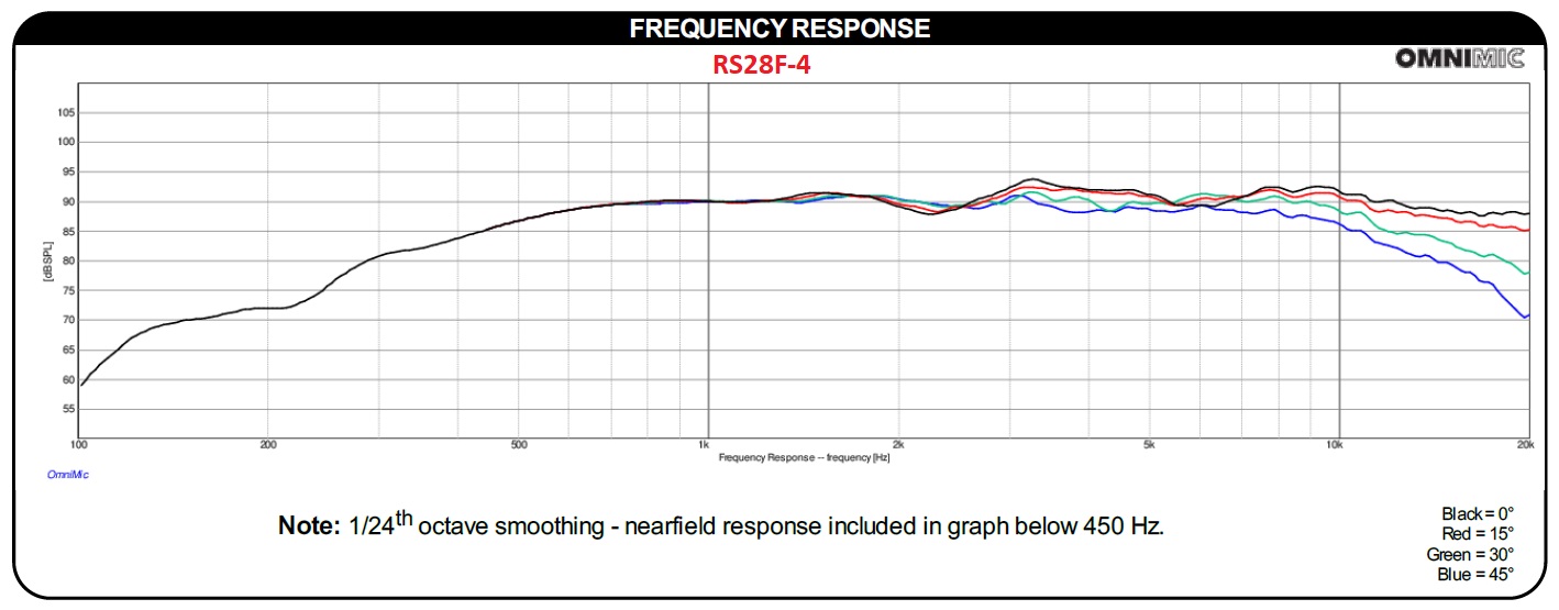

Here are the polar measurements (technically not on a "polar plot") - these are half angles, so included cone angle is 2x, or 60deg is the green line:
Compared to a bare RS28F-4 as measured by Dayton:

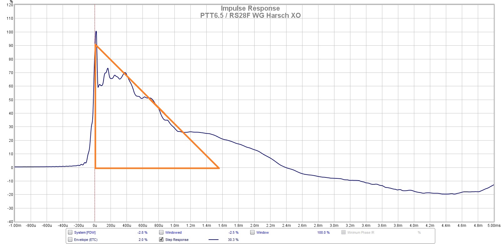

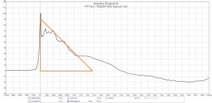

Yes, more like 30-60-90 though and not 45-45-90.

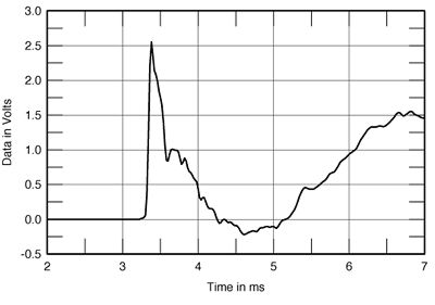

You can read about how many commercial speakers J.A. of Stereophile has measured that has has a right triangle response here:
Dunlavy Audio Laboratories SC-IV loudspeaker Measurements | Stereophile.com
SC-IV:
Quad ESL-63:
Here is one of my other speakers that does this - 10F/RS225 FAST:

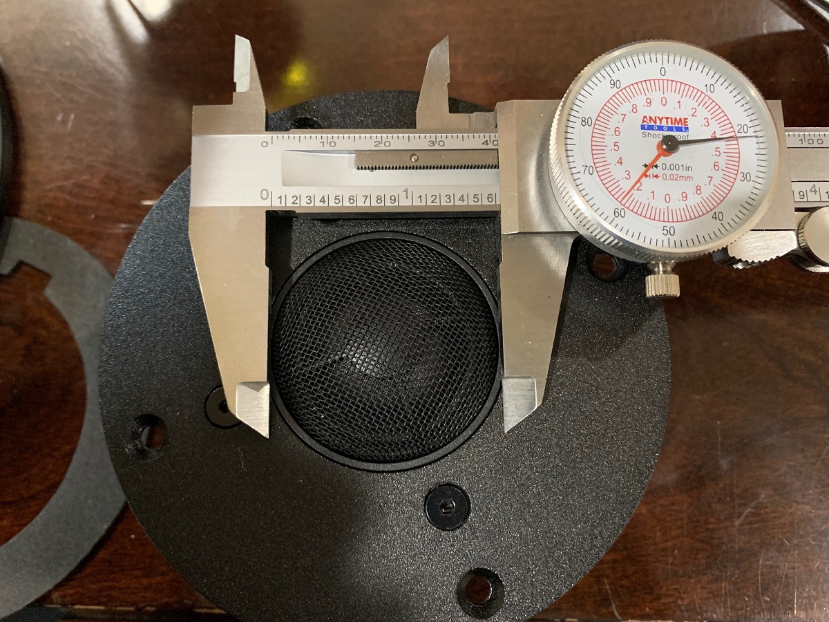

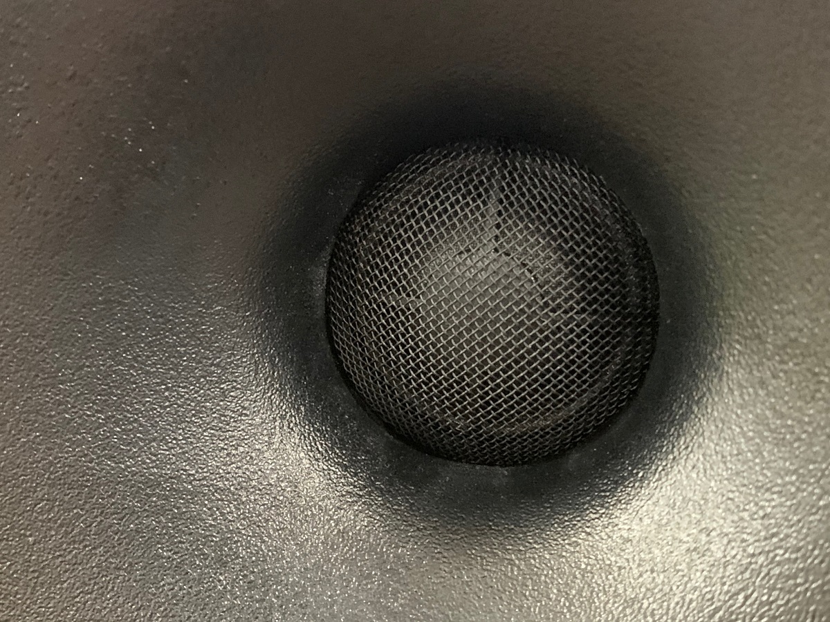

I received the new RST28F-4 tweeters the other day. They are a drop in fit as far as the flange and bolt pattern are concerned. However, the protective wire mesh grille (not removable) is 41.6mm dia vs the RS28F is 40.0mm dia and the WG300 aperture is exactly 40.0mm dia. As a result, the WG sits about 1mm above the dome with a small gap. I added a felt spacer to cover this gap and used the foam spacer provided from the RS28F in addition. The RST28F already has a foam gasket, but it is glued to the back for traditional front mounted on flat baffle appication.
Here is the dia of the RST28F grille:

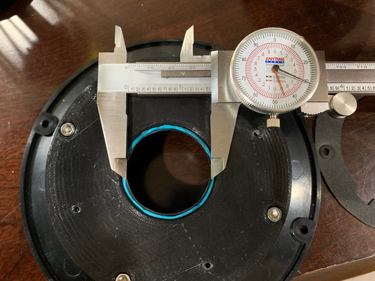

Here is the dia of the WG300 aperture (blue putty is sealant between adapter spacer ring and WG - needs to be airtight so woofer doesn't pressurize the tweeter dome front):

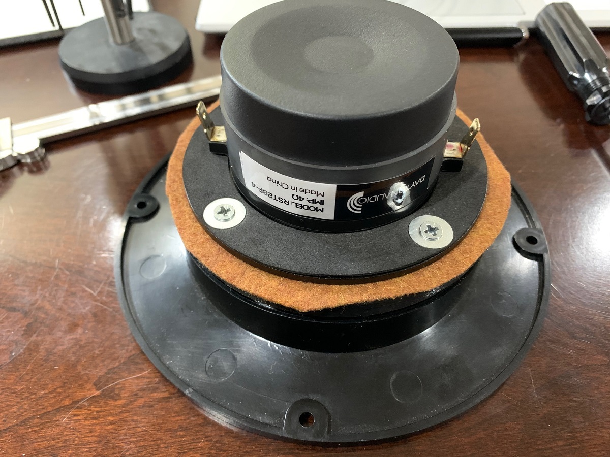

Here is the felt spacer used to close the gap:

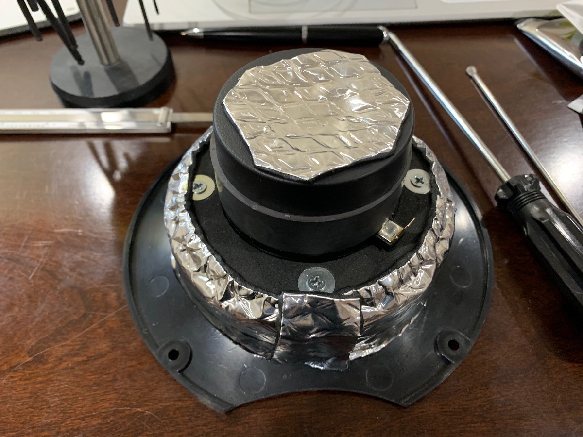

I added Noico mass loaded butyl autosound dampening sheets to absorb any vibrations in the plastic WG or 3D printed adapter:
Here is a closeup of the front of the WG300 with the ne RST28F installed:
The rest of the installation went smoothly. For what it is worth - the RST28F is a handsome and well made quality looking tweeter with a solid aluminum faceplate (not plastic), a heavy magnet, and shaped rear acoustic chamber, and a nice metal grille protector. In taking it apart to see if the grille was removable, I discovered that the diaphragm and grille and voice coil are replaceable and there is ferrofluid in the voic coil gap. Not bad for a $38 tweeter.

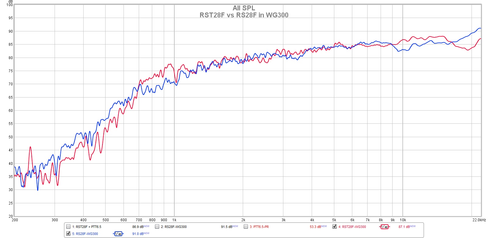

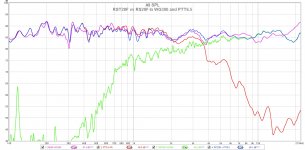

So how does it measure compared to the RS28F that it replaced?

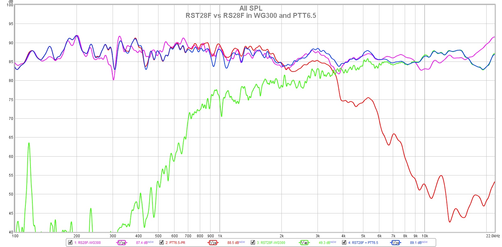

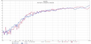

Here are the measurements of the RST28F in the WG300 at 2.00Vrms and 0.5m with the same XO shown earlier. They are very similar, but RS28F seems to have a rising reach at 20kHz whereas the RST28F is falling at 15kHz. Overalll match is acceptable as you will see in the following step response:
Here is the comparision of the performance when used with the PTT6.5 woofer and same crossover - there is probably a bit smoother response in some ranges and a bit more presence at 10kHz to 12kHz. A little less "air" at the top register and this could be the result of the non ideal waveguide fit. The magenta curve is the RS28F combined data, the blue curve is the RST28F combined data:

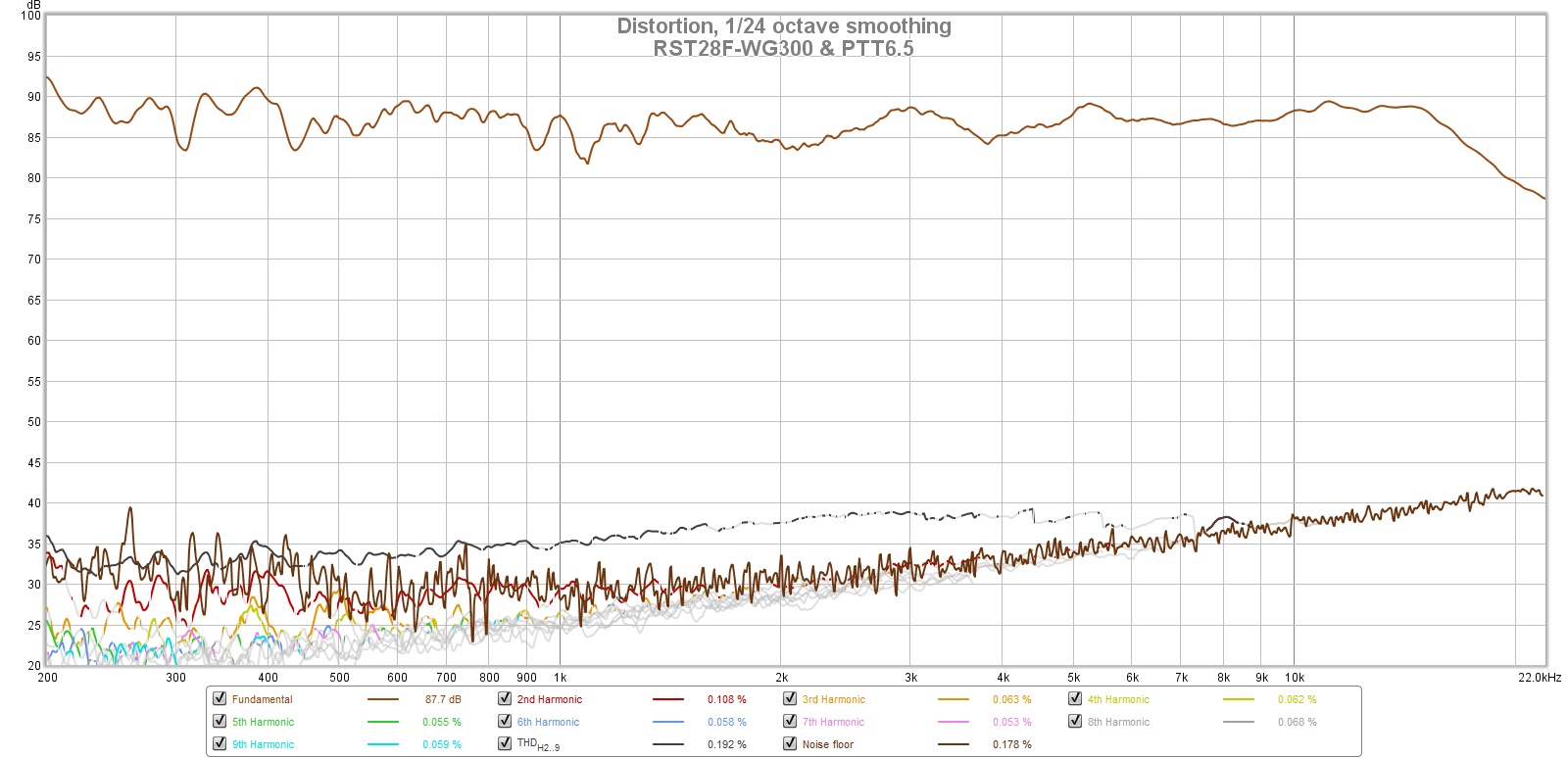

The measured distortion levels are similar for both but it is puzzling that the the fundamental for the RST28F appears to be falling at 15kHz, and is quite a bit lower at 20kHz, but this is not apparent in the total SPL data in previous graph:

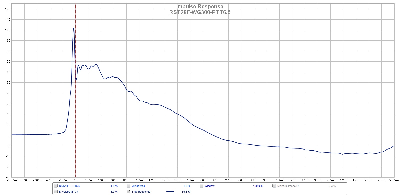

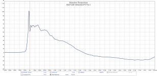

Here is the measured step response of the RST28F in the WG300 and PTT6.5 - very nice actually:
I am listening to it now and it sounds very good - near identical to the RS28F that it replaced. No adjustments to the XO needed. Some people who can hear above 15kHz may miss the few dB loss, I can't really hear that high so not an issue for me. So I think the conclusion is that the RST28F is a suitable replacement for the RS28F for this speaker design. This is good because finding RS28F's in the wild is sort of like looking for a unicorn.

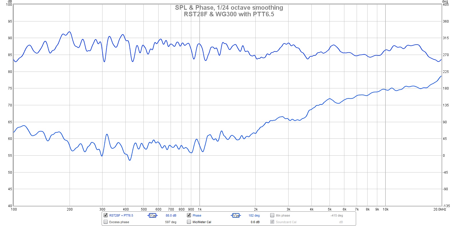

I am looking at the data a little more carefully from the RST28 and WG300. Despite having a very good step response, the phase measurement appears to just rise and not have a 55deg bump like a true Harsch XO. Whether or not this makes an audible difference vs the RS28F, I am not sure. I do want to let folks know about this and so they can choose their tweeter accordingly. The RS28F will measure better according to my data.
Here is measured phase for the RST28F-4 in the WG300 integrated with the PTT6.5:
