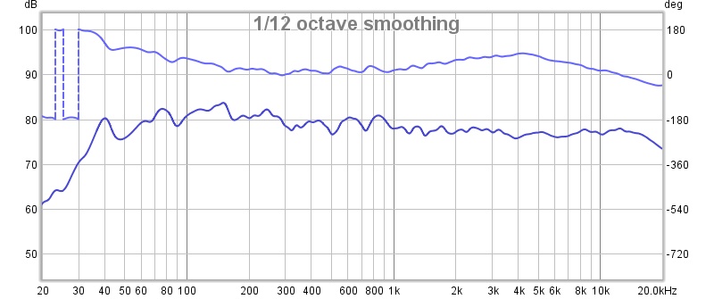

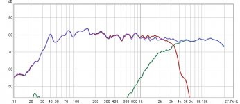

Ive been constantly messing with different XO's (LR, BW, combos, low cross, high crosses) with the MiniDSP and the purifi woofer and sb dome tweeter for weeks. Each one I have tried I've been just O.K. with. When I first saw your XO proposal I though nah that doesnt look good but I'll give it a shot anyway since the miniDSP is so easy.
Boy was I wrong. This is honestly the first crossover with this setup where I've gone "aahhh now this is right". Well not completely. The one I posted earlier was a "hmm, this sounds WAY better (that what i've done so far)" - but something was off. Felt like some of the mids were a little muffled. I wasn't sure what/why, but I suspected the cross was a pinch too high. I had the cross set at 3.2K but acoustically it ended up around 3.6 due to the tweeter level. So this morning I dropped the cross to 2.8K on the DSP and remeasured. Looking good for 3.2 acoustic cross. Now we are cooking with gas. Everything sounds right where it should be. Imaging is the best I've had it. Nothing is lost in the mix. I can hear vocals extremely clearly. Very happy with it! New measurements attached.
Funny how an "unconventional" crossover, for lack of a better word, seems to work so damn well here! I think I can stop messing with the crossover and finish my box design now. 😀 Thank you.

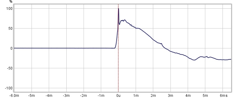

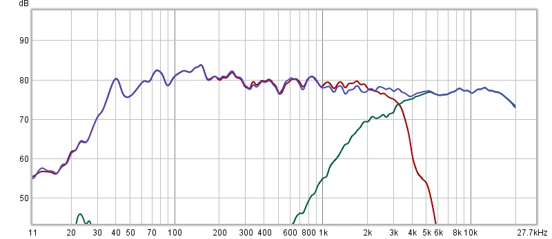

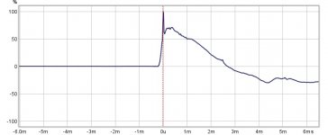

Looks like you nailed the Harsch XO on your miniDSP.
The indicators are: phase is flat with a 55deg wide band bump to the right of XO point; the combined curve is a little less than the woofer curve to the left of thr XO point; finally, the step response looks great as it looks like a right triangle.
Nicely done! How does it sound?

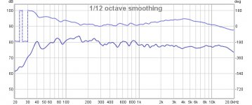

Your measurements look awesome! That’s a textbook Harsch XO. Can you remind me what tweeter you are using? Do you have photos of your setup to share? I have experience a similar thing with XO frequency placement before. Once I had dome tweeter crossed at 2.5k and it sounded dull, I moved it to 2k and it was transformed to greatness. On my particular dome in a waveguide, I don’t have a problem as it seems to be well integrated and the mids from the PTT6.5 are beautiful. I need to keep it where it is in order to take advantage of the 4th order I get naturally by imposing a second order electrical on top of the natural fall off.
This is one of the most well-executed Harsch XO’s I have ever seen in miniDSP:
Your description of the sound is exactly what I also felt after trying many different XO’s on the miniDSP. It sounds right, foot tapping dynamics and imaging. That’s the beauty of transient perfect crossovers. The only other one that’s similar is the first order transient perfect. It needs special smooth wideband drivers.
I think many people say that time alignment or flat phase doesn’t matter - but for me it does. I can hear it, and once you hear it, you can’t go back to wonky looking step response of a LR2 or LR4.

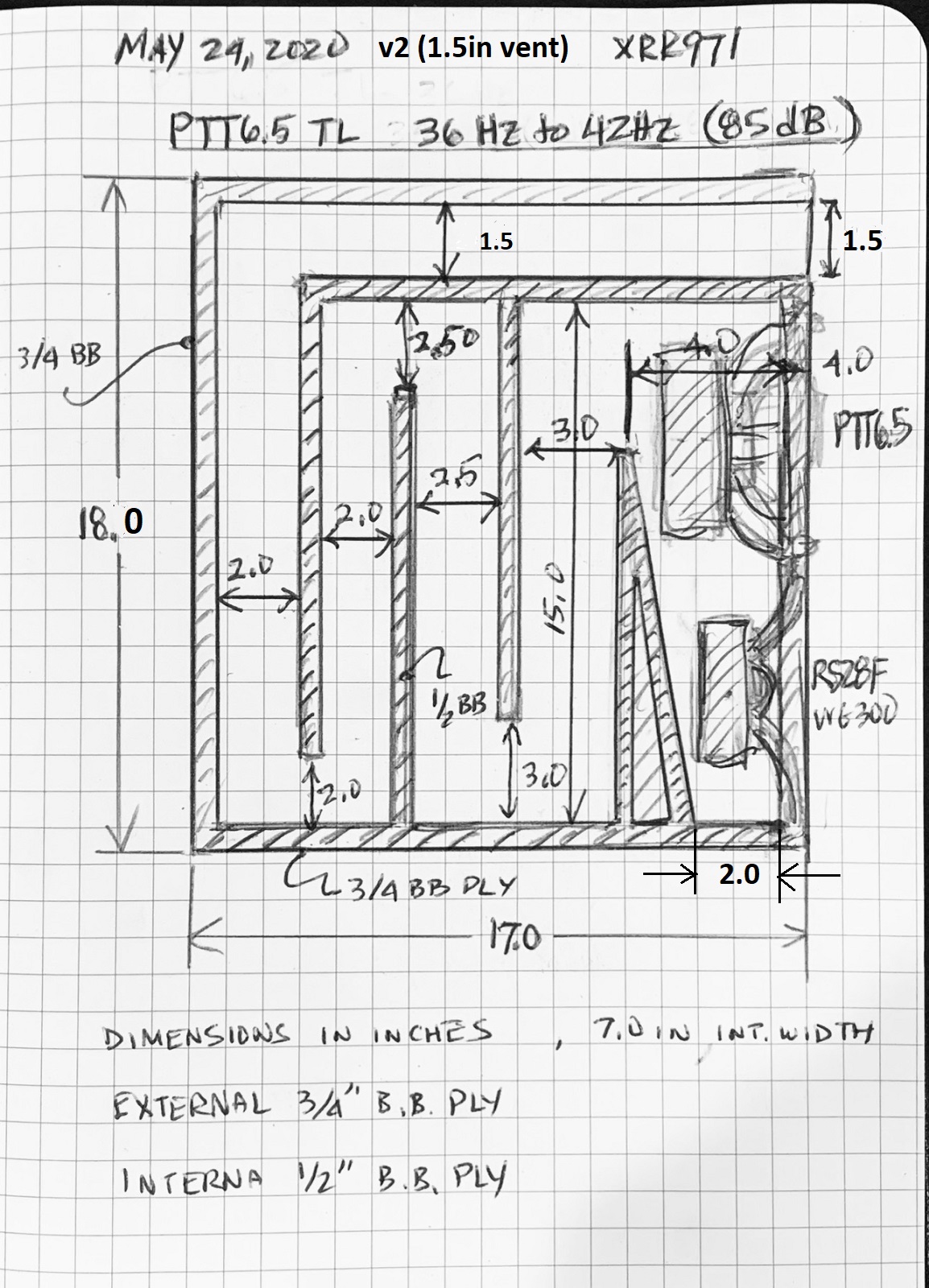

Plans for PTT6.5L and RS28F/WG300 TL

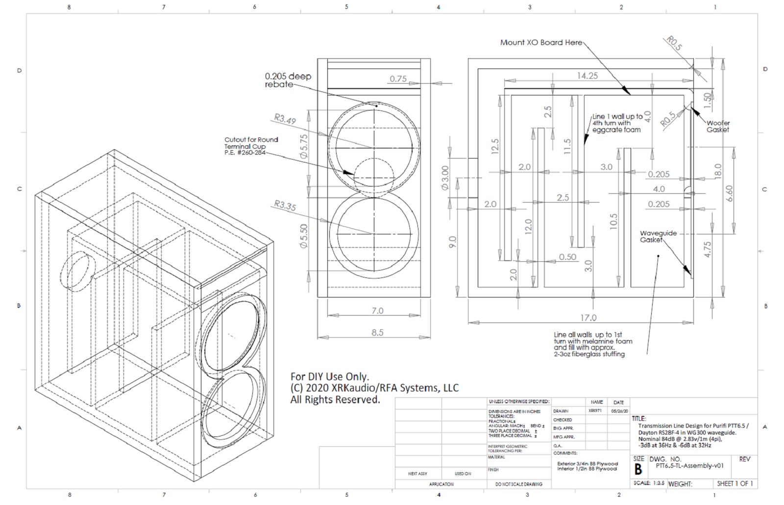

2D Plans for TL (in JPG and PDF). Note that a removable front baffle can be made to allow exchanging tweeters if desired using an 8.5in wide removable baffle attached with countersunk wood screws directly to the side panels. Be sure to use a foam rubber gasket for air tightness.

The PTT6.5 does not do highs as well as a 3.5in midrange. But it’s ability to do mids up to 3.5khz is excellent. The highs above that have to be taken care of by a tweeter, whereas on a FAST, the highs are handled by the full range driver.

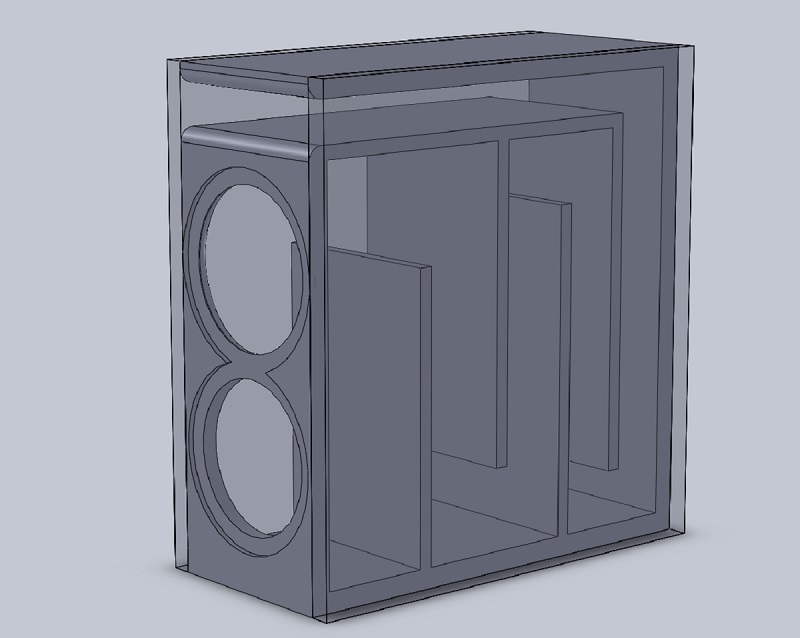

Does the purifi midwoofer do highs as well? how will this design work? that top slot port as an exit for the small transmission line is pretty innovative, never seen that before. I wonder if the satori textreme midwoofer will be competitive with the purifi

ohhh thanks for answering my question. so would this have a tweeter on top like a ess heil amt or dome in it's own little enclosure?
edit: ohhh I'm dumb, I assumed the bottom driver was the dayton 8" woofer you use on your FAST design but I see now it's the purifi and the top driver is a tweeter in a waveguide

Is the slanted disc behind the treble left out (or necessary)?

The angled piece of wood is optional and can be inserted to improve bass SPL by about 1dB if needed. When I designed it, I had not considered mechanical interference with tweeter magnet and rear chamber which extends 3in from baffle front or 2.25into the chamber. The angled wall probably can’t go the full 2into the closed end. Alternatively, a small cutout (sealed) can be used to accommodate the tweeter rear chamber.

In case anyone wants to make this speaker with a removable front baffle (useful for adjusting stuffing or installing angle bass-booster volume filler plate, or XO board. Here is a drawing for just the front baffle. Note that it looks like it is made of a middle part bonded to two 3/4in side pieces (and it is in 3D), but you can make it out of single 3/4in thick piece of wood. You may not wish to put a roundover on the vent exit to leave enough wood for the countersunk screw heads to grip the board at the top. If doing this, all the other dimension from the side for the rest of the speaker are reduced by 0.75in. I actually made a drawing and when I went to save it, SolidWorks crashed and I lost the drawing. Nature's way of telling me it wasn't meant to be posted. 🙂
If you are serious, you can figure it all out I am sure.
