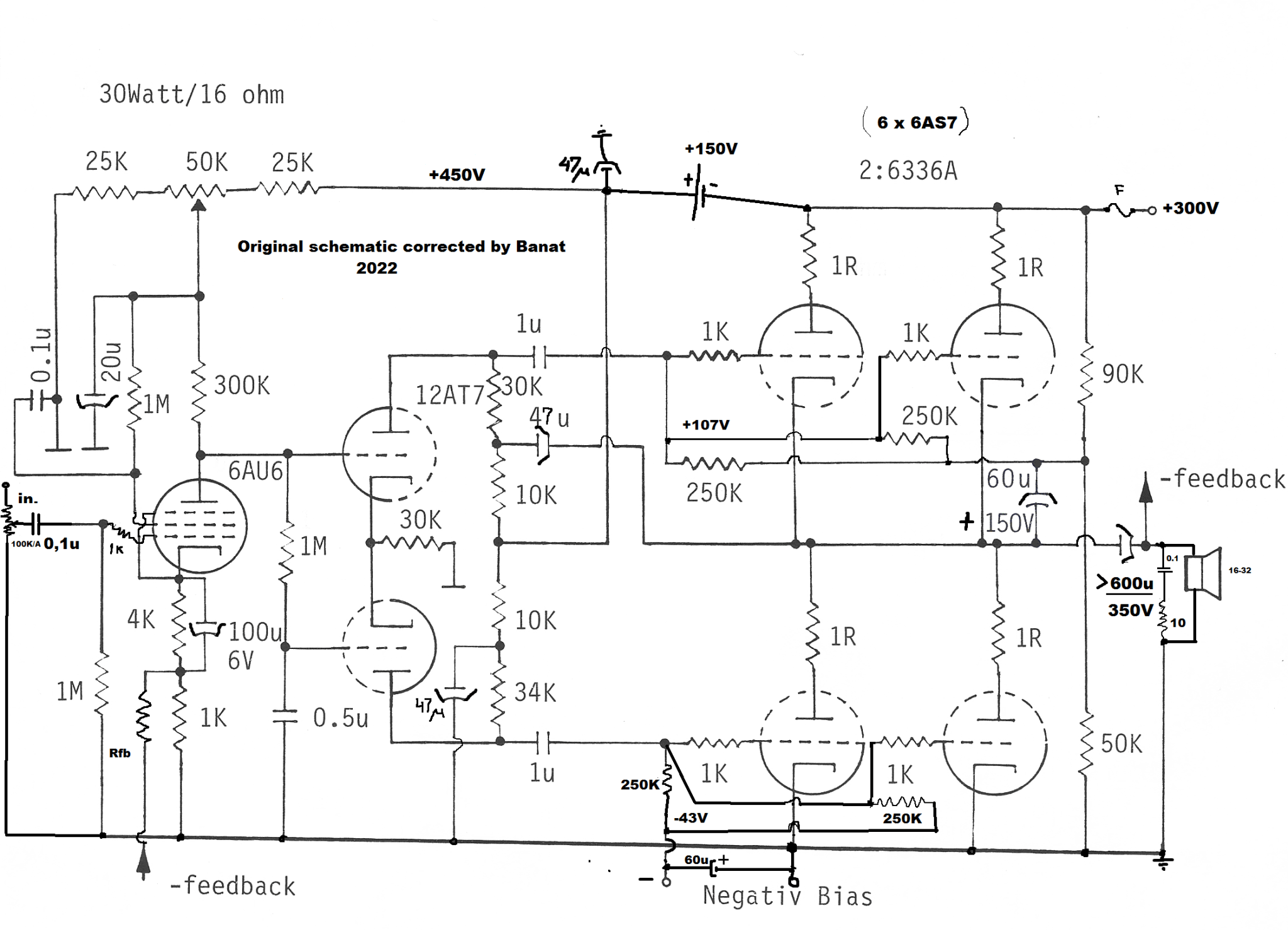

https://www.bonavolta.ch/hobby/en/audio/6336a_1.htm

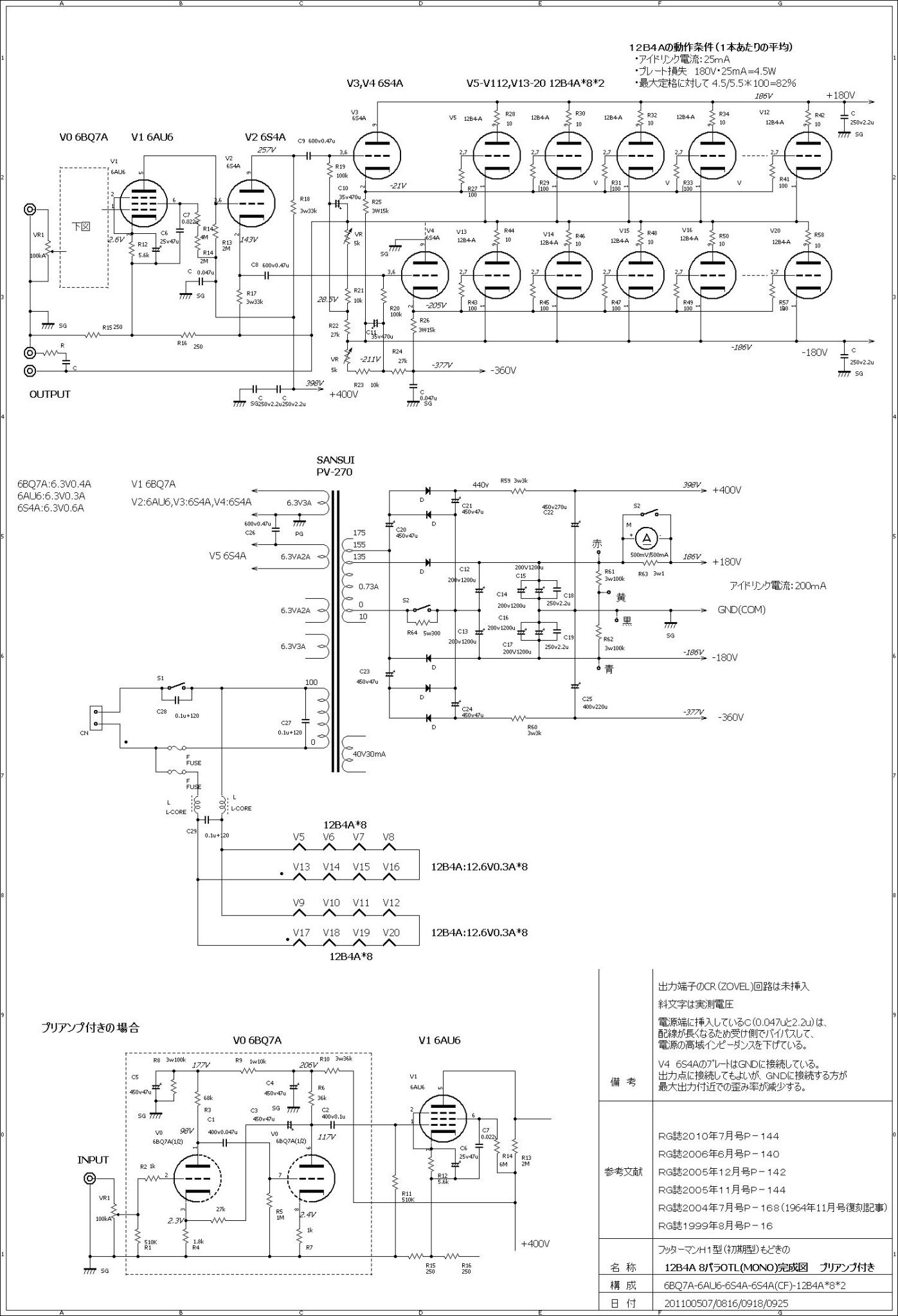

12b4a 6s4a 6au6 6bq7a
That last Sansui OTL schematic: V5 - V112 😳 Are there any 12B4s left?

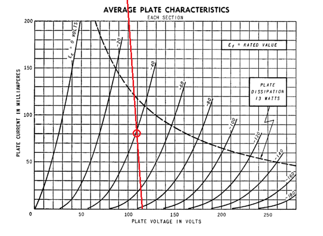

If the 6AS7 can make 1W into 16R, it will make about 5W into 80R. For that, it must swing 20V RMS into 80R, or 60Vpp. So you could have about 5W into 72R by using one tube per channel. 6AS7 is widely available, low cost, uses a common octal socket, no topcap, nice looking, what is not to like? 🙂

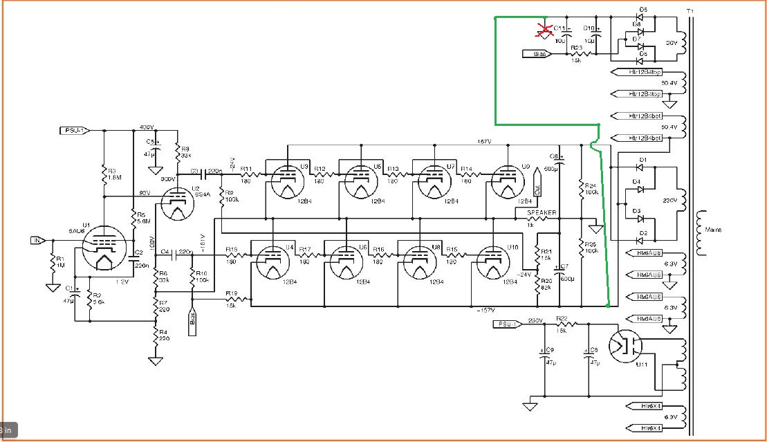

This will have a lot of heat in the resistor, but so much simpler to build and better long term stability.
I'm not sure that 2 quite big caps 3300µF/63V plus a duet of heating resistor is much better about simplicity - and moreover - reliability than a fixed bias operation OTL, in this particular case.
I built those 20W OTL with 4x6080 / 20WRMS fixed bias (below) in 1996, I sold them in the mid-2000 to a friend who still owns them without issue since then, if we except a set of new tubes :
I sold them because... They were heavy and big ! 🙄 But that's nonetheless true, compared to the size of my U-OTL of today !
