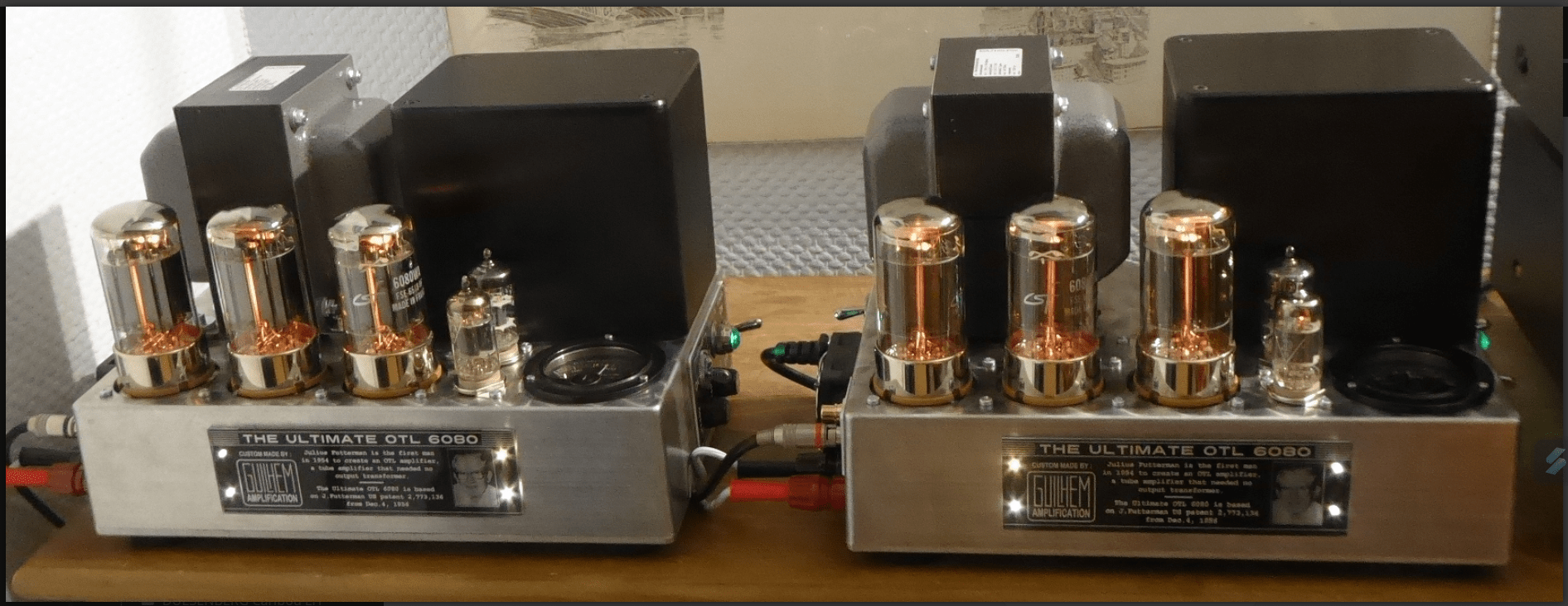

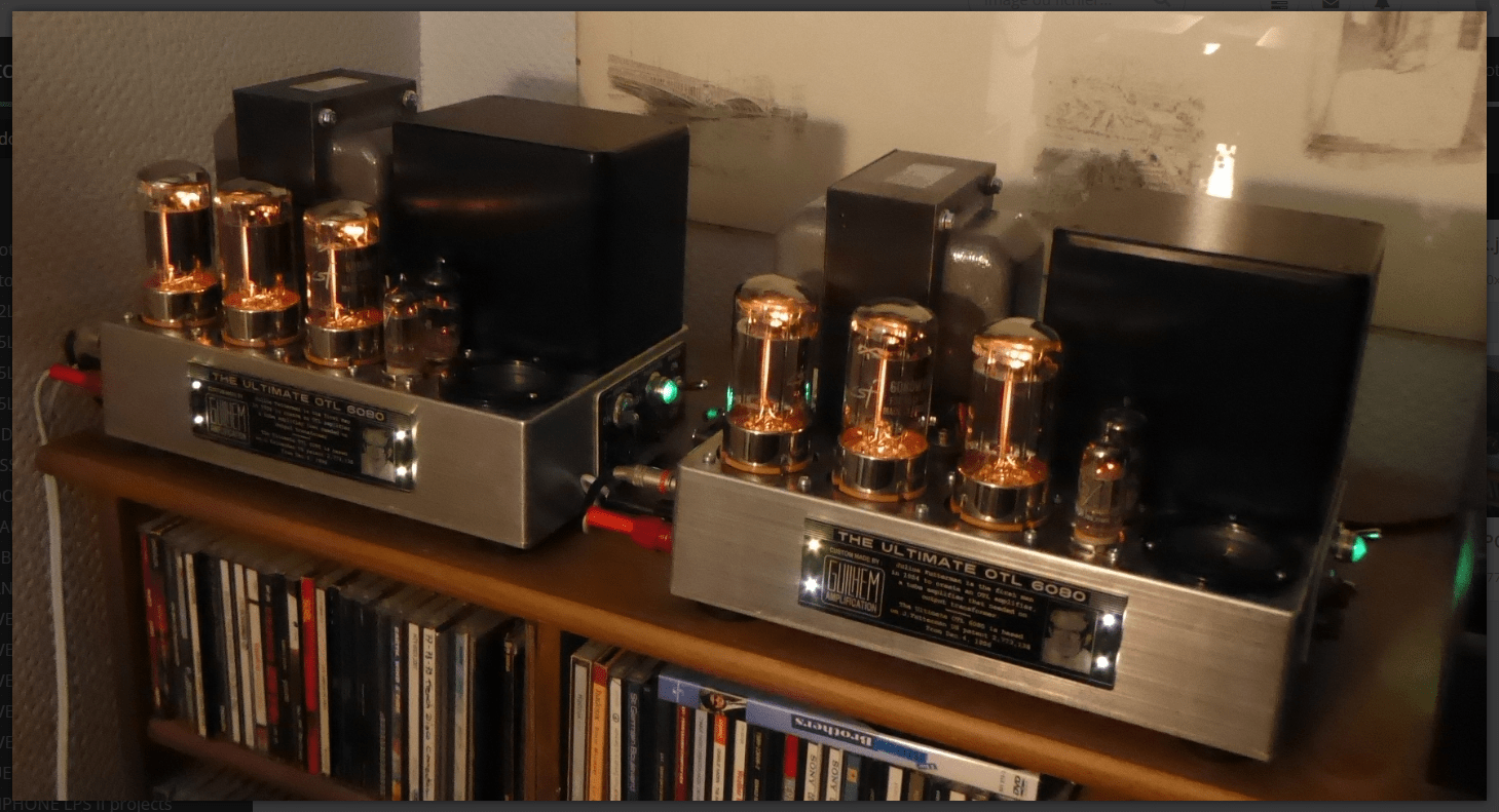

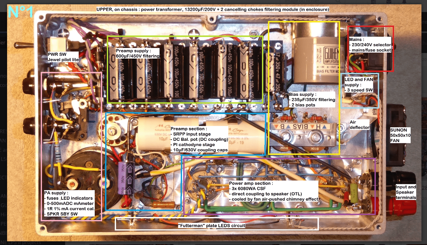

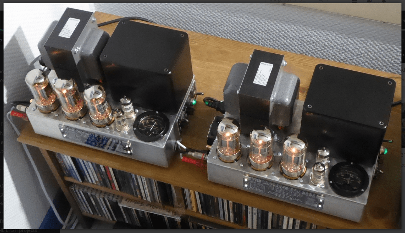

Well, speaking about the output impedance of OTL amps, my U-OTL6080 posted above measure 20 ohms (using E=U-rI, half-voltage method), making these amp usable on any conventional speaker enclosures.
