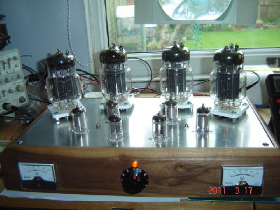

I built those 20W OTL with 4x6080 / 20WRMS fixed bias (below) in 1996, I sold them in the mid-2000 to a friend who still owns them without issue since then, if we except a set of new tubes :
I sold them because... They were heavy and big ! 🙄 But that's nonetheless true, compared to the size of my U-OTL of today !

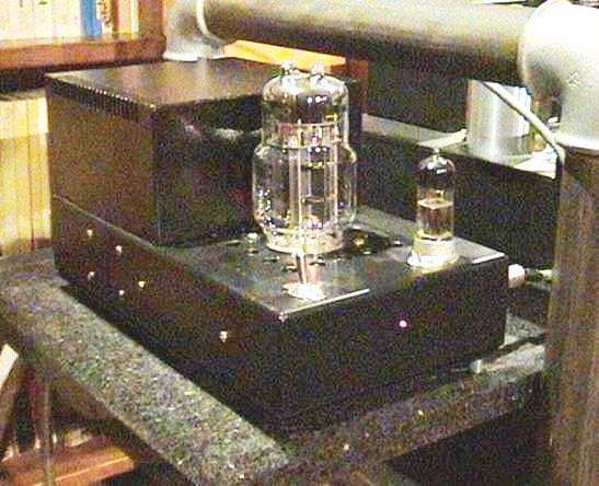

The protoype under tests in 2020-2021 :
The finished version in late 2021 :
I usually use them to drive a pair of Triangle T17FL2 fullrange DIY speakers or a pair of Klipsch Heresy I (with corrected crossover).
