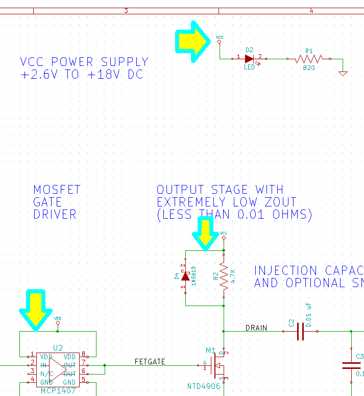

Noob question here: for the green power led, does the long leg (anode) go to the square pad or the round pad?
The silkscreen pattern suggests that anode goes to square, but I want to be sure - I don't want to pay $15 shipping from Mouser for a single led!

Honestly I don't remember. I recommend you use your multimeter on the "continuity" (beeper) setting, to figure out the answer on the PCB itself. Looking at the circuit schematic of the V4 Quasimodo, shown in post #1 of this thread and copied below, I observe that
so your beeper will quickly tell you which of the two LED thru-hole pads, is the anode.
- LED anode (the "+" side of the LED) has continuity to D4 cathode
- LED anode has continuity to pin 1 of integrated circuit U2
- LED anode has continuity to pin 8 of integrated circuit U2

And just in case someone has the same question about the LED orientation: yup, the long leg of the LED (anode, +ve) goes to the square pad.

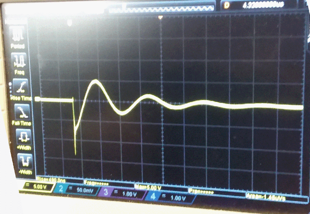

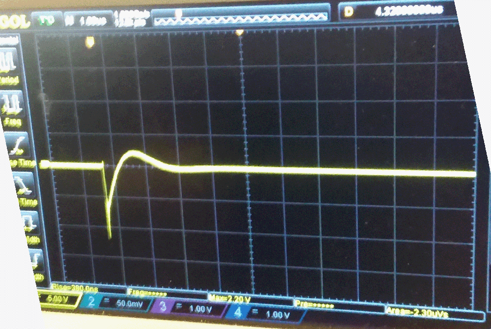

Thanks to Yoaudio for the board and the FET and Mark for the excellent circuit, I was able to find the perfect snubber for my Aleph J. The power transformer is a surplus toroid I bought years ago and weighs in at 7 Lbs. Based on the .15uf capacitor used , I came up with a series resistor value of 3.33 ohms. I have had the board for quite some time but my oscilloscope was broken. I have since replaced the old one with a ebay purchase.
Nicely done, @thompsontechs!

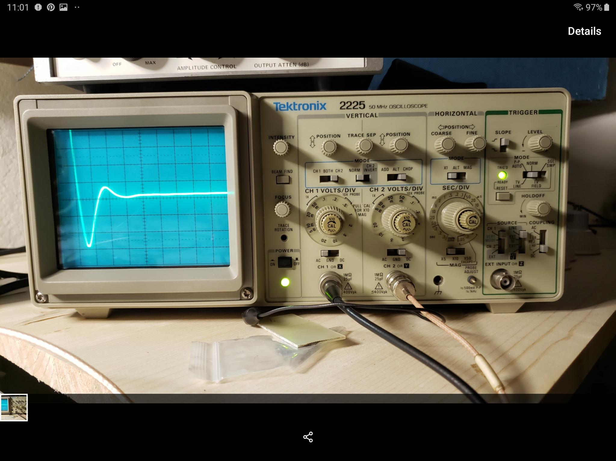

... although I'm afraid you can't join the Antique Tektronix Society with that digital oscillo-thingy....
Funny you should mention the digital... I took me longer to figure out the scope than it did to build the circuit. It's literally been 30 years since I did any work as a tech and the scope I used was the 5103.

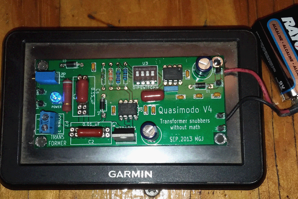

QuasiGarmin
Thanks Mark, it was a fun little project and also got me learning the new scope, so it was beneficial in a couple areas. It also made my old synapses fire, which is always good for those of us over 50.
