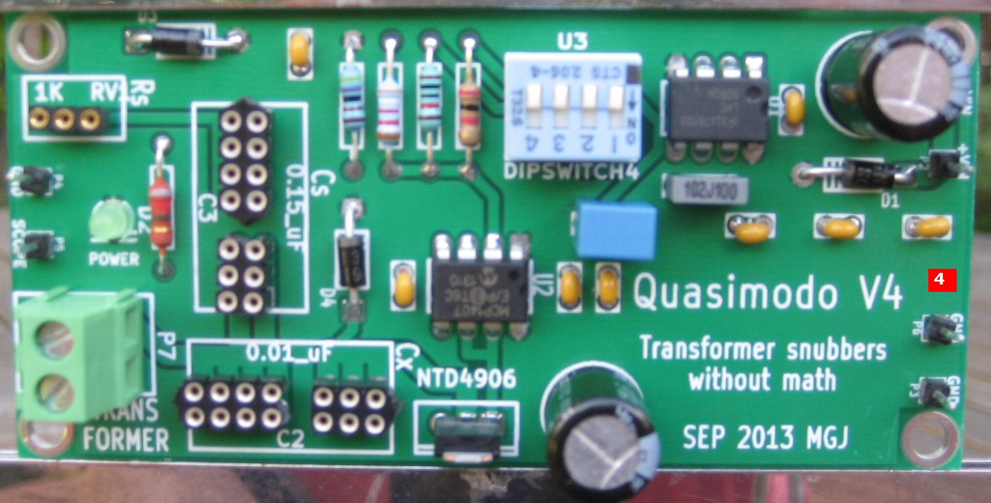

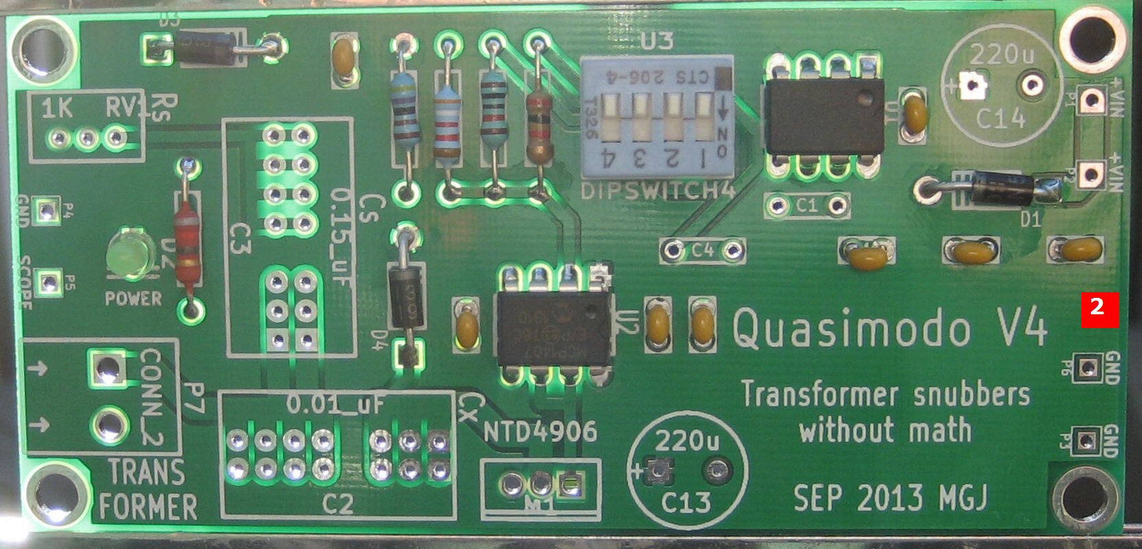

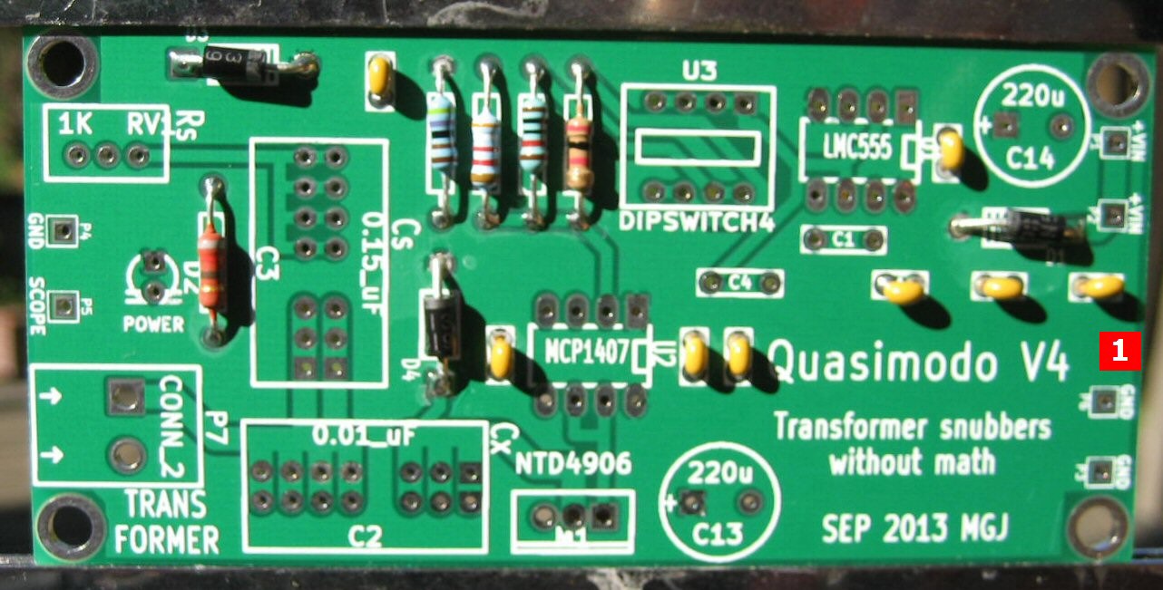

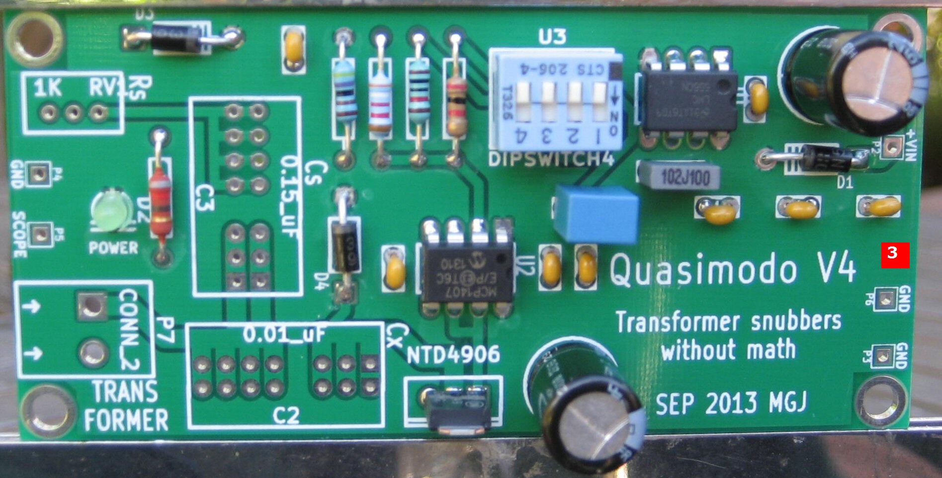

Build Guide for Quasimodo V4 thru-hole
- Insert and solder all resistors, Schottky diodes, and 0.1uF ceramic bypass caps (photo 1)
- Insert and solder the two 8-pin ICs, the DIPswitch, and the power-on LED (photo 2)
- Insert and solder the MOSFET, the film capacitors, and the electrolytic caps (photo 3)
- Insert and solder the green terminal block, the 3-pin socket for RV1, the (4x2 + 3x2) sockets for C2 and C3, and the six 1-pin headers for +VIN, SCOPE, and GND (photo 4)

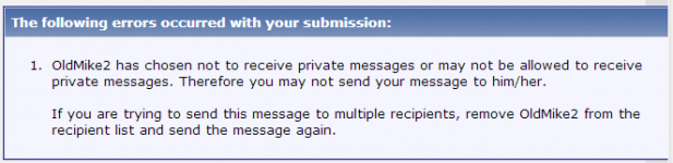

OldMike2, I attempted to send you a PM and got the peculiar error message shown below. Maybe your PM box is full, or maybe you disabled incoming Private Messages? So I sent you the QMV4 ordering information via email to your string1.string2.string3@gmail.com address.
