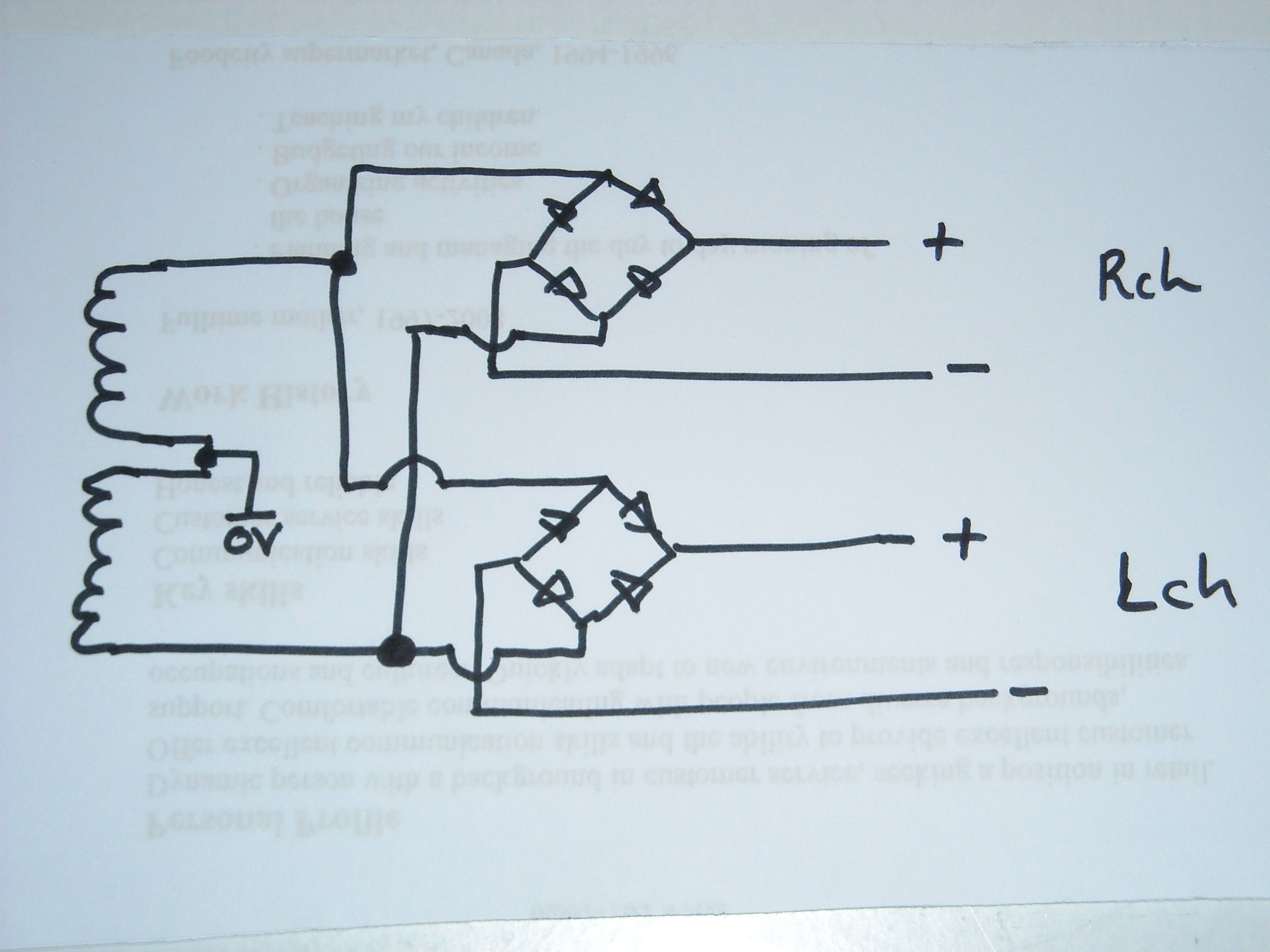

im refering to this setup, separate supplys for the left /right channels.
If the transformer is to drive 2 bridge rectifiers, would i use twice the values for C2/3, i.e. C2=22nF, C3=330nF ?
Please see the bottom row of Figure 13 in the Quasimodo design note.
You have a center tapped transformer and so you need two complete snubbers: (2 of Cx), (2 of Cs), (2 of Rs). The number of electronic components is six.
You can attach your bellringer test-jig to secondary "leg #1" as diagrammed in Fig.13, and select an optimum snubber. Then you can decide whether you want to assume that the optimum snubber for "leg #2" is near-identical to the optimum snubber for leg #1. (page 12, paragraph 3). If you are skeptical, if you do not feel comfortable making this assumption, you can attach your bellringer jig to secondary "leg #2" and find an optimum snubber for it. Perhaps the optimum leg #2 snubber will be extremely similar to the optimum for leg #1. Or perhaps it won't.
Perhaps it may not be the best idea to connect two bridge rectifiers to your CT transformer; I will let you decide that for yourself. But whether you use one bridge or two, you certainly do need two snubbers.

Thats what i did, using the last setup of Fig 13 labeled centre tap secondaries.
As shown there the transformer is driving one rectifier, but i am driving two recitifiers (see post 64), hence my question regarding the cap values.
Ctrlx, one way to analyze the situation when you double the number of rectifiers (thereby doubling the rectifier capacitance contribution to Ctotal), is to consider this a variation in rectifier capacitance. A +100% variation in Crectifier.
If, before doubling, you had chosen Cx to be much much greater than (Ctransformer + Crectifier), so that your Ctotal was insensitive to variations in Crectifier and/or Ctransformer (reason #2 to use a CRC snubber), then a doubling of Crectifier does not change Ctotal = (Cx + Ctransformer + Crectifier) significantly. Thus the resonant frequency omega_n does not change significantly, and the optimum snubber resistance does not change significantly.
Another design approach might be, to estimate the capacitance of the second set of rectifiers (conservatively over-estimate), and increase Cx by this amount.
A third approach might be, to arbitrarily increase Cx by 46.2%. Or to arbitrarily increase Cx by P% for some value of P that you happen to like best.
Whichever snubber component values you select, you will still (A) build a snubber with those component values; (B) apply a bellringer test to your transformer with that exact snubber, and (C) dial in the optimum Rsnub (zeta = 1.0) for your particular transformer and for that particular choice of snubber capacitances. As long as your snubber gives critical damping with your transformer, it is optimum. Whether you have increased Cx, left Cx unchanged, or decreased Cx.

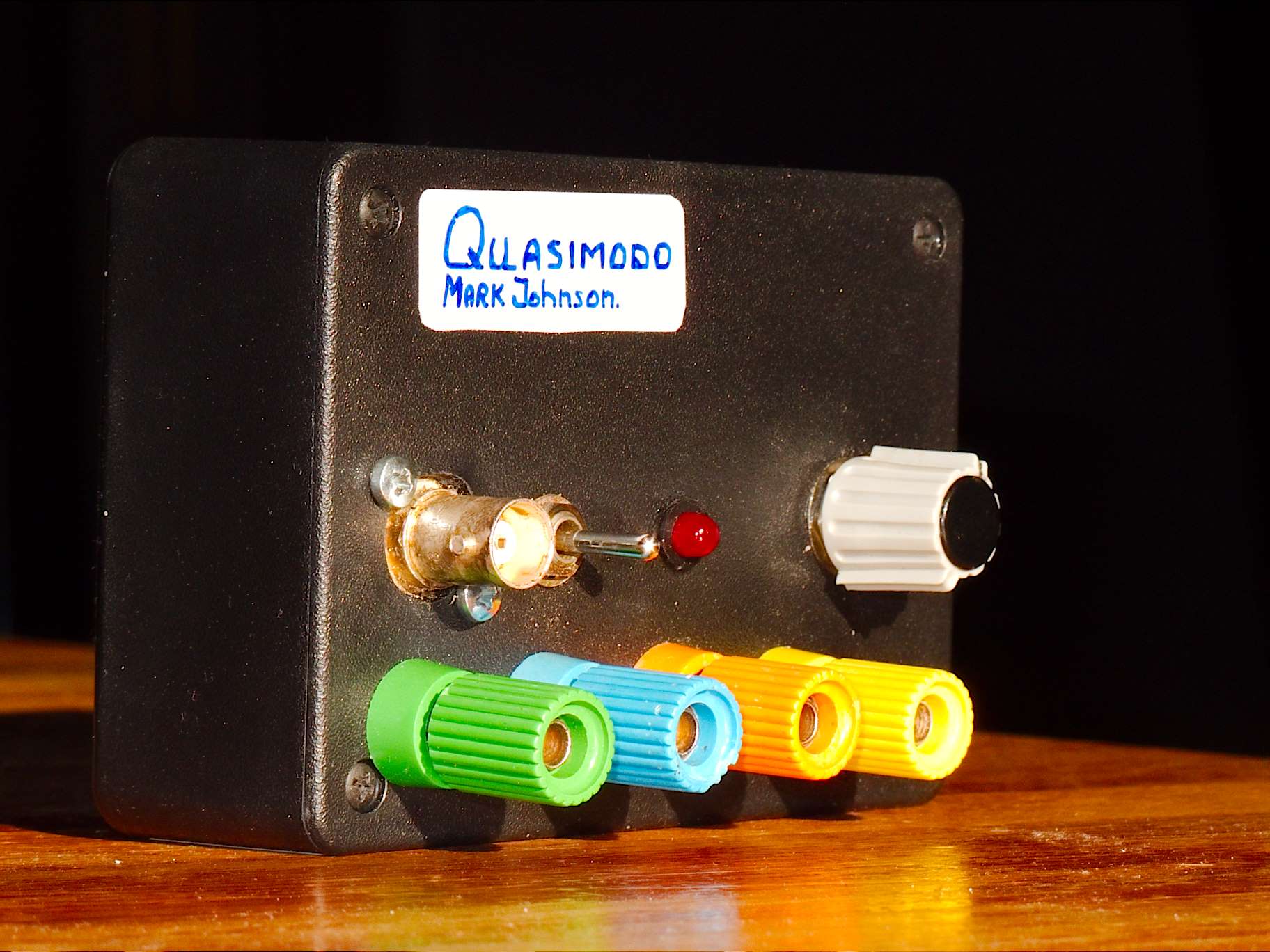

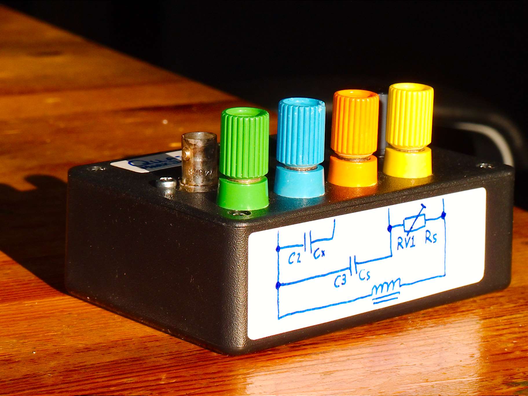

A few quick pictures of my 'final' implementation of the Quasimodo device 🙂
FdW: Lovely build, congratulations!
Your arrangement of binding posts is very clever; it lets you swap in whatever values of Cx and Cs you wish. It also lets you measure the resistance of potentiometer RV1. Finally it gives you the option to install a fixed resistor in parallel with RV1 if you so choose, to reduce the ohms-per-degree-of-shaft-rotation sensitivity. You know, to get those 3rd and 4th digits of precision 😉
Would you please say what the BNC connector is for? Is it sync-out to the oscilloscope? Is it DC-power-in? Or is there a battery inside the enclosure?
Excellent job, thanks for showing us!
