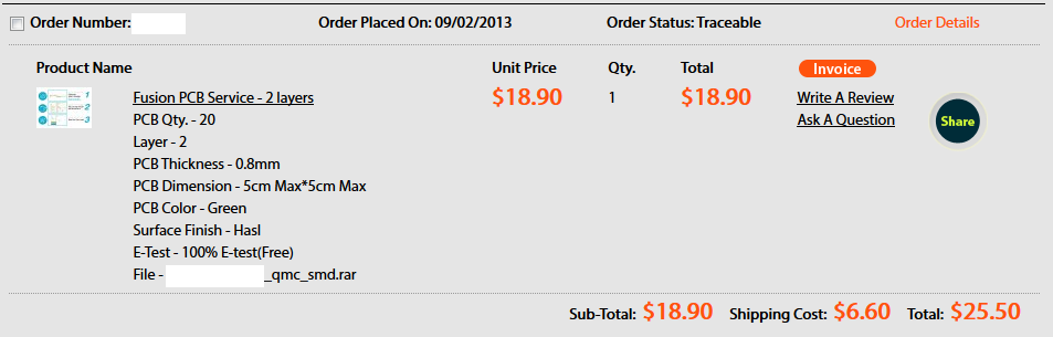

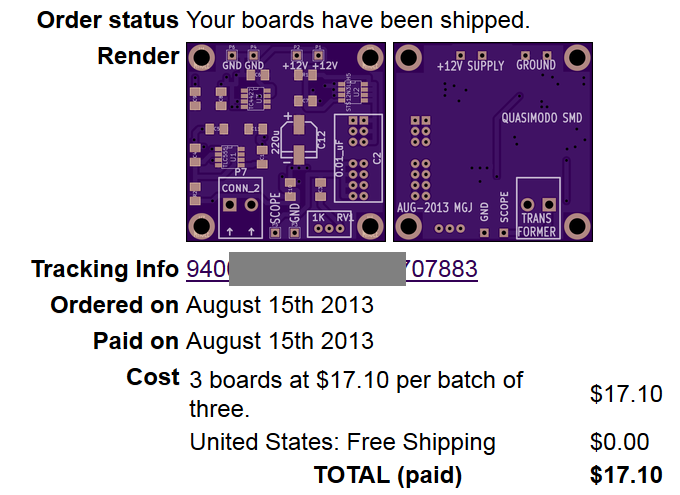

I ordered Quasimodo V.3 SMD boards from two different fab houses: OSH Park, and Seeed Studio. Google can find their websites for you. I have attached my invoices below, so you can see how much I paid.
I ordered the minimum quantity (3 boards) from OSH Park, and paid (17.10 / 3) = $5.70 per board including shipping to USA. Yes the boards really are purple and yes the solder pads really are gold ("ENIG"). That's OSH Park's signature, their emblem.
I ordered twenty boards from Seeed Studio (their minimum quantity is 10), and paid (25.50 / 20) = $1.28 per board including shipping to USA. These boards are the more conventional green color, and the pads are the more conventional tinned solder ("HASL") finish; you can see photos of them in post #27 above.
After performing my own Quasimodo experiments, I had zero OSH Park boards left over, and 12 Seeed Studio boards left over. The ones I sold here were Seeed Studio boards. (Why did I ask $5.00 for a $1.28 board? To pay for the bubble-padded envelope and for postage.)
Lots and LOTS of microcomputer hobbyists, MIDI hobbyists, and audio hobbyists use these two board houses, and there are tons of reviews of them online. You can get the opinions of many people, about quality and solderability of each fab house's boards. In my opinion, both were quite good and I had no problems with either one. If you decide to send the Quasimodo Gerber files (post #22) to either of these fab houses, I think the results will be satisfactory.

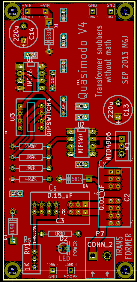

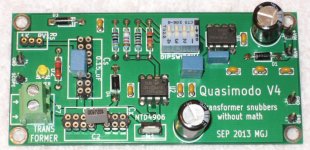

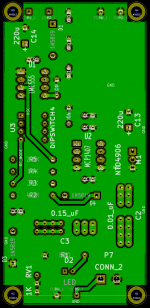

How is Version 4 coming along? Will you post the PCB and BOM files? I will be building this but given my arthritic hands and near 70 year old eyesight I would prefer a real world through hole component versus the Gullivers Lillipution SMD version.
I've attached the Gerber files and a Bill of Materials for a thru-hole implementation of the Quasimodo idea. They are in a .zip archive, attached to this posting. So far, I have built two of these boards and they work quite nicely. A component side plot is displayed in red (below), back side plot is green.
If anyone wants to organize a group buy for a batch of these boards, and/or boards + kits of parts, please do so with my blessings. The BOM and the CAD files are right here.
Edit The attachment here is incomplete. For the full attachment, see post #58"

Do you have gerber files for the boards?
Demonstrating my lazy engineer attitude what are the dip switch conbinations versus frequencies and what do you suggest regards the use of those frequencies to arrive at the best snubber component compromise?

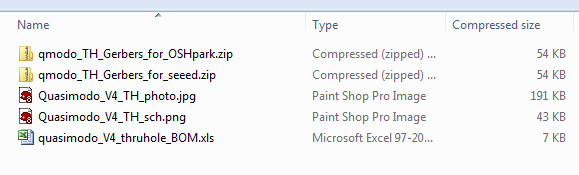

... Do you have gerber files for the boards?
I've attached the Gerber files ... they are in a .zip archive, attached to this posting {#54}
I recommend you compare the schematics of V3 and V4, they are attached to post #1 in this thread. One includes a DIPswitch and the other does not. I recommend you start out your Quasimodo adventures with your DIP switches set in such a way that your board exactly mimics the switch-free V3. After a couple hours of experimentation in pure V3 mode, it's time to horse around. Flip some switches at random, and see if things get better or worse, in your opinion. Don't worry, you can't hurt anything. None of the 2^4 = 16 possible settings of the DIP switches, are harmful.
I will leave it up in the air, as a slight mystery: Why might it be useful to have different oscillator frequencies? diyAudio members may enjoy thinking about this and possibly posting their guesses. As soon as someone chimes in to say "Hey! I've actually BUILT one of these (here's a photo) and I need someone to tell me where to set the switches and why! Don't worry, you can't hurt anything is NOT very reassuring!" ...
As soon as someone says that, and shows a picture of their QM, I'll post my original reason(s) why I included the DIP switches. By then, another member may have suggested another reason that's even better than my own.
Thank you again.
The zip file contained a schematic, a BOM and a picture of the loaded board I didn't see gerber files in there.
