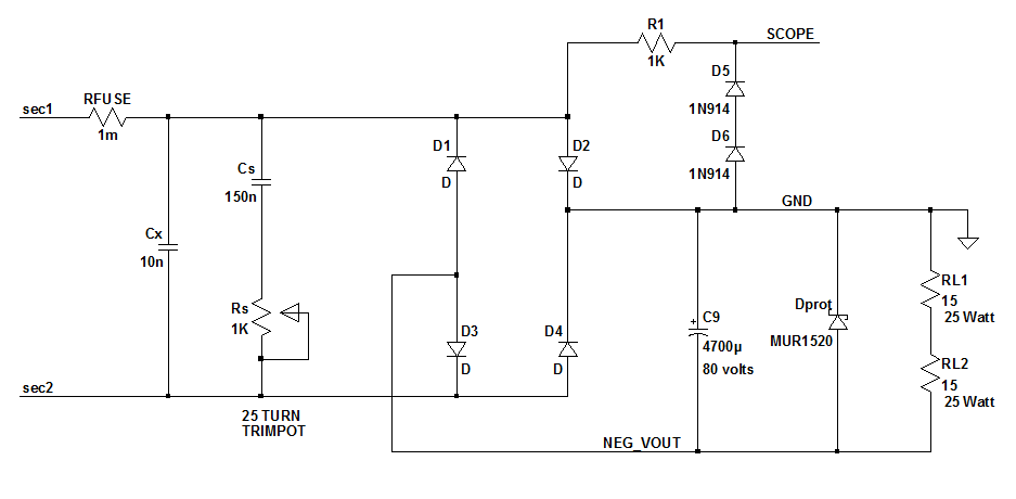

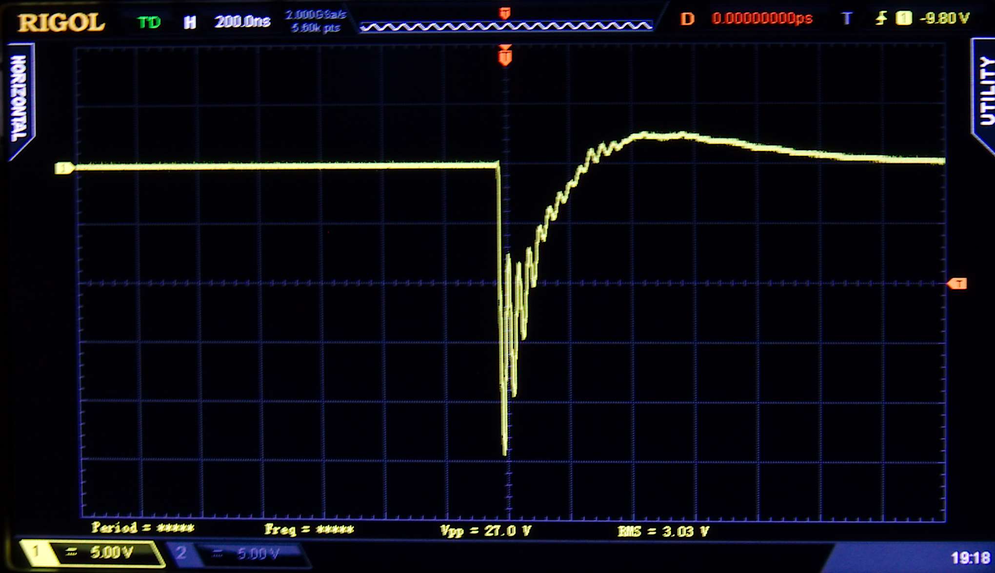

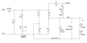

I tried that experiment myself, in August 2013. I used a test circuit adapted from Figure 16.10 in Bob Cordell's book (p.353), conceptual schematic below.

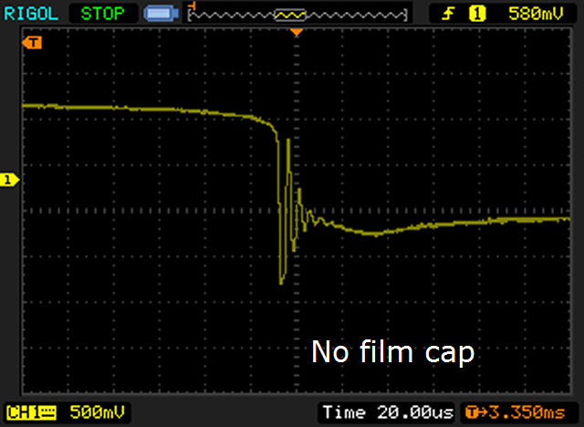

Monitoring the "Scope" node on a board with Cx removed, Rs removed, Cs removed, I got the WITHOUT waveform attached below.

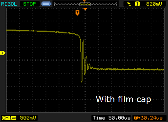

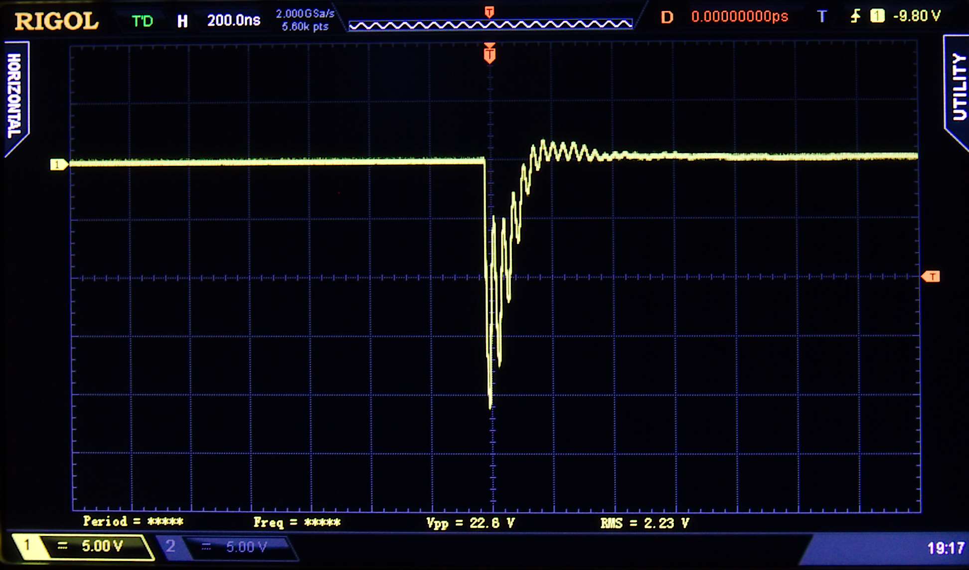

When I installed a stacked film capacitor in position Cx, but left Cs and Rs unpopulated, I got the WITH waveform attached below.
The stacked film capacitor did not eliminate the oscillatory ringing. A full CRC snubber a la Hagerman, did completely damp out all oscillation. The resistor provides a loss mechanism which destroys the Q of the resonant circuit. See the SNUBBED waveform attached below.

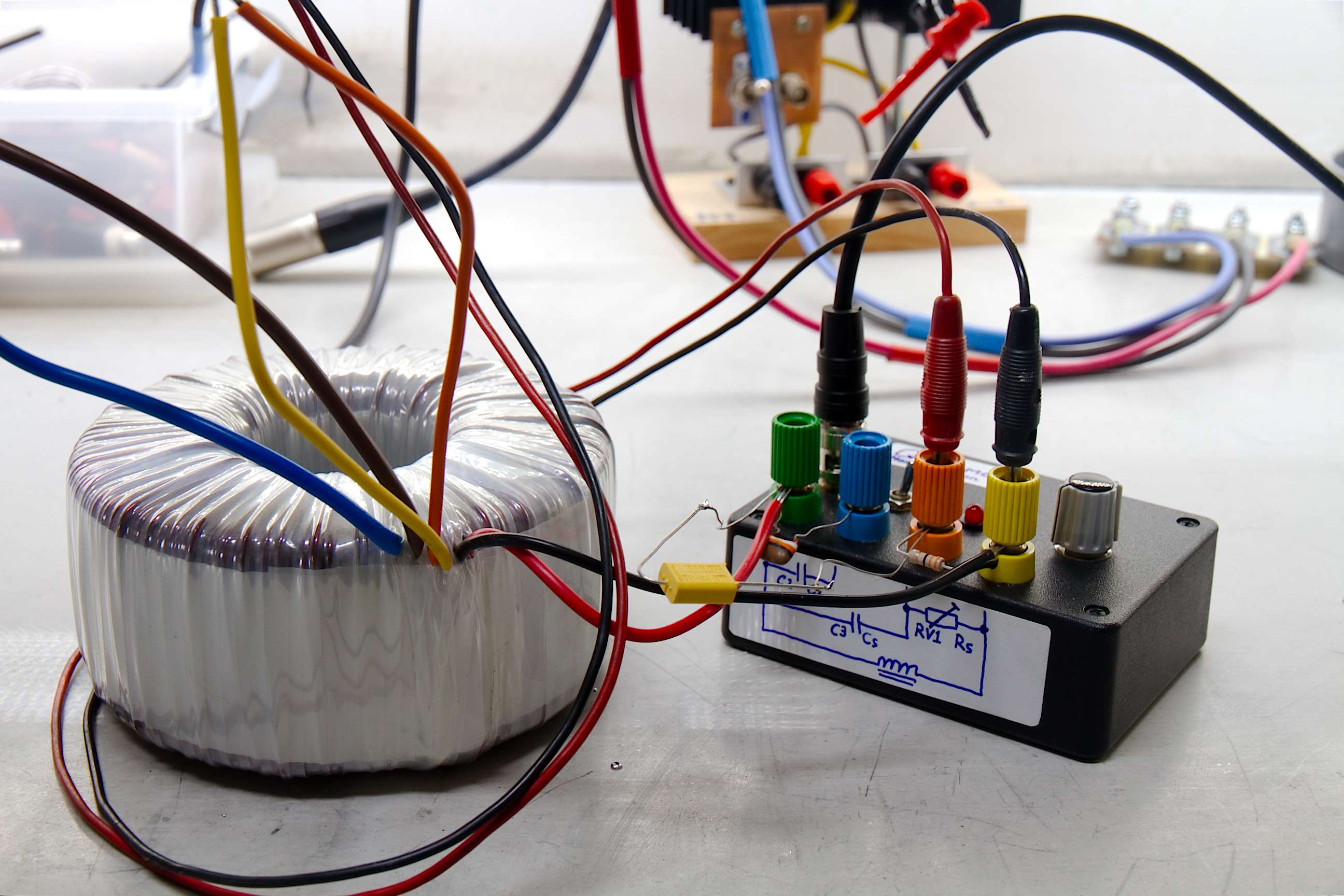

By the way, the annoyance and difficulty of using this particular test jig, gave birth to the Quasimodo idea. To dial-in an optimum snubber, it turns out that you don't actually need 25 watt resistors, or a (scary! possibly dangerous!) connection to the AC mains, or a big thumping $5.00 electrolytic capacitor with a 15-ampere reverse protection diode. All you need is a low-Z pulse generator, which is easily constructed on a tiny (50mm x 50mm) PCboard, running off a 9V battery. Not the scary, dangerous AC mains. Whew.
I have looked across the secondary with my digital Tektronix scope and see a large spike when the diodes shut off when no cap is there. With the cap the spike is very reduced and at a higher freq. But the sound of the buzz on the AM radio is gone, also gone on a Tektronix spectrum analyzer.

I agree and indeed that's exactly what I did. AC mains -> power transformer primary -> power transformer secondary (nodes "sec1" and "sec2" on schematic) -> diode bridge -> 4700uF filter capacitor -> load resistor. Scope is across bridge diode D2. When I tried your theory with real parts, the theory failed: connecting a film capacitor across the transformer secondary did not remove RFI.
However, when I tried classical circuit theory (second order linear systems), again using real parts, it succeeded. Connecting a damping resistor across the transformer secondary gave measured results that match theoretical predictions: critical damping (zeta = 1.0) removed RFI.
It's worth mentioning that the capacitor you advocate is the first 1/3rd of the "CRC snubber" that I prefer. Your capacitor across the transformer secondary is "Cx" in a Hagerman/Quasimodo snubber. There is also a Cs,Rs network across the secondary, in which Rs provides the dissipation that annihilates the Q of the secondary. That's what removes RFI at least in classical circuit theory.

I forgot to say in my above post, that I cannot believe that adding the .1uf film in you photo did not change the waveform. Photo 2 looks like a copy of photo 1. The cap had to do something, good or bad.
I know how the radio would sound after the cap was added. :^)

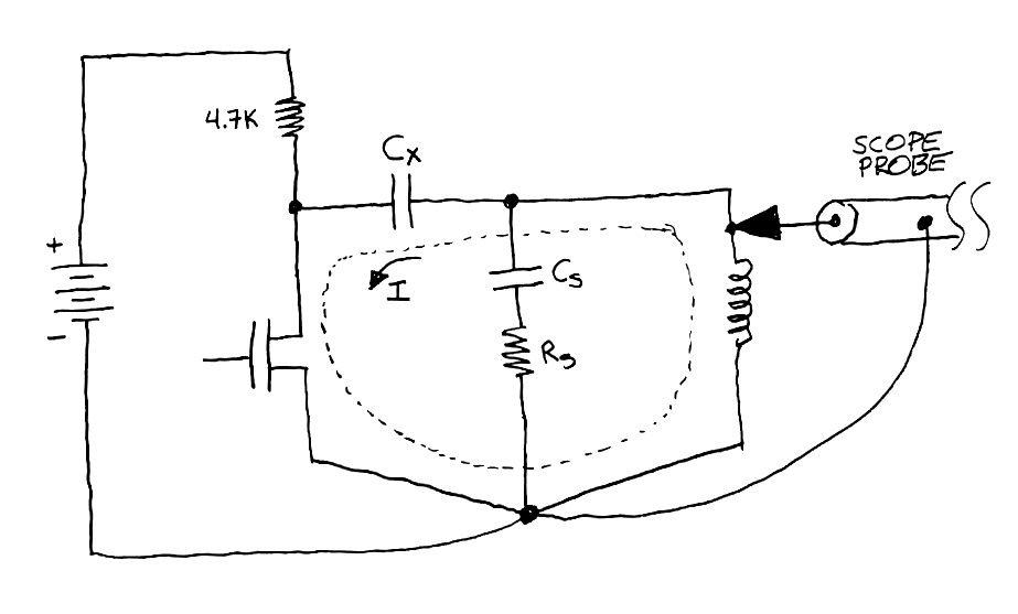

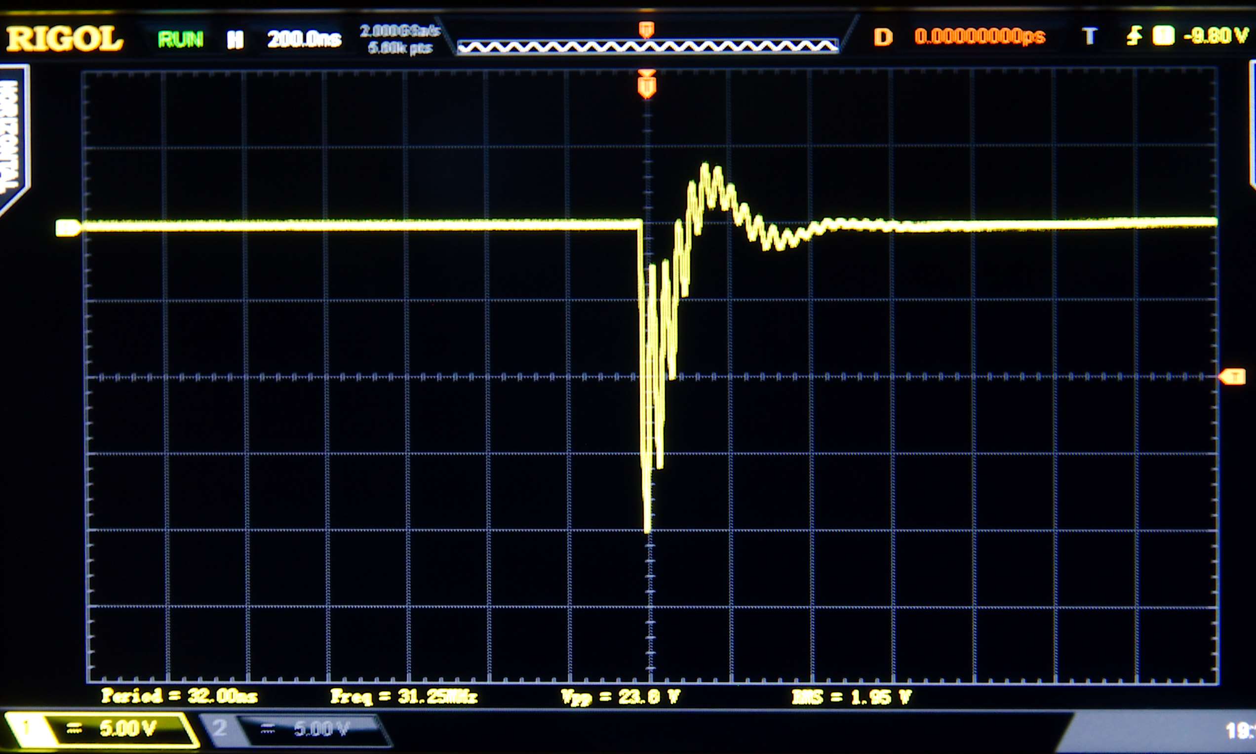

FdW, I have also occasionally seen those high frequency, low amplitude wiggles. Rearranging the wiring between Quasimodo, the transformer, and the scope can help to shrink or eliminate them; you want to reduce the total length of the current loop, and to minimize unwanted (parasitic) inductance. For example, you probably want Cx to have extremely short leads.
You can also experiment with adjusting the power supply voltage that feeds Quasimodo; sometimes the cleanest waveforms are observed at the extremes of the supply range.
