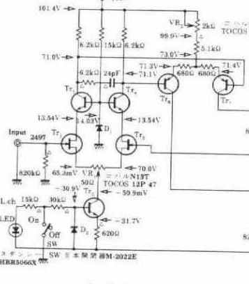

amplifierguru
can you post complete schematic of this amp
just want to check out, you havent made some less good things
if so, we will help you improve
and this is good for you
Hi lineup,
Thanks for the offer but I'll take my chances at present and keep the detail proprietary. Maybe after the first 100 pairs I'll reconsider. I trust you'll understand.
I still have to work out where I'm taking this.
Greg
Greg
