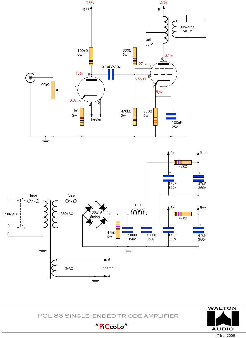

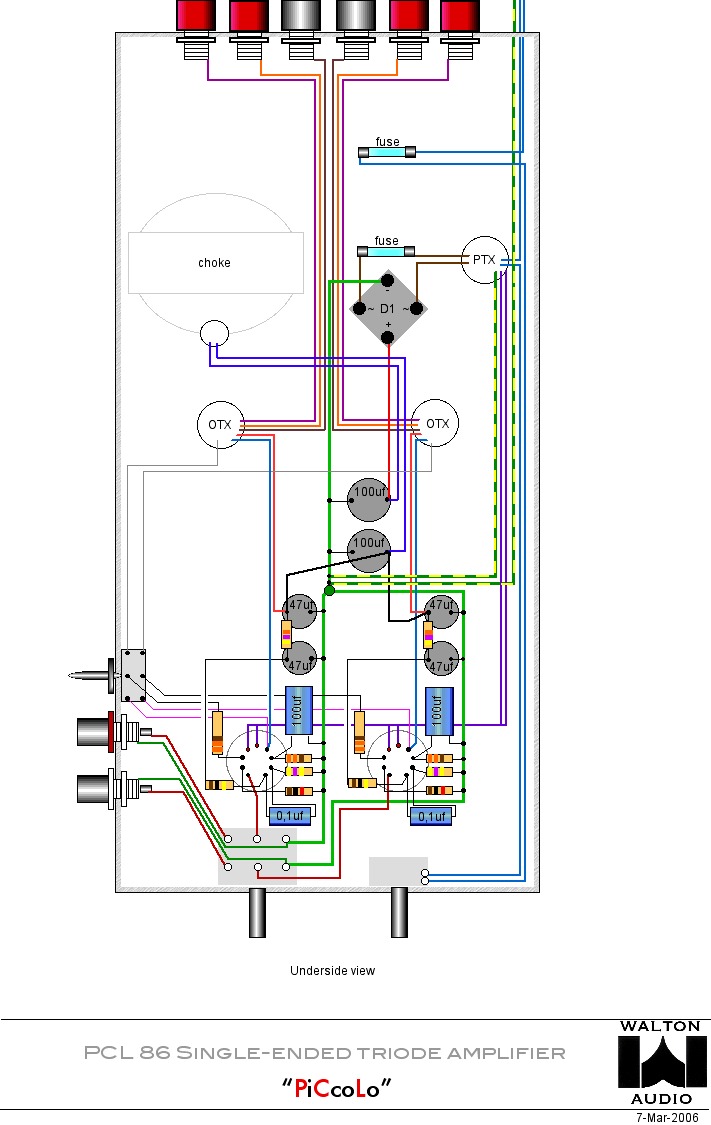

ECL82 vs ECL86 are different tubes no substitutions.
Derek Walton PCL86 (*NOTE: different heater, same tube)
"Therefore, you can use PLCL86 valves with the heaters in parallel or you can use ECL86 with the heaters in series."
You will probably have to substitute transformers, but the layout, wiring, etc. will help.
https://web.archive.org/web/20070106213517/http://www.iol.ie/~waltonaudio/pcl86.html

The web archive schematic shows negative feedback with a switch, this schematic shows no feedback. Why?ECL82 vs ECL86 are different tubes no substitutions.

ChrisABC,
No negative feedback . . .
That is right - if you are looking for Schade feedback, output transformer secondary to Cathode feedback, or Global feedback, it is not there.
But, there is Local negative feedback:
Triode Wired Mode
Ultra Linear Mode
Note: The schematic in Post # 41:
The Ultra Linear Tap shows more B+ to Screen Turns, versus Screen to Plate turns.
If actually wired that way, a 40% UL tap becomes 60%, and a 25% UL tap becomes 75%.
(Probably the schematic editor did not have a correct model for an actual UL output transformer).
Pentode/Beam Power is 0% Ultra Linear
Triode Wired Pentode/Beam Power is 100% Ultra Linear.
I have used 40% UL tap, 100% Triode Wired Beam Power mode, and 0% Beam Power mode for push pull outputs.
I have used 20%, 50%, 80% UL taps for single ended outputs,
as well as 100% Triode Wired Pentode/Beam Power mode, and 0% Beam Power mode.
Have fun building and listening.

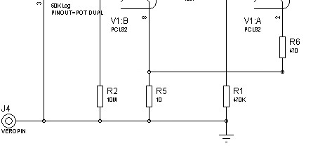

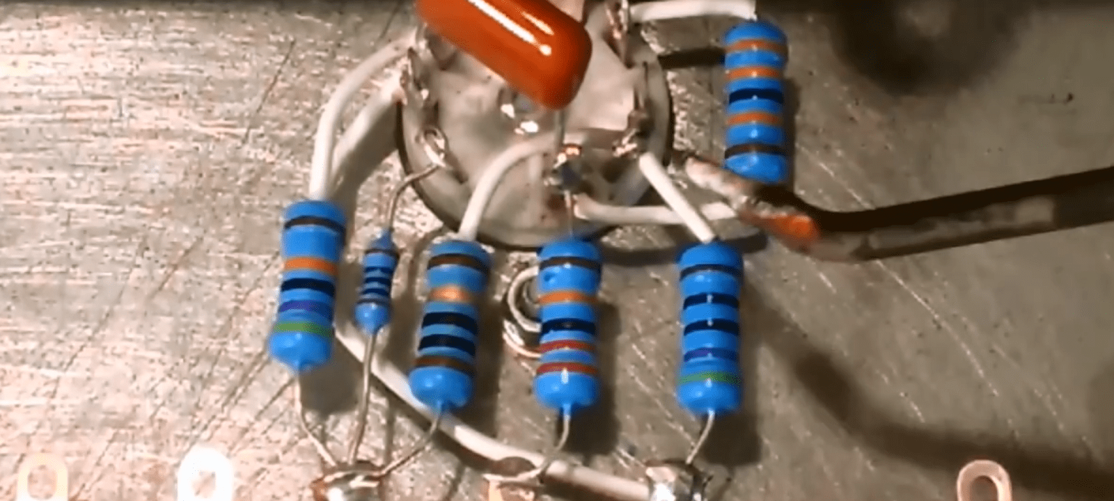

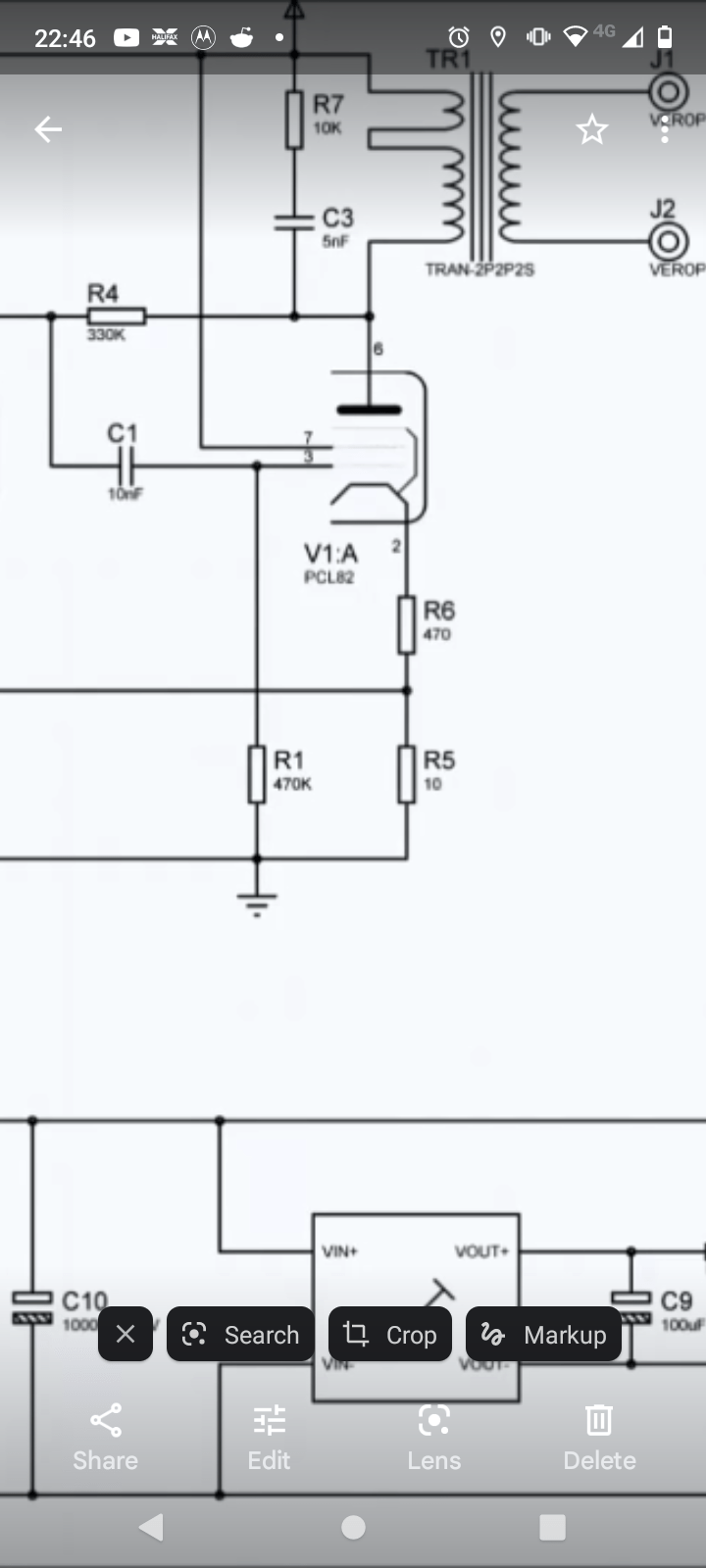

Sorry to dredge up an old thread, but on post 34 of this thread, there is a youtube video and a schematic.
The schematic shows R5 and R6 as being in series between pentode cathode and ground, with a connection between the two going to the triode cathode.
In the video, the author connects R5 to the pentode cathode and earth, and R6 between the pentode and triode cathode, with no connection to R5, apart from the socket terminal (16:10 on the video).
Can anyone enlighten me as to which is correct?
That connexion provides a degree of positive internal feedback.Can anyone enlighten me as to which is correct?
When carefully chosen the result can be zero internal impedance on the amp speaker terminals.
But depending on other circuit constants, in particular the OPT, instability may result.
The amp will also be a lot more sensitive to PS ripple. That hookup should be avoided except by the knowledgeable.
Schade NFB is not a cure all either. Again, such an amp is more susceptible to PS B+ ripple. 😱

Which hookup should be avoided?
The one in the schematic, or the one in the video?

I still don't get it. The video and the schematic are different. Which one should be avoided?@jhstewart9
Ignore this, it was me being thick.
What are you seeing that's different between the video and schematic? It was R6 and R5 that were confusing me (not difficult) until I looked at it properly.
Hopefully this makes it clearer. Bit of a misleading schematic for us amateurs.
By eyeball, that connexion puts a short across R5. 😱
In some circuits R1 is used to maintain stage gain while the cathode cap across R6 is eliminated.
But as usual, nothing is free. Some of the audio power out that should have been at the
OPT primary is now dissipated in R5.👎

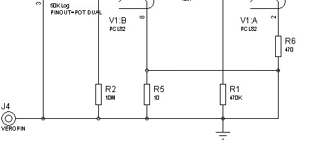

Sorry, my redrawn schematic is rubbish, should be this:By eyeball, that connexion puts a short across R5. 😱
No, it goes to pin 2 along with R5. It should be as per my last effort with redrawing the schematic.It was R6 for me as well. It seems to connect to a different socket pin in the video.
