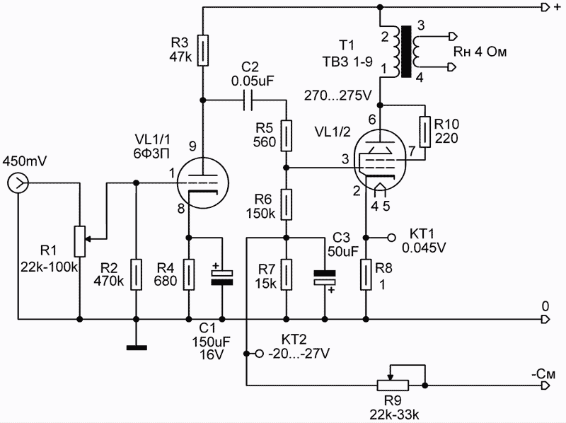

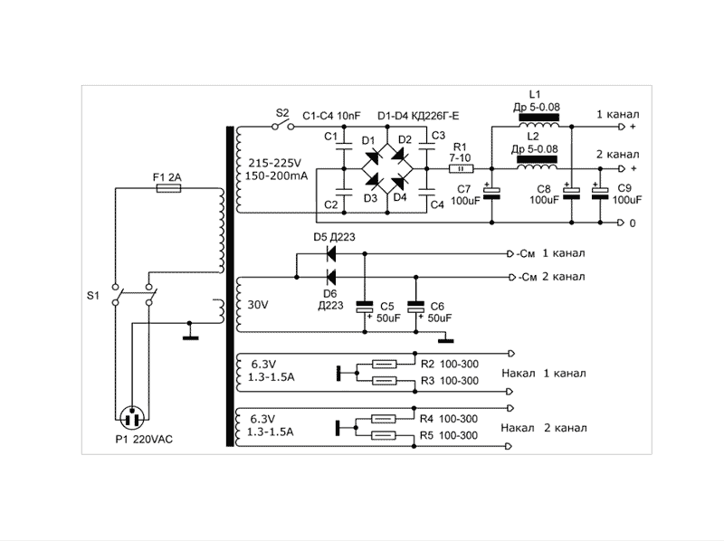

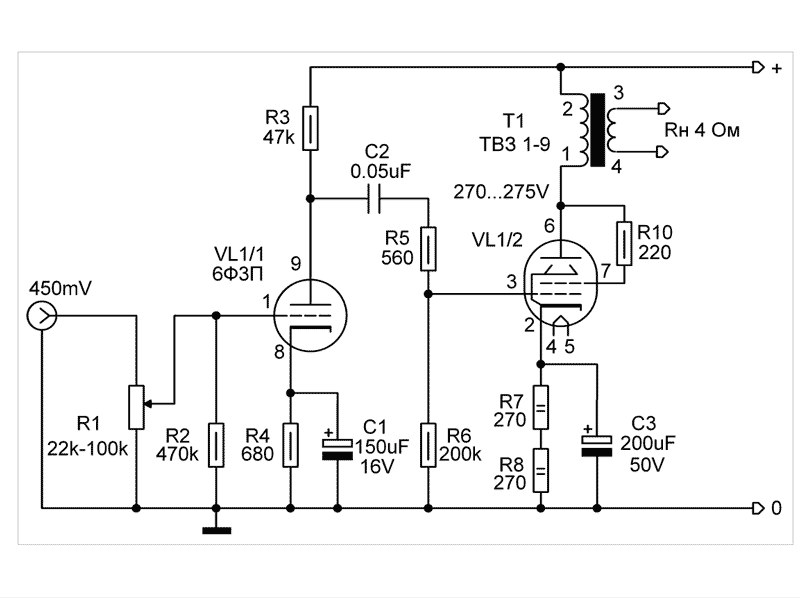

A distinctive feature of this lamp amplifier is simply the absence of scarce parts, but at the same time it has a good sound. Due to the ease of setup and high repeatability, this amplifier can be recommended to beginner radio amateurs. The author of this scheme is Anatoly Manakov. The output power of the amplifier is 2.5 W with a coefficient of non-linear distortion of 0.5-1%. The frequency range of the amplifier is from 30 Hz to 20-23 kHz. The amplifier is made according to a two-stage scheme. In each channel of the amplifier it is used on one 6F3P lamp. The 6F3P lamp is combined, it contains two lamps, a triode and a beam tetrode in one cylinder. The 6F3P triode lamp is used for preliminary signal perception, and the tetrode operates in the sensing output stage. The input signal through the consumption regulator consumes the grid of the 6F3P triode, wins and consumes from the anode through the isolation capacitor to the control grid of the output stage. The output stage is made according to a triode circuit, in which the screen grid of the 6F3P tetrode is connected to the anode through a resistor with a resistance of 220 ohms. In contrast to the tetrode mode, in the triode mode, its resistance is reduced several times, and a more linear characteristic of the lamp is applied. The disadvantage is the higher power output. The output stage on the 6F3P tetrode is loaded onto the TVZ-1-9 output transformer from a tube TV. Other output transformers of the TVZ series from tube TVs can also be used in the amplifier. Excellent results can be obtained with Edcor transformers. It is proposed to repeat the circuit of two amplifiers at 6F3P, the first (Fig. 1) - with the installed one, the second (Fig. 2) - with automatic bias of the output stage, a little constructively. Figure 3 shows the power supply circuit of the amplifier.
Рис.1. Схема лампового усилителя на 6Ф3П с фиксированным
Рис.2. Схема лампового усилителя на 6Ф3П с автоматическим смещением
Рис.3. Схема блока питания лампового усилителя на 6Ф3П
Детали . В усилителе применяются резисторы резистора МЛТ-0,5, разделительный конденсатор С2 типа К71-7, можно применять конденсаторы К78, К73. Блок питания выполнен на силовом трансформаторе от магнитофона «Комета-201». Можно применить унифицированные трансформаторы ТАН-28 , ТАН-29 , в крайнем случае при соединении усилителя с автосмещением можно применить силовой трансформатор ТС-180 от чёрно-белого ТВ, хотя он велик для этой конструкции. Дроссели Др5-0,08 от цветных ламповых телевизоров УЛПЦТ, или применение стандартных унифицированных дросселей Д22 , Д31 .
Электролитические конденсаторы в анодном питании К50-32 100мкФх350В, можно применять конденсаторы других типов на такое же напряжение, или выше-400В. Вместо дросселя можно применить резисторы МЛТ-2 номиналом 250-300 Ом, но ёмкость электролитических конденсаторов в этом случае желательно увеличить вдвое. Электролитические конденсаторы в выпрямителе с напряжением 50-100В.
При работе усилителя на загрузку 8 можно применить выходные трансформаторы ТВЗ-1-1, ТВЗ-1-2, ТВ-2АШ, ТВ-1-Л-1 от чёрно-белых телевизоров. При работе на нагрузку 4 Ом можно применить выходные трансформаторы ТВ-2Ш2, ТВЗ-1-9 от чёрно-белых и цветных ламповых телевизоров. При работе на нагрузке 16 Ом можно применить трансформаторы кадровой развертки ТВК, но при этом АЧХ усилитель может сузиться до 15-17 кГц.
настройка усилителя. При исправной лампе и правильном монтаже первый каскад в настройке не нуждается. настройка второго каскада сводиться к регулировке тока тока тетрода лампы 6Ф3П в пределах 40-45 мА по контролю производительности в катоде. При этом падение напряжения на катодном резисторе номиналом в 1 Ом должно быть в пределах 0,04-0,045 В постоянное напряжение. Для выбора усилителя с автоматическим смещением требуется подборка катодных резисторов так, чтобы ток через лампу на выходе схемы был мощностью 40-45 мА, при этом падение напряжения на этих резисторах будет в пределах 20-24 В.

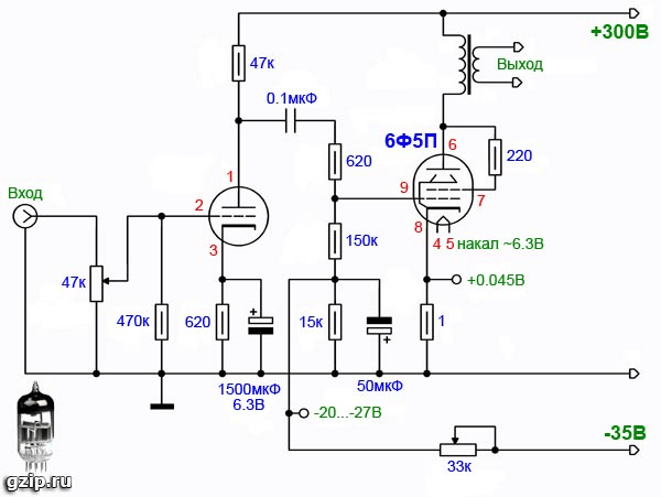

English please6F3P - ESL82, 6F5P-86
It sounds perfect, 5k output transformer
Yet:
For an amp like the one posted, the 0.22 coupling caps are far too large for any benefit.
I'd use 0.047's instead, they'd be better for taming down any postive grid voltage problems, and still provide plenty of bass.

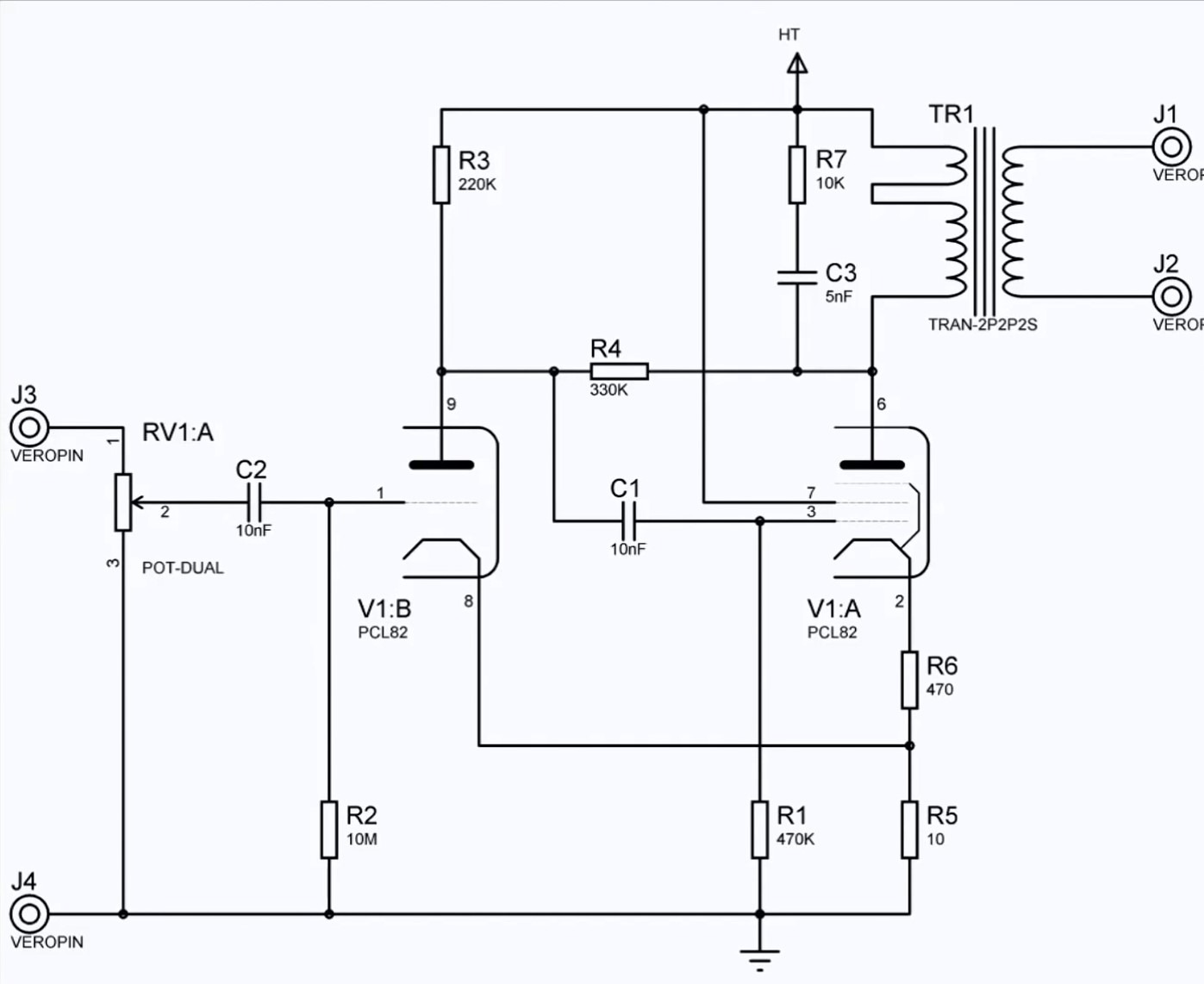

Hello everyone, I would like to back to initial post in this thread, published at 2022-01-23 by Peacocksuit. He reffered video where one guy from YouTube channel who inplemented ECL82 in very interesting way with series of local feedback not a global one. I am wondering can I substitute DIRECTLY ECL82 to ECL86? Directly I mean WITHOUT CHANGING RESISTORS VALUES ETC. Just electrical values (please ignore pinout and heaters supply voltage) - just anode/kathode current etc.?
As referance see the schematic I have copied from the movie on YouTube (
Thank you - could you please elaborate more on topic?That looks like Schade feedback. Plate-to-Plate. Typifies in modern times by the RH84.
dave
I read that both sections - triode and pentode - are different.
"None of the ECL 80/82/83/86 have compatible pin-outs. Perhaps just as well because their characteristics are quite different."
