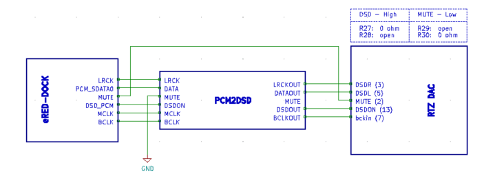

The polarity of the MUTE and DSDON inputs of the latest version of my RTZ shift register DAC can be chosen by mounting the right 0 ohm resistors, see R27...R30 on page 5 of DAC3_10.pdf and the note above them.
Hence, if the modulator only passes on the MUTE signal to the DAC, it should suffice to just mount the right zero ohm resistors. If the modulator itself gets muted, you could try tying its mute input low, connecting the #RED-DOCK's MUTE output straight to the DAC's MUTE input and mounting the right 0 ohm resistors.

Hi Marcel,
Thanks for your reply. I was aware about the setup for MUTE and DSDON in your board but was about the modulator input.
Your suggestion make sense and is more easy to implement.
Can you please confirm that my understanding is correct as per below oneline?
