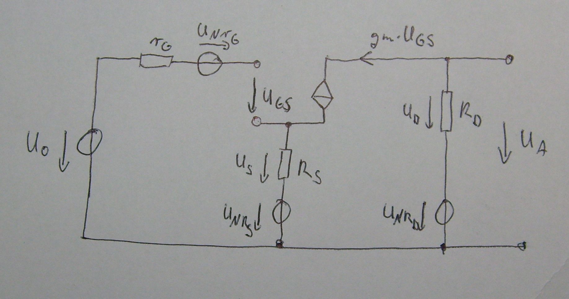

strange...I would have added the app. 0.15nVrt(Hz) noise from Rs directly to e_n_in.
Luckily noise terms don't add like that.
but it's a useful rule of thumb and it can be shown easily using a vastly simplified JFET model.
First determine the output voltage: Ua = -gm*Ugs*Rd+UnRd
which is roughly proportional to Ugs
Ugs can be obtained by making up the equation for the left loop and setting Uo to zero (shorted input)
Uo=Unrg + Ugs +gm*Ugs*Rs+UnRs=0
=> Ugs=(-Unrg-UnRs)/(1+gmRs)
as you see the Johnson noise from Rs adds directly to equivalent input noise of the JFET.
Btw. Dennis Colin has used a circuit similar to your lna and he subtracted the noise of Rs from his measurements.

ok, lets develop it further
with Ugs=(-Unrg-UnRs)/(1+gmRs) the output voltage gets
Ua=-gm*(-Unrg-UnRs)/(1+gmRs)*Rd+UnRd
divide it by the gain and you get the input related noise voltage
Ua/V=Unrg+UnRs+UnRd*(1+gmRs)/(gm*Rd)
with Unrg=rt(4*k*T*2/(3*gm), UnRs=rt(4*k*T*Rs) and UnRd=rt(4*k*T*Rd) you get:
Unin=rt(4kT)*(rt(2/(3+gm)+rtRs+rtRd*(1+gm*Rs)/(gm*Rd)
your (imho wrong) formula is:
e_ni = sqrt(4 k T) sqrt(1/gm + (1 + gm Rs)^2 / (gm^2 Rd))

Juergen, indeed I should have added the contribution of the source resistor Rs to the main formula. I will re-derive it below.
So, how does the equivalent input noise density e_ni varies in a simple common-source amplifier, like the circuit in post 383
http://www.diyaudio.com/forums/soli...e-low-noise-amplifier-lna-39.html#post2219606

e_ni = V_no / A_v
A_v = gm Rd / (1 + gm Rs) = gm Rd / (1 + gm)
The output noise density is the rms sum of the amplified jfet self-noise and the drain resistor Rd noise.
V_no^2 = 4 k T Req (A_v)^2 + 4 k T Rd + r k T Rs
Let's work with squares for now, so divide V_no^2 by A_v^2 to get e_ni^2, and replace Req with 1/gm
e_ni^2 = V_no^2 / A_v^2 = 4 k T / gm + 4 k T Rd / A_v^2 + 4 k T Rs / A_v^2
Therefore:
e_ni = sqrt(4 k T) sqrt(1/gm + (1+gm)^2 / (gm^2 Rd) + Rs (1+gm)^2 / (gm^2 Rd^2))
So what was missing from the previous formula was the contribution of Rs to the total input referred noise was the thermal noise of Rs, i.e. sqrt(4 k T Rs) / Av.
Juergen, does this make more sense now?
Hm, one more thing. I'm thinking that the noise contribution of Rs should not only be taken as the contribution of a series resistor. Assuming that the input was shorted, then the noise generated by resistor Rs can be thought of as the input to a common-gate configuration. Then the noise of Rs should be first amplified by the voltage gain Av and then RMS added to e_ni. If we do that the final formula should be
e_ni^2 = sqrt(4 k T) sqrt(1 / gm + Rd / A_v^2 + Rs)

John, I think it's nice to have the total noise formula, as well as the graphs. Looking at them one can see which factors have the greatest impact on the total noise.
In my opinion this IS seeing the forest. Trying to get the derivations right is just for correctness' sake.
we are making progress. The noise contribution of Rs plays a major part. The details should be understood, since some people still design phono preamps, with 2/3 of the input related noise not coming from the input transistors.
@ikoflexer: My network theory is probably more than rusty and I need to overthink the rms adding of noise sources.
But first things first:
Do you agree on the equivalent circuit shown in post 405?
http://www.diyaudio.com/forums/atta...rete-low-noise-amplifier-lna-jfetrauschen.jpg
regards
Well, for me, it is like this. The effective input noise resistance is 2/3(1/gm) + Rs That is all there is to it, for j-fets.
Yes John, I think you just summarized my last equation. The voltage noise of both the equivalent resistance of the jfet channel and of Rs get amplified by Av, so the two of them can be combined as
Req = (2/(3gm) + Rs)
The only other voltage noise source is Rd and is in series. So the total output noise should be
eno = sqrt(4 k T Req Av^2 + 4 k T Rd)
which, referred to the input is
eni = eno / Av = sqrt(4 k T (2/(3gm)+Rs) + 4 k T Rd/Av^2)
Juergen, I'm ok with the picture you drew except, if the input is shorted, shouldn't Rg be gone? Also, in the formula you derive, you don't add the noise voltages using sums of square roots.
