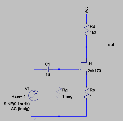

We want to see how the equivalent input noise density e_ni varies in a simple common-source amplifier like the one in the first attached image.
Assume:
* Rs = 1 ohm
* B = bandwidth = 1Hz
* T = 290 degrees Kelvin
* input is connected to ground, hence source resistance is zero ohms

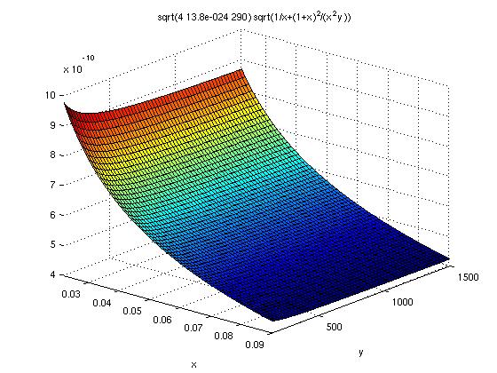

Now we can see in the equation of e_ni that as the value of Rd increases, e_ni decreases. However, it's not so easy to see how drastic the relationship is.
Took this formula and plotted it in matlab varying gm from 20mS to 90mS and Rd from 150R to 1k5. That's the second attached image.

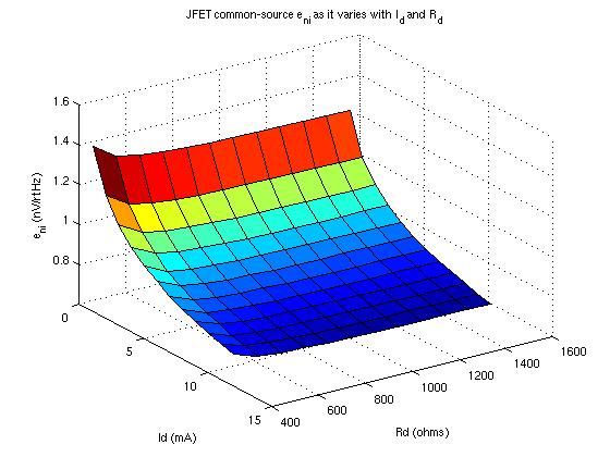

Hang on, I'll also show the relationship between noise and varying the JFET operating current Id. There was a discussion about this previously, but I'll show what the theory predicts.
Here's another plot, of the same formula which assumes Rs = 1R. This time it shows the input referred noise density as it varies with the operating current Id = [1mA, 2mA, ..., 12mA], and with Rd = [400R, 500R, ..., 1500R]. Idss was assumed 12mA, and pinch-off voltage Vp was assumed 0.7V.
To get this note that the JFET transconductance is defined as:
gm = 2 sqrt(Id Idss) / Vp
so gm can be replaced in the e_ni formula above.
Notice how the noise decreases significantly as Id approaches Idss, and how if we fix Id, Rd does have an effect in that the noise lowers for higher Rd, but the effect is very small.
Note: all the above implies one fjet. For a parallel combination of jfets you can imagine that the gm (Id and Idss) is (are) larger, Vp stays the same.

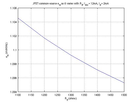

Another plot, this time keeping Id fixed at 2mA.
Idss = 12mA
Vp = 0.7V
T = 290K
Rd varies. This shows better the change in input referred noise as the drain resistor changes in value.
