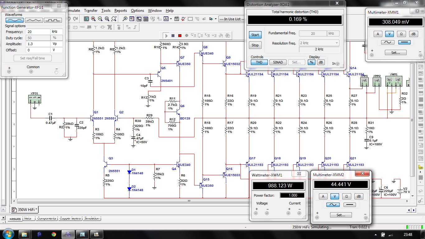

980W@2R 0.169%THD@20kHz

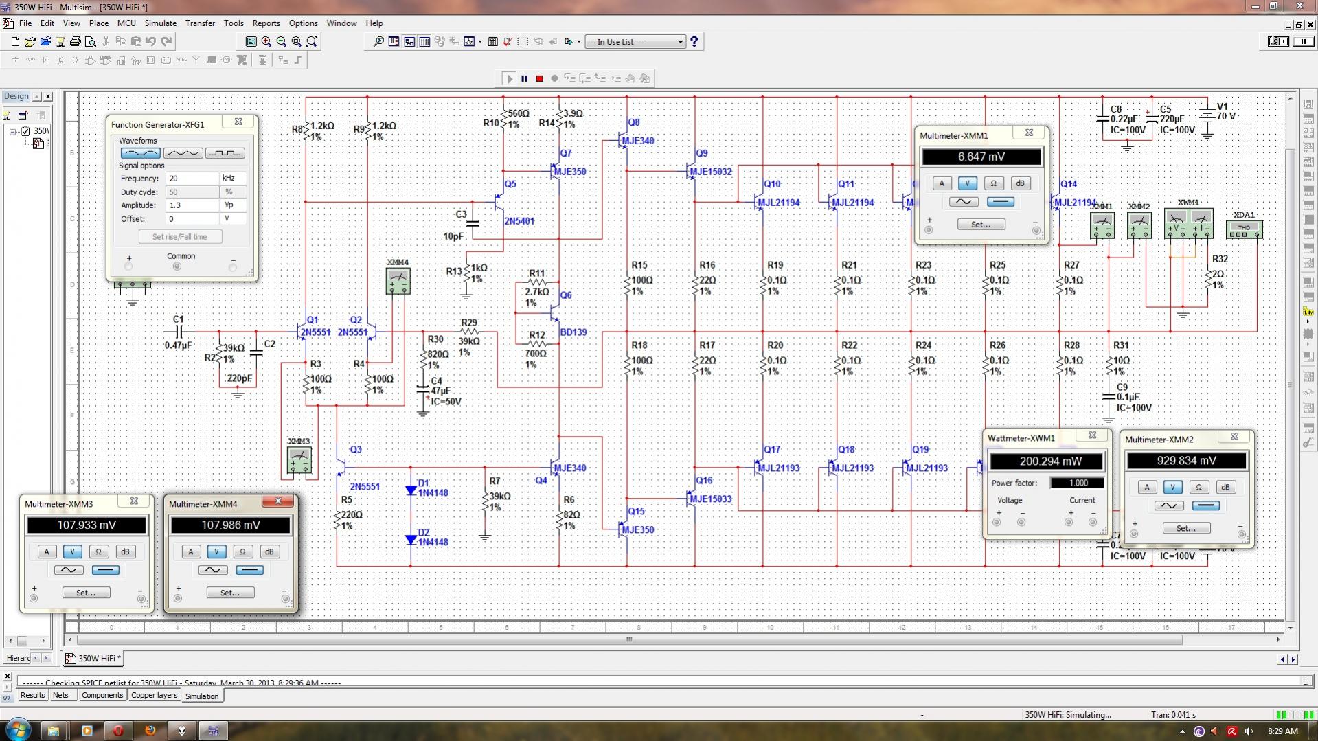

Here is a circuit of 2n3773 8 pairs,70-0-70 volt d.c. 42 volt output at 0.497% distortion power output 887 watts into 2 ohm
With just 24mA bias per device, and 9.3nV DC offset. 980W@2R ultra low THD of 0.169% @ 20kHz, with 5 pairs MJL21193/4. THD could be further reduced using more output pairs.
Just simulated my design, wonder it would perform like this in real.😉
Aniket

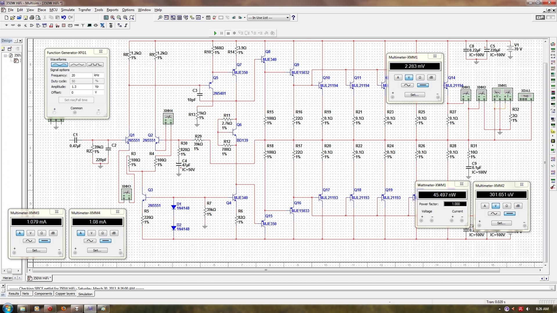

1.079 and 1.08 equals 2.159mA through Q3 collector. Add on ~1% of this for base current and you should have ~2.18mA through R6, giving Vr6=479.6mVdc.
Is that what is being modeled?
You MUST check this when you build !!!!!!!!!!!!!!!!

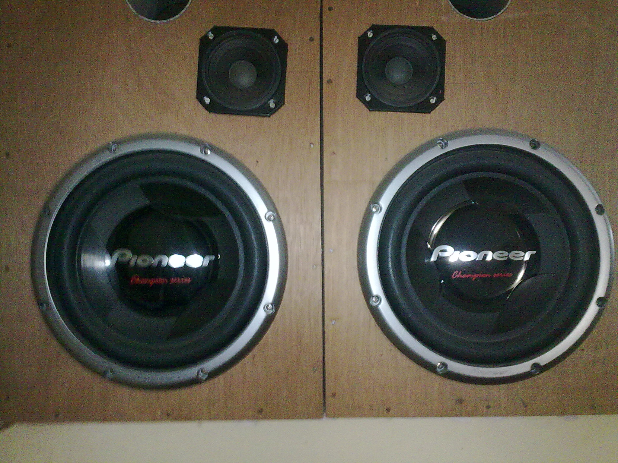

I am NOT at all intended to make this 980W amp. what for such an outrageous amount of power for home use.
However, I am currently working and tweaking this http://www.diyaudio.com/forums/solid-state/228463-anybody-know-amp.html
amp. for my home system and I expect around 250-300W@4R to power my speakers which are rated at 400W. A pioneer 12" sub(TSW1208D2) and an audiopro tweeter rated at 50W using a passive crossover.

FWIW, I liked aniket's design, my amps are usually as simple as that one and I know well what they can and what they can not achieve.
That's why I also commented (based on experience) that a copper-and-silicon real life one would perform much less than the simulation.
The *main* problem is that the simulator works with the parameters set by the designer , it does not know better.
There is written "+/*70V rails"? ... ok, so be it. (It thinks).
But such an amp, fed from a transformer/bridge/capacitors will see anything but "clean 70V" .
Current will travel through real copper wire, probably through connectors (unless it's hard soldered to the speaker 😉 ), etc.
All of which are at least resistive.
But the main culprit will be the PSU: will drop a lot, show ripple 40dB higher than the vanishing distortion, said voltage will be "modulated" by current consumption, etc.
In fact that amplifier will need quite a good transformer to supply more than 600W RMS into a 2 ohms load.
Definitely less than 700W.
It also shows no short protection, which in a few applications might not matter much (hardwired fixed PA or Club systems) but in any portable system (PA/DJ) are most important.
But the worst is that at such high power levels heat dissipation is crucial, so it pays to go to use at least Class F/G/H types.
A Class AB amp, around 70% efficient, will have to dissipate that extra 30% as pure heat.
300W of heat are a *very* serious problem.
Not forgetting the the power transformer will also have its share of heat to dissipate too.
Nobody told the simulator that 🙁
Also; please do not be cheated by the fake *sensation of precision" simulators give.
That their Math is set to provide 5 significant digits or more, only reflects what the software writer thought approppriate, but end results can't be more precise than the data we feed it.
If I measure , say, 27.1V across a nominal 8 ohms load, my calculator will provide "impressive precision" 3.3875 A current ... which hides the fact that my voltmeter could provide either 27.0 , 27.1 and 27.2V and can't show a finer resolution
Yet a power calculation with such results would yield:
V^2 / R=734.41/8=91.80125 W
Impressive "precision", huh?
Of course, such amp should be rated "90W" or even "92W", although that final display of precision might be challenged on at least a few units out of the production line, simply because of normal parts tolerance.

o.1 Ohm 5W 1% emitter resistors? Never seen anything like that. The best I know of are 5% metal oxyde 5 and more Watts emitter resistors.
At 24 mA bias (if I got it right), and 0.1 Ohm, your amp is severely underbiased; to be properly biased, it should have at least 240 mA per transistor with 0.1 Ohms.
Because it is severely underbiased, it will probably sound slow and heavy, and will have problems at high power levels because of very bad bias spread.
On the plus side, in comparison with your initial 50W amp project, you have come a long way in a short time. This topology is light years ahead of the original one, but is still just a good beginnig. Don't worry, we've all been there and have moved on since, some things simply need time.
As you have been told by others, you would do well to put in a 47-100 Ohm resistor in series with your driver transistor base, and 2.2-12 Ohms in series with your power stage transistor.
They serve to reduce chances of oscillations appearing, which can happen at sometimes surprisingly high frequencies for a bipolar power device. I assume this is what Nige's brother referred to.
One observation - NOBODY here seems to produce the usual prudent protection against overheating, overcurrent, overvoltage and excessive DC in output signal. Any of these could easily take out the amp, the speaker or both. Also, no elimination of capacitors by using DC Servo circuits, which are essentially rather simple. No matter which, from no matter whom, at no matter what price capacitor is always inferior to the capacitor which is not there.
On this amp in specific - it will possibly deliver 980W/2 Ohms in short peaks only (which is realistically all you would ever need). Look up the data sheet and do the derating as shown there assuming only that it had been working at 1/10 of nominal power beforehand, meaning that it had reached something near to its normal operating temperature. Remember we usually keep heat sink cutoff temperature at 65 deg C, which means that our junction temperature is at least 85 deg C. Derate as shown and you will see we can't really expect much more than 550-600 WRMS into 2 Ohms on any sustained basis because of overheating.
Also, you can reduce its VAS current from 10 mA or so to 5 mA, that's more than enough given that you have a triple output stage topology (predriver, driver, power). That in turn allows you to use BF 721 instead of the MJE transistor, thus reducing your inherent distorion from nominal 0.169% to less than 0.08% or less.
