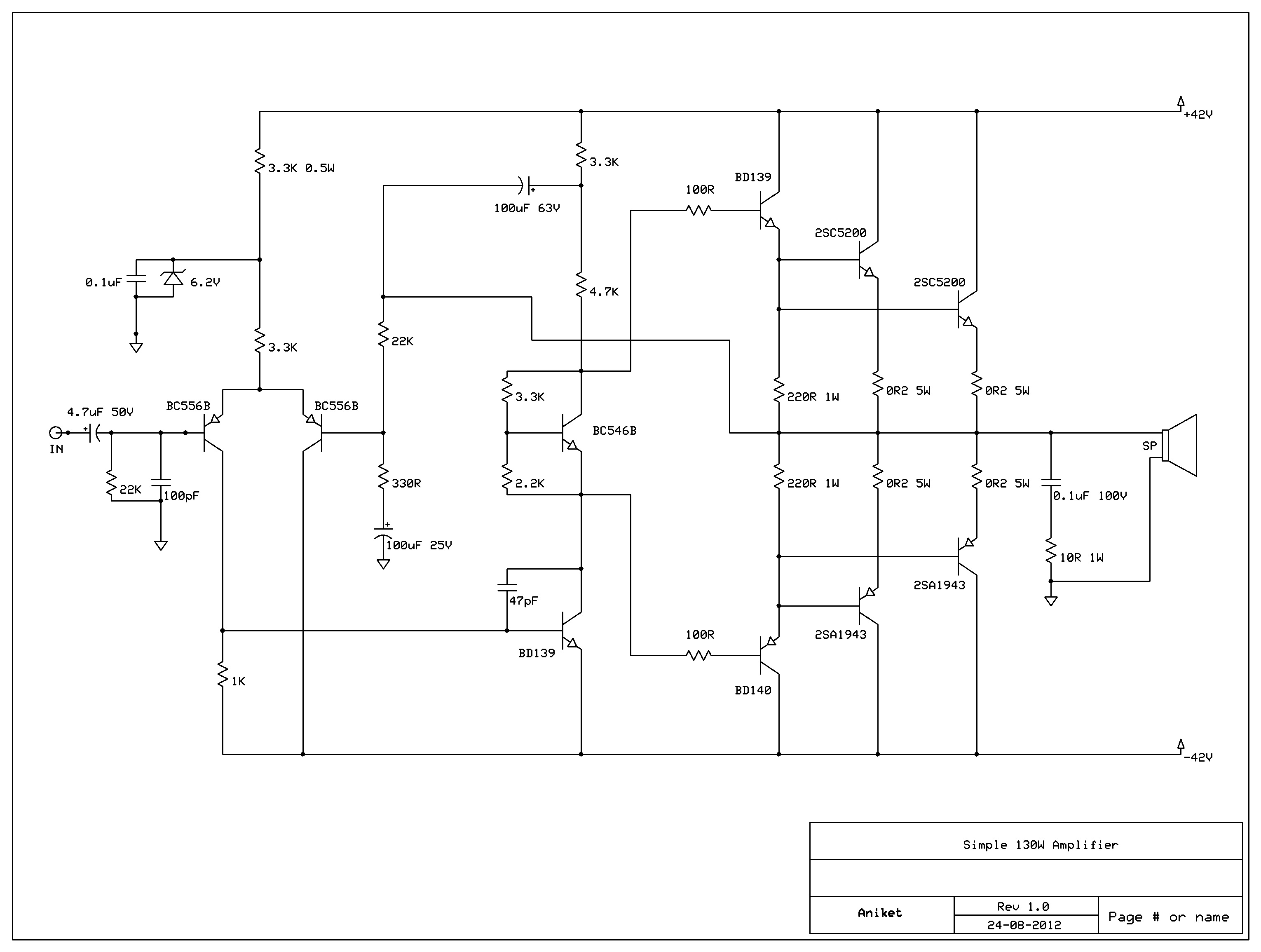

Simple 100W power amp
thanks formula 22,
you made my amplifier even better, i would do the changes and mention the results later.
Earlier in the original circuit i set the bias to 25mA, output shows only 1mV, amplifier is dead quiet, no hum, no hiss.
what could be the ideal bias setting as you have included a trimpot in the schematic you updated.

BC139 for bias should be on the refrigerator (heatstink) with a 2N3773 or MJ15003 and the best with MJ15022 or MJ15024!!.
Quiescent current with 2k2 trimmer set at about 50mA.
Amplifier great works with these changes I have indicated in the schematics!!
2N3773 replacement with MJ15022 or MJ15024 and BD139 and BD140 replacment for MJE15032 and MJE15033!!
BD139 for bias remains.

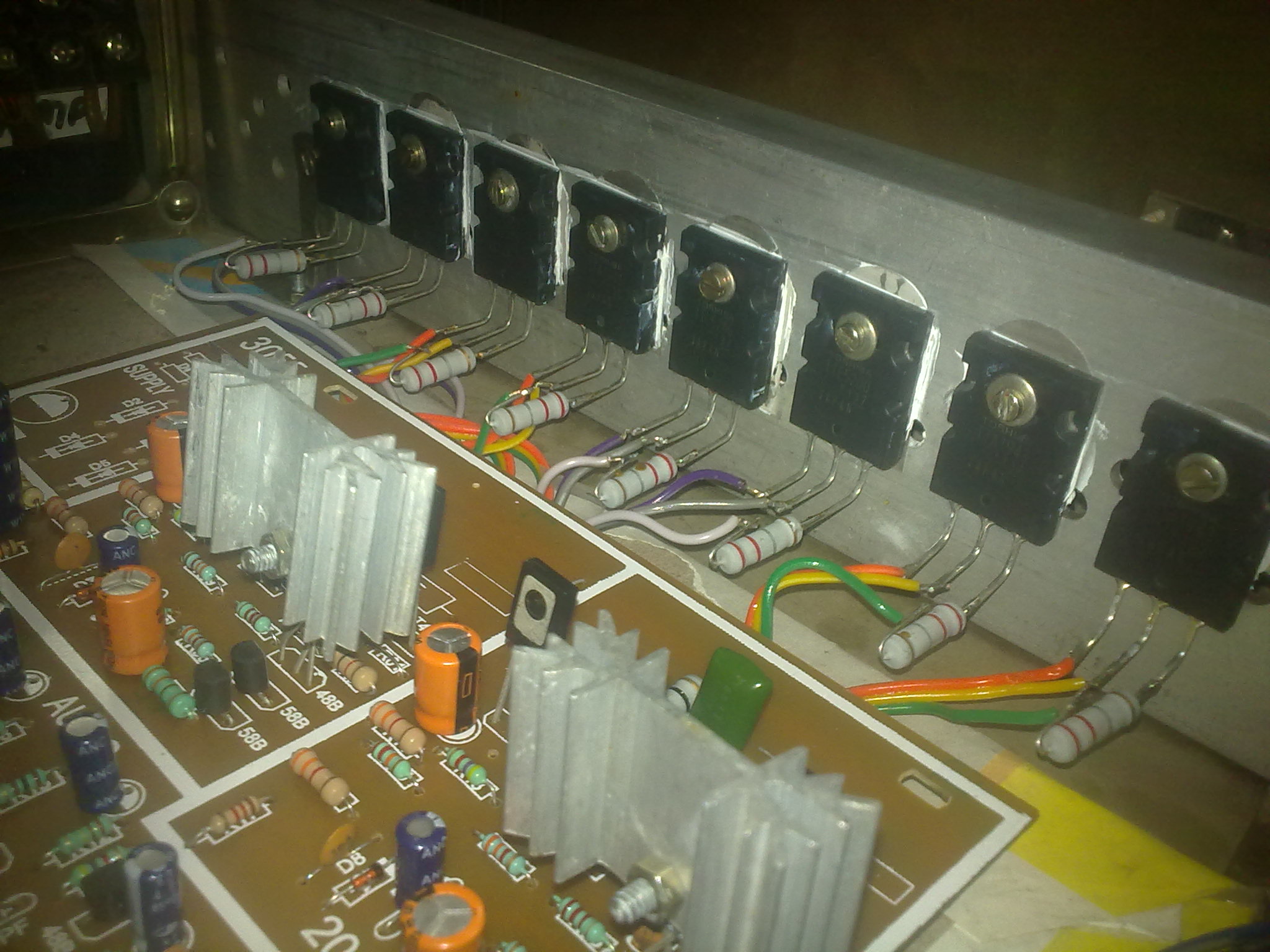

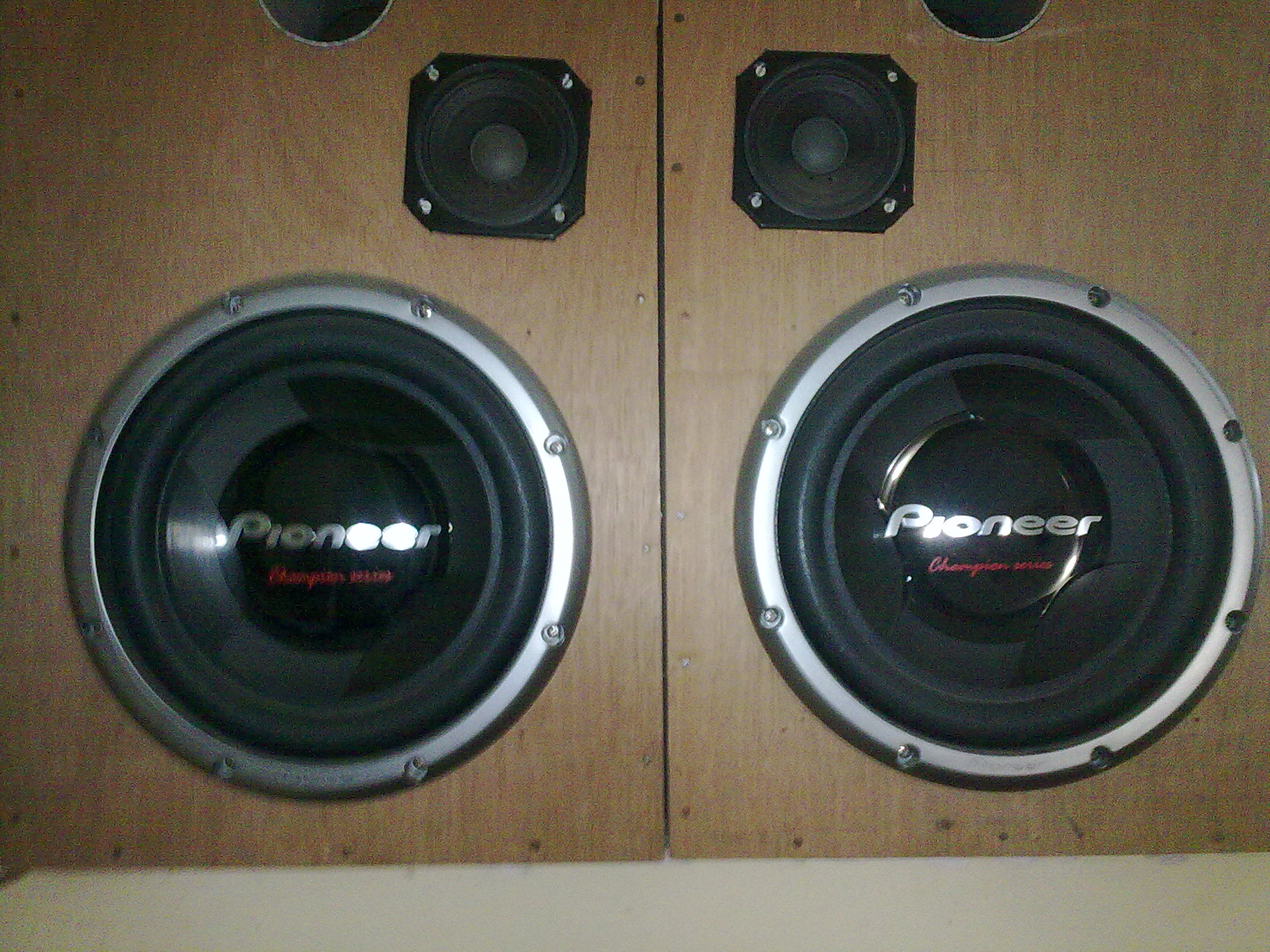

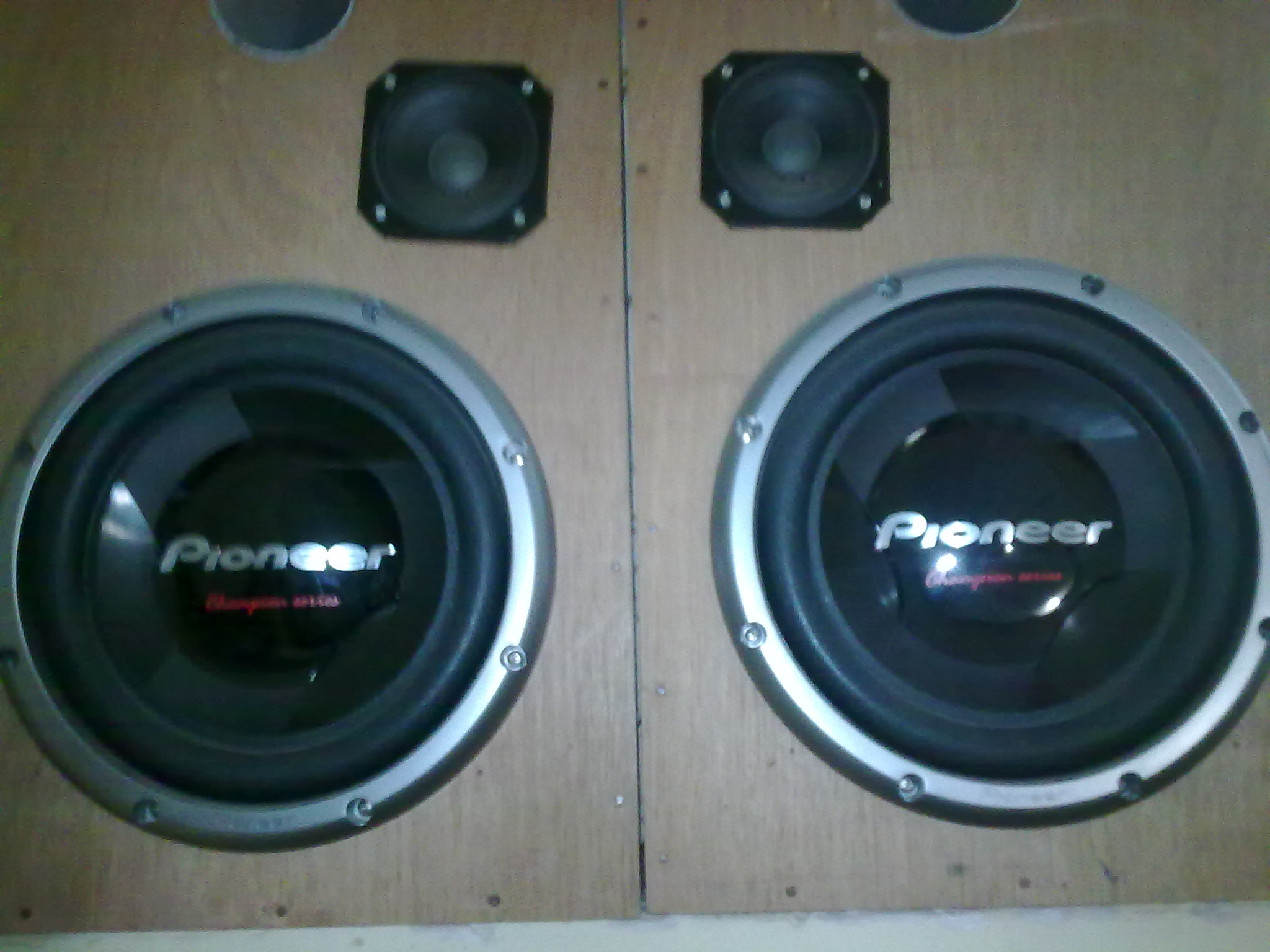

Upgraded my amp
upgraded my amp using 2 pair of output devices (now 2SC5200/SA1943 earlier 2N3773), and the result is fantastic, more clean tight bass, crisp mids and highs, and even could feel more power. Attached are the pics, would upload updated schematic later.

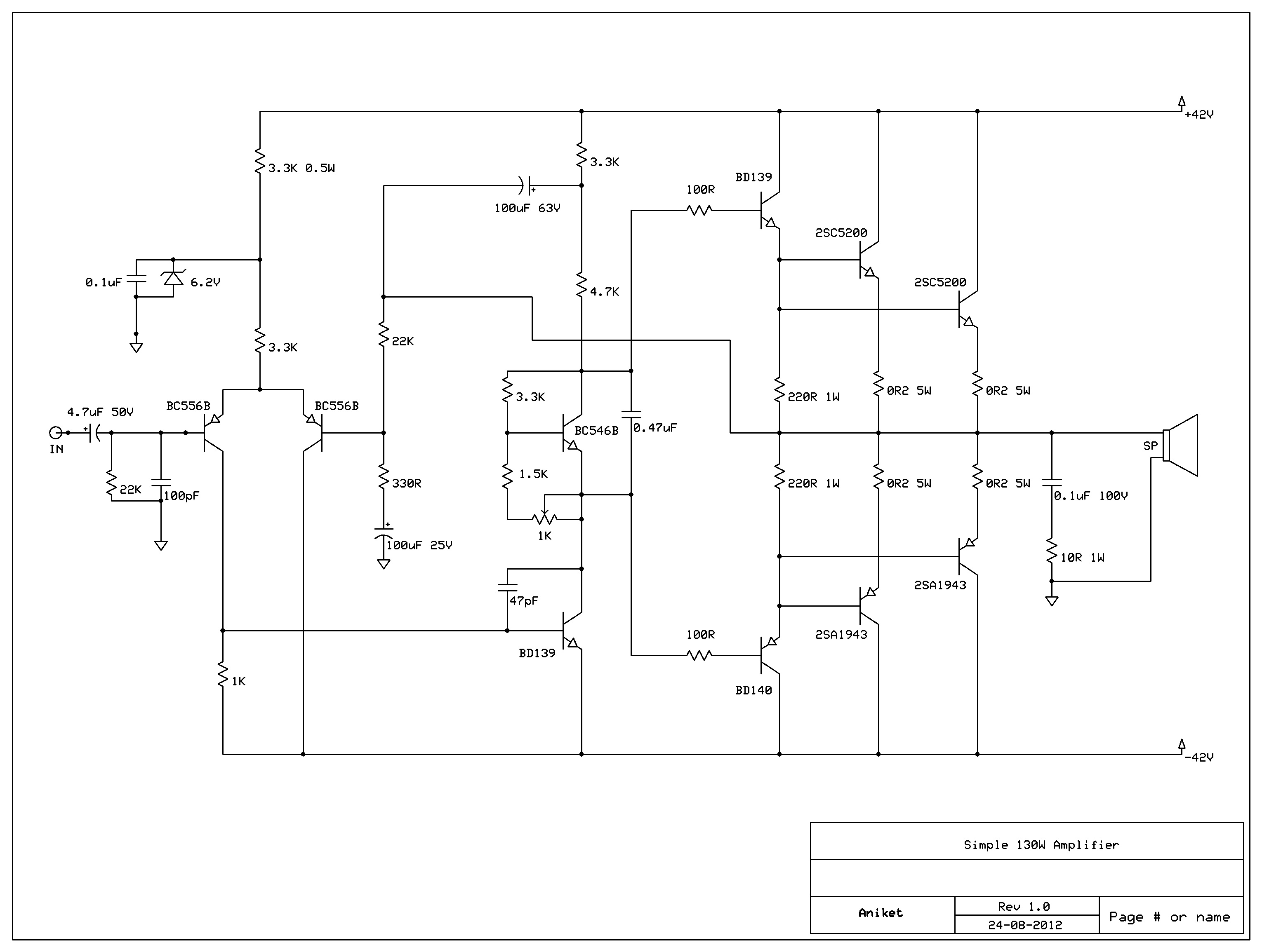

Updated Schematic
attached is the updated schematic, i did some changes, got 1mV at the output, and bias is set at 25mA, amplifier runs very cool, sounds great and punchy🙂🙂

25mA across Re @ 0r2 is 5mVre.
This is exceptionally low, for an EF stage.
You may find that sound will improve by doubling and maybe quadrupling the output bias currents.
But, will your heatsink be big enough? 2pr @ 100mA and +-42Vdc, gives Pq~17W
Add local decoupling both at the output devices and on the main supply rails.
Add degeneration resistors to the LTP.
Add a trimmer resistor to the 3k3 (lower one connected from Zener to LTP). This trimmer to set LTP in balance.
Add degeneration resistor to VAS
Add a third 3k3 in the supply to the Zener/LTP. The Zener can manage with a bit less than 9mA. Or try splitting the upper 3k3 into two off 2k2. Then add a smoothing cap between the 2k2 for extra filtering to the LTP tail. 10uF to 100uF would do.
If you feel you must run at lower bias currents in the output stage, then double the emitter resistors to 0r47. This will allow ~45mA of bias through each pair for near optimal ClassAB.

Andrew's suggestion of a VAS emitter resistor is interesting ( I presume as that would degenerate the VAS ) . This can be up to 22 R as a rule of thumb . One amp I built recently was 16R . What you might hear is that the sound is punchier at 0R and softer as the resistance increases . A friend I built an amplifier for definitely preferred 0R . My quick guesstimate is that 4R7 will be about the trans-conductance point , l assuming gain to be about 100 for the BD139 . I suspect the critical values to be 0R 4R7 and 10 R . As your VAS current and voltage is low you might find a higher gain transistor for this application . I think 2N5551 would be OK ( often about g = 150 ) . Sanyo have excellent devices if you can get them . As you have 47 pF VAS cap I think it will be OK . The BD139 will be adding to that . You might start with 68 pF if trying something new as a precaution . Looking at the difficulties of changing a transistor a small emitter resistance seems an easy option . One other transistor is MPSA 42 . It's gain is lower so a higher value emitter resistor might be required . It has a good reputation and is cheap .
Technically speaking some say a VAS resistor is a bad idea as it reduces available negative feedback to correct crossover distortion ( as does the VAS cap ) . This is true . I find if a little is used and trans-conductance is reached or slightly exceeded then IM distrotion is lower . A trade between IM and crossover distortion is a nice game for the ears .
I like your bootstrap constant current source . Generally the 100 uF costs as much or more than a BD140 . How many have ever tried one ?
Study the Quad 303 output stage . It works very well . It could be adapted with extra output devices . The Quad can work with only 10 ma standing current . Rotel used 44mV @ 0R22 to set bias = 20 mA .

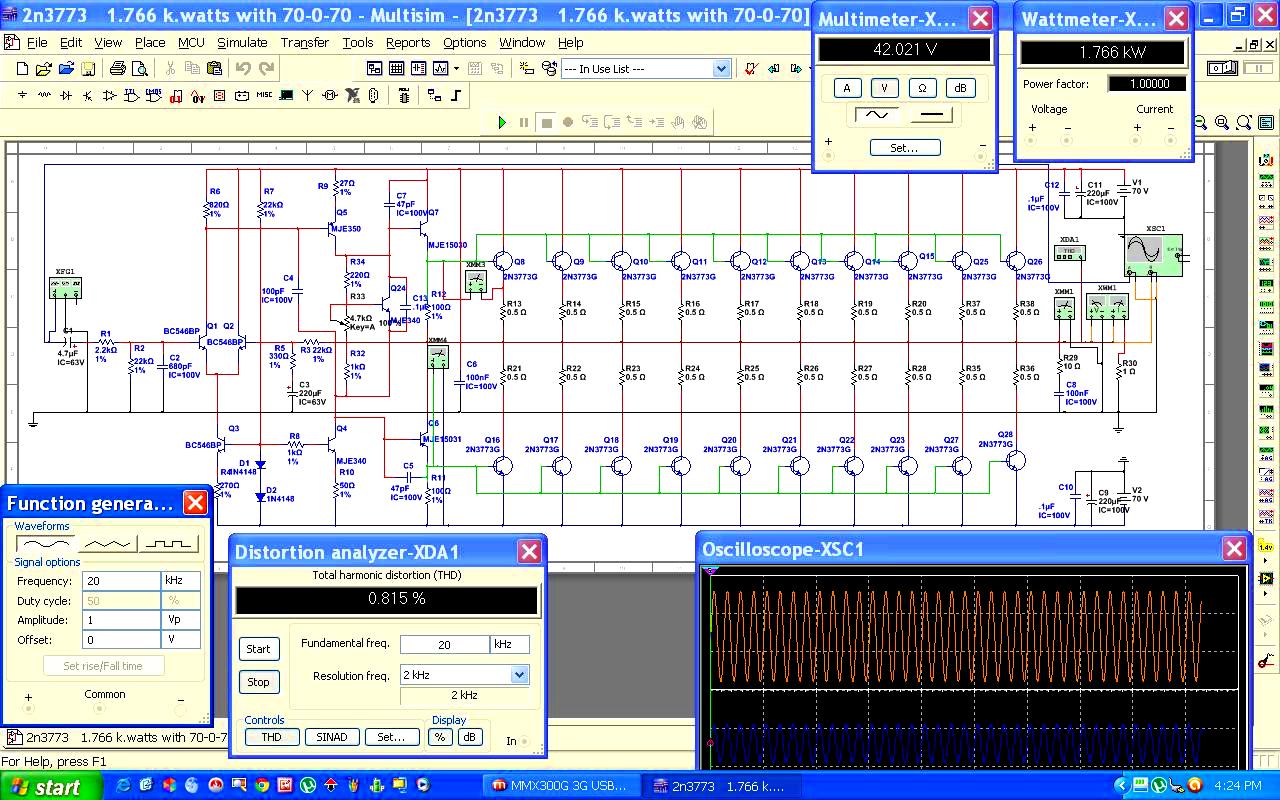

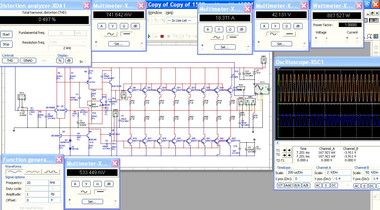

2n3773 10 pairs 1.766 k.watts with 70-0-70 volt d.c. output can put upto 1 ohm2n3773
Same circuit now further modified 2n3773 10 pairs 1.766 k.watts with 70-0-70 volt d.c. up to 1 ohm output Load
