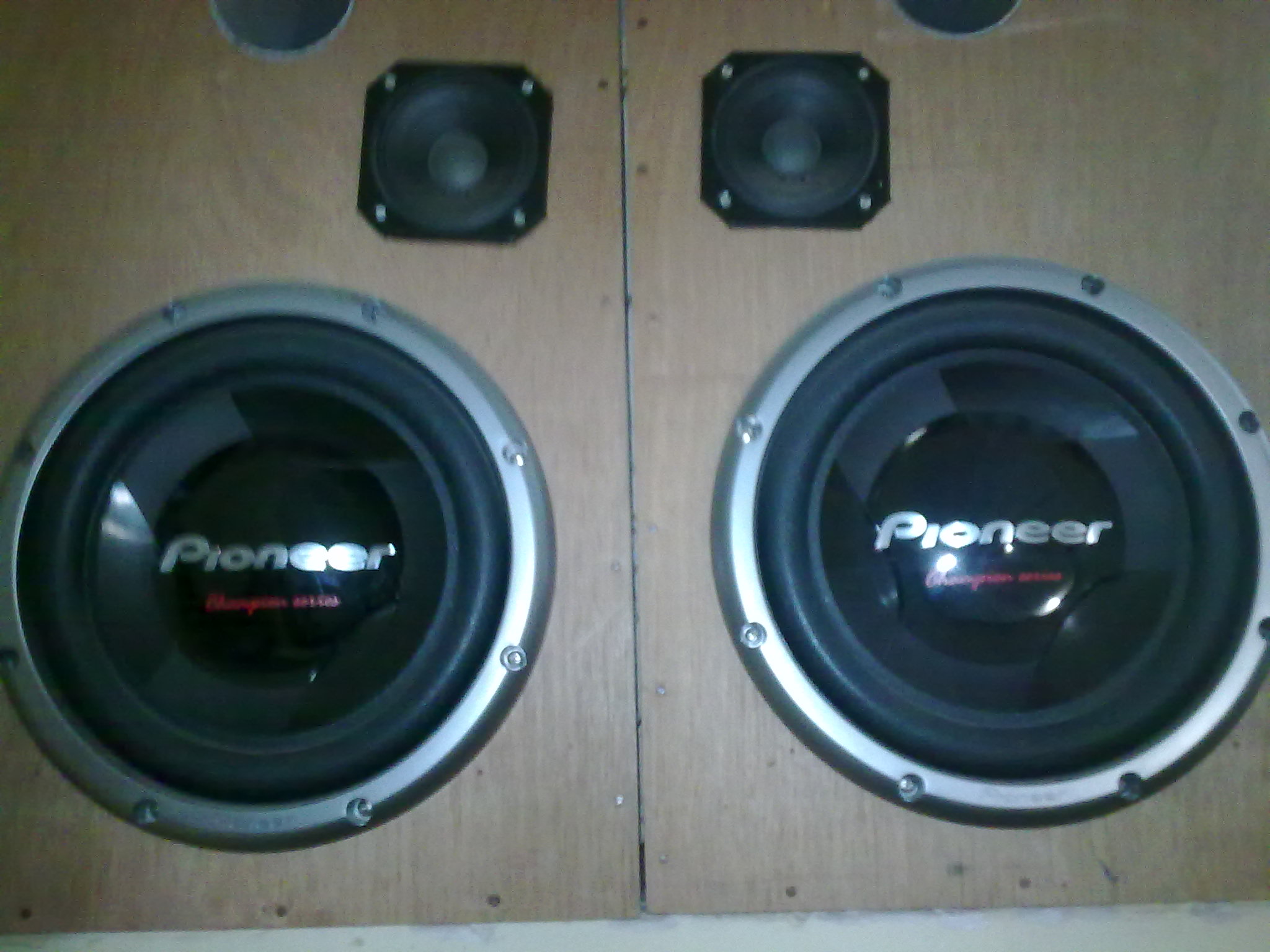

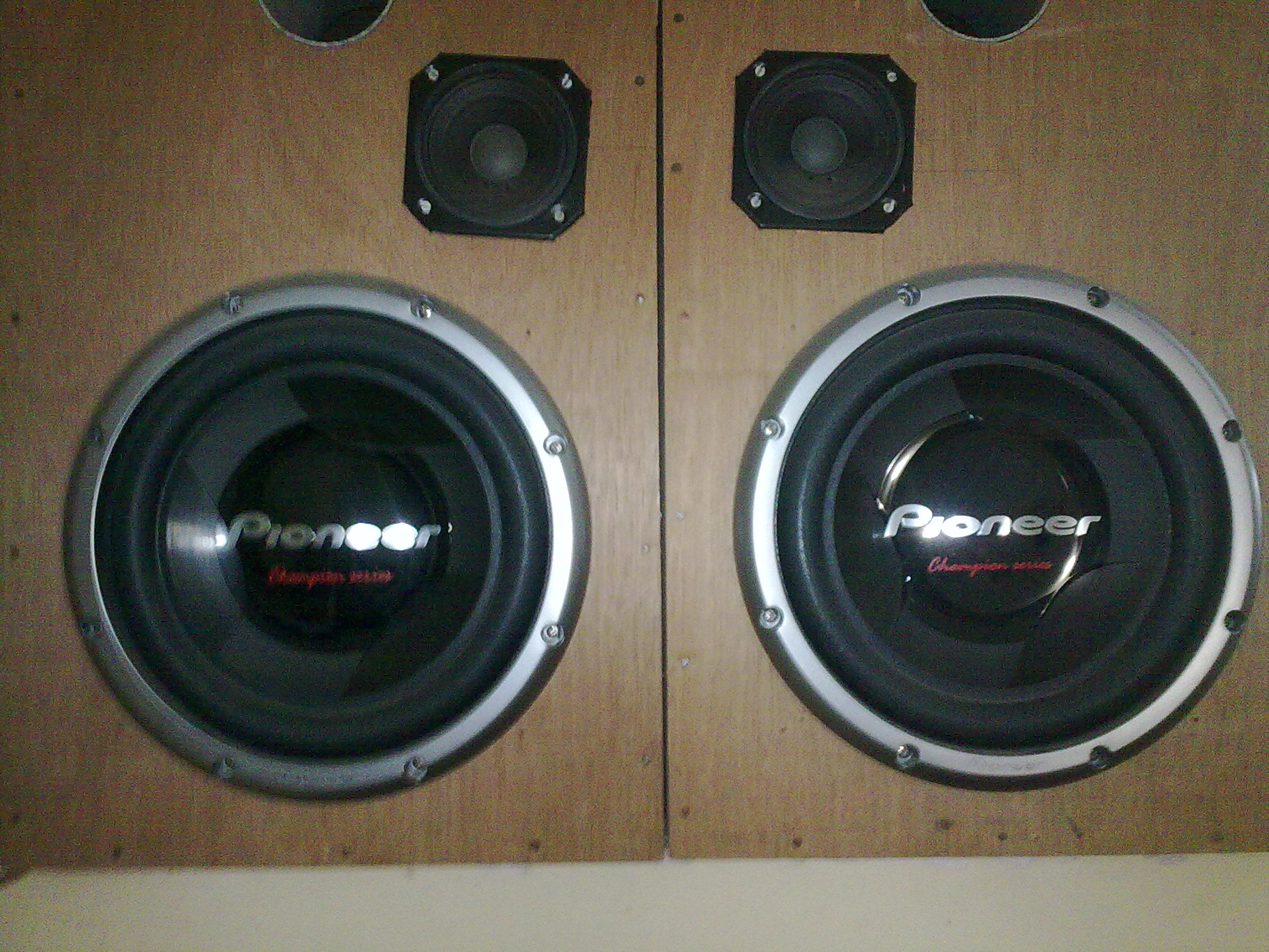

i must tell that i m driving a Pioneer TSW1208-D2(400W) Car subwoofer and Audiopro 4" tweeter rated at 50W, per channel for full range setup. I made my speakers using this setup

My speakers powered by my 100W amplifier
My self made speakers and videos of my system pumping some bass
Bass will destroy you 2X Pioneer TSW1208 D2 - YouTube
