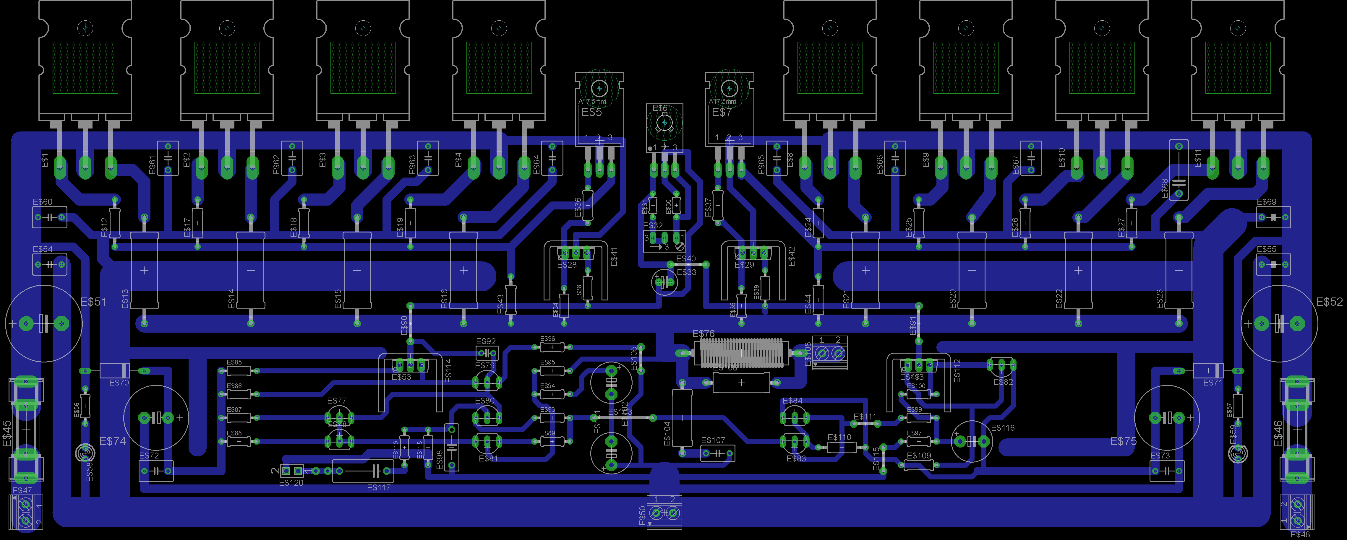

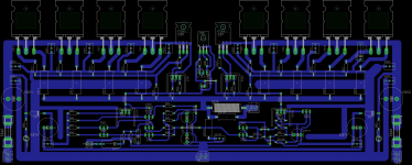

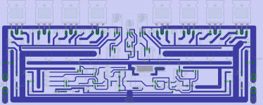

My first PCB
Inspired from Alex MM, i designed a PCB for my amp. The circuit is a bit modified with feedback current sources for LTP and VAS. this is my first attempt to design a PCB😀. Parts numbering needs to be done. I made only the layout first.🙂
I am not an expert but I doubt those ground rails has run too complex,why not use more refined star.
I hate to hear that tiny bit of krrrrrrrrr sound in speakers when input is grounded .

it's just a attempt for learning. i have designed a new PCB in Sprint Layout with dedicated star ground.
Currently, i am using PCB's designed by AlexMM, and they are great. amp is dead quite, no hum hiss or krrrrrrr, even without enclosure or chassis.
Star is like the perfect partner in life . It is more of a concept than reality . The thing I will have to use soon is a Ground-plane . I think to make the top PCB layer copper ground is OK . That is to do the opposite of Star . That is it makes the resistance so low that the nasty layout does no harm ( oh that it was so simple ) . The Bus Bar works well and is easier to be certain it is working . Just swap things around for low noise is not a bad way to do it . Be careful , hum which is low in harmonics and slightly higher in amplitude might sound nicer . Rotates transformers to do that also . If it goes from - 86 to - 82 db 50 ( 60 ) Hz and sounds nicer at - 82 dB it might be that the 150 Hz is lower ? You might find it was 150 Hz - 86 db and then - 92 dB . What you might find it is a warmer sound with better openness . Truth is we hate 150 ( 180 Hz ) ? Largely speaking 50/100 ( 60 / 120 ) is what we hope for . 50 Hz hum is OK , 60 Hz is more intrusive !!! I plan to use 40 Hz one day . It is the limit of what transformers do well ( up rate by 50 % at a guess ) .

I've been using a ground plane like forever, for at least the last 15 years or longer. People shy away from it because it requires a double sided PCB, with the whole through hole jazz packed in one deal, but they forget that:
1. It gives the ground an exceptionally low impedance, not possible in any other way,
2. It improves the S/N ratio typically by about 3 dB (although this varies), which is not to be scoffed, even if not quite a revolution,
3. Reduces problems with stray capacitances al least to a part, also succeptibility to RF interfearance and
4. Allows for more dense parts packaging, and in a competenet design (e.g. by Alex), it completely does away with any wire connections on the PCB.
So Nige, definitely, by all means, do go for the ground plane.
