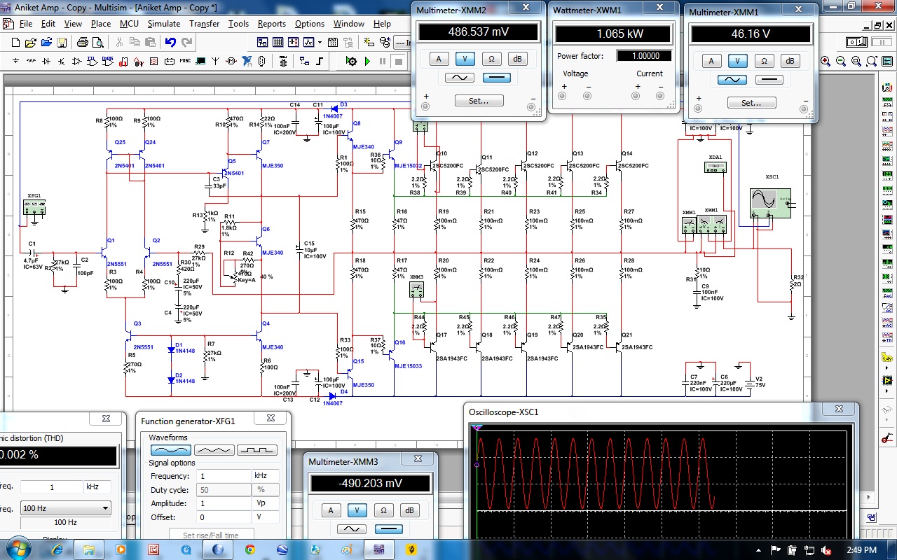

Nice work done Aniket,
Can you please post multisim file and sprint file of your this final modified version, one more question, how did you get 2sc5200 and 2sa 1943 model files , and njw also.

Thanks Sir,
I am using Multisim 13, it has models for almost all Onsemi audio BJT's.
Models for 2SC5200/A1943:
Toshiba:
.MODEL 2SC5200 NPN (
+ IS=3.0463E-11 BF=96.20 VAF=100 IKF=15.04256 ISE=5.6190E-11 NE=2.0 BR=4.849 IKR=1.05012 VAR=100 ISC=7.18E-8 NC=1.5 RE=0.0025
+ RB=20.18 RBM=0.0014 IRB=1.0E-7 RC=0.01137 CJE=4.5000E-10 CJC=8.4915E-10 VJC=0.68977 MJC=0.54081 TF=6.8583E-10
+ XTF=9.5721 VTF=10.425 ITF=6.8697E-2 TR=1.000E-8 XTB=1.45 EG=0.82 FC=0.5 mfg=Toshiba)
.MODEL 2SA1943 PNP (
+ IS=1.30E-10 BF=91.42 VAF=100 IKF=4.480 ISE=1.02E-10 NE=2.0 VAR=100 ISC=5.0900E-9 NC=1.5 BR=0.882 IKR=2.9015 RE=0.0011
+ RC=0.0553 RB=140.05 RBM=0.0041 IRB=8.5e-9 CJE=2.00E-10 FC=0.5 CJC=9.45E-10 VJC=0.48 MJC=0.28 TF=9.250E-10 XTF=10 VTF=10
+ ITF=1 TR=1.00E-8 EG=0.76 XTB=2.68 mfg=Toshiba)

Simulation and sprint files are attached.

Thanks Aniket,
for multisim 13 files and models of 5200 and 1943, I have tried to modify your circuit, Now with lowest distortion from 20 hz to 20 khz and more output voltage wattage, i will be thankfull if you can post 4793 and 1837 models and include them in a multisim file so can be easily saved. attached is modified.

here pdf alslo
Hi Aniket,
Here is pdf also of your circuit now modified, I am on facebook https://www.facebook.com/vedmitraa

Hello Sir,
It could be improved a lot more. simulation models for 2SC4793/A1837 could be saved from the attached simulation file.

Thanks Aniket,
for files, will you please modify the multisim file I sent for better output voltage, with lower distortion from 20hz to 20 khz , better load capacity.

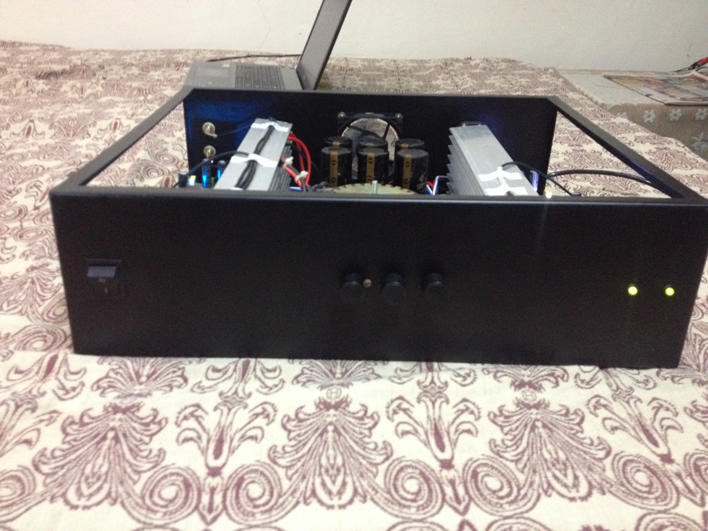

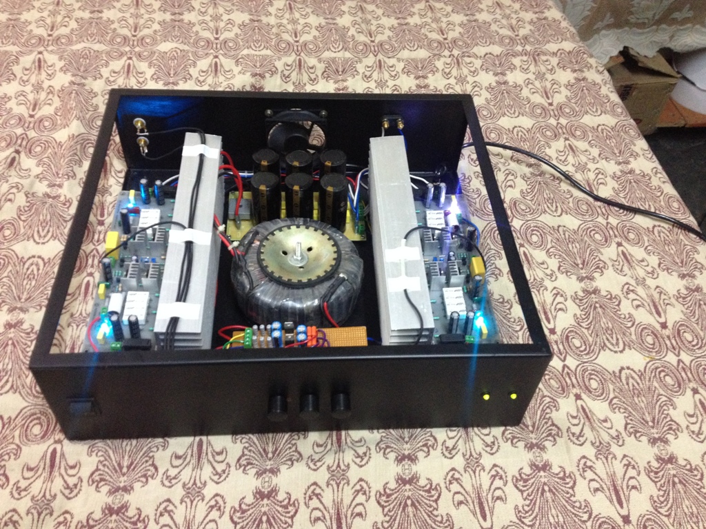

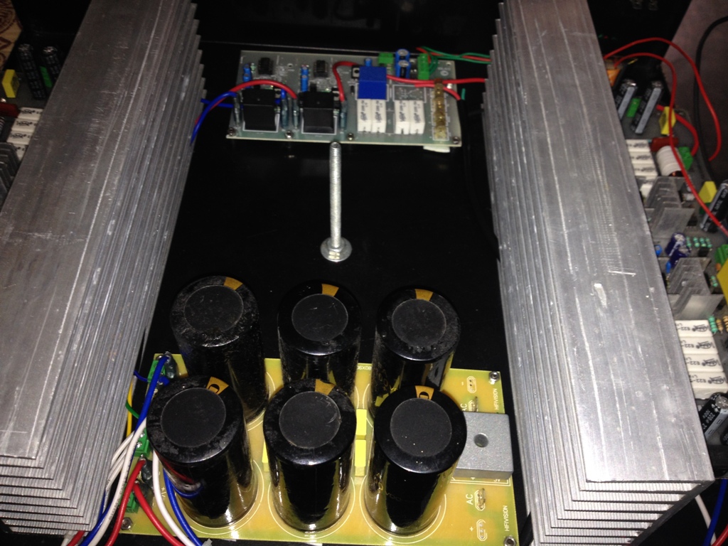

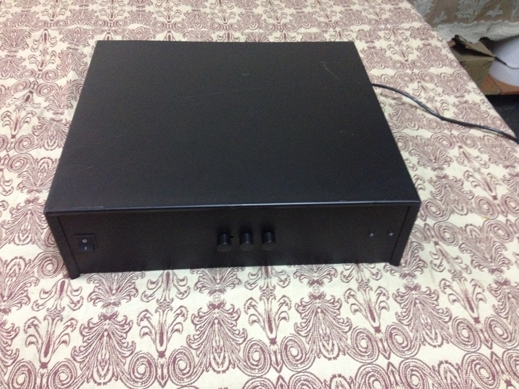

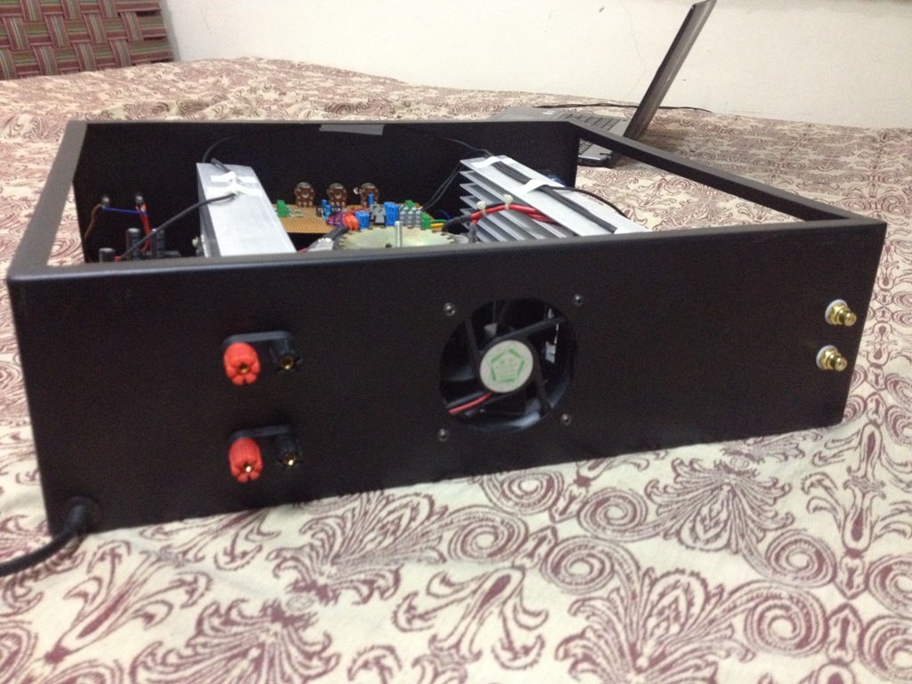

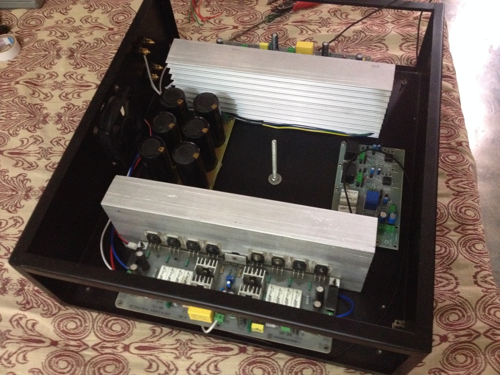

My new build, used a 45-0-45, 750VA toroid and 3x15000uF caps per rail. output devices are njw3281/1302 in place of 2SC5200/A1943, replaced MJE340/350 with KSC3503E/1381E in VAS duty. with these mods amp puts out 300W+ per channel into 4 ohms.

Nice work Aniket, pity the heatsink fins run parallel and not vertical.

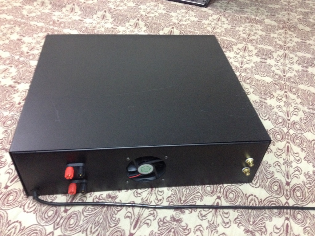

Are there air vents on the sides of the enclosure, I see a fan pushing air into the enclosure, (btw I believe the primary fan should blow onto the circuit and not pull air away from the circuit.) But there are no entry points for air visible.
Would be great if you had two fans blowing into each heatsink 🙂
But you can judge by how hot the heatsinks get when playing music for a hour or two with the enclosure closed.
lol, I hate it when other people criticize another man's hark work, this is not my attention.

Hi Aniket. I am building a similar monster amp closer to the Quad 303 ( MJ15015 ). I too must run the heat sinks this way. If you spray paint them black except the transitor area you might loose 10 % more heat. Some paints are designed to etch and cover. Even grey works! My one 90 watts for now.
Very nice work.

Thanks All,
Air vents are on the sides of the enclosure, I placed the heatsinks in a way that they form a tunnel for the the air to flow between them, thereby cooling them. fan is to exhaust hot air outside. i could feel air sucking in through vents.
I had ran the amp at high power continuously for 2-3 hrs several times, never got the heatsinks more than just warm, never felt hot air from the exhaust fan. bias is 50mA per transistor.
Preamp i used is Rod Elliott's P97, made it on a veroboard, it's a very good sounding preamp, credits to Rod for the excellent but simple design.
