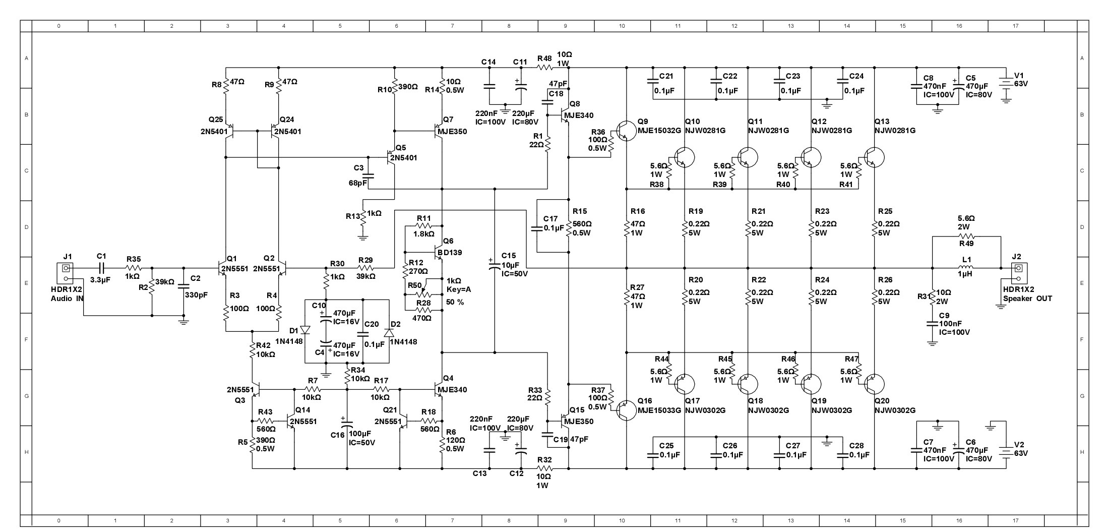

New schematic

Why use the oldest version of Motorola's power transistors? Even a brief simulation, let alone audtion, will easily show that MJ 21193/21194 trannies are vastly superior, while costin about the same.
Also, why still only one pair? The speakers are nominally 120W/4 Ohms, so we have to assume impedance dips down to 2 Ohms. One pair WILL struggle with that, I guarantee it. Using two pairs will reduce the overload problem and we double the damping factor, again, not insignificant when dealing with low impedance loads.
Also, why a double Darlington (driver-power), why not a triple Darlington (predriver-driver-power)? That reduces distortion, exteneds the bandwidth and reduces output impedance. At these voltages, the predrivers could be simple BC 639/640?
Then, why not add a simple, single say BC546B trannie to act as a buffer for the VAS BC639? Another tried and proven technique ...
Also, why not a current mirror for the input stage? One of the most effective ways to deal with even order harmonic distortion, AND keeps the DC offset low.
Of course, by then, we have a new amp on our hands.
So, I would advise Gost22 to use the design Bob Crodell provided in his book, he has one exactly like what is needed, and in addition, he uses two pairs of Motorola MJL 21193/21194, the plasit pack version, and thus easier to install and solder directly from the board, no wiring needed. It's on page 70. Just add a series fuse at the output.

It is a bit like a Formula one racing car . You have to be cautious . We have charity shops in England . I buy cheap but OK speakers for $15 so as to be safe when trying the limits of performance . The turbo charger analogy is a good one . C9 100 pF is almost the waste-gate of the turbo . The waste-gate of most turbo chargers is set at 0.7 Bar . The majority would easily give 4 bar ( tryes are usually filled to 2.2 bar to give an idea ) . The designer will always try to use the 4 bar as it comes for zero money . The amateur tries the same and the engine is lost in 10 minutes . As C9 is made smaller the turbo is turned up . Long before disaster R 27 10 R will get very warm . Some op amp power amps like TDA 2030 use 1R . I would change yours to 4R7 3W .
The raising of gain is totally positive except one thing . The DC offset will double . If it is below 100 mV I wouldn't care . Also you seem to have an adjuster POT 1 ( some will think PTC thermistor ) . I like POT 1 . With the low current you are using it might be reduced to 30R ( use a shunt resistor is easiest , also makes it safer if the pot fails , use 43 R across the pot ) . 1.875-0.7/750 = 1.5 mA . That is 0.75 mA per transistor , the re = 35 ohms ( the internal emitter resistance dependent on current ). I usually ask total Re ( Re + re ) to be 50R per device .
I suspect if the layout is good and high grade transistors C9 might drop to 27 pF before any big distress if the loop gain is increased ( 470 R6 ) . If that is done 47 pf should be safe . Personally I never had a problem with this that wasn't obvious and never can remember loosing the amplifier . I get close because I need to know .
R3 is slightly mismatched with TR5 . This will produce the very nice second harmonic distortion . This is like saying to someone don't drink sweet wine . The point is you might like it less sweet . Well driven TR5 will be 0.6 V base emitter loss. If you increase TR5 from your 6 mA to my 8 mA current that makes R12 loss 47 x 0.008 = 0.38 V . Call the total loss 1V . 1V / R3 = 1 mA . That means the input pair is imbalanced by 2 to 1 . If you make R3 750 R that is 90% balanced or better . However that 1 mA was no bad thing . It is a choice and we have to use God's measuring equipment for that ( ears ) . I will post a super brave version if you are willing to buy those cheap speakers .
BTW . Love your amp . It is exactly the right thing to do . Velleman have a kit something like it .
35 V +/- PSU is excellent . 22 000 uF 40 V power supply capacitors are cheap even in computer grade .
Notice I have moved C10 ( as now ) to a 220 pF starting point . COG or NPO ceramic .
Try first R10 as zero ( 0 ) ohms using your ears to judge it's sound . In theroy this is best especailly if ZTX694B is used . It has a gain of 500 which sets Z in as about 1K5 without R10 to assist . That suggests to me R10 is optimum at about 2R . If BD139 R 10 optimum is about 30R . The textbooks say R10 should be 0 . I slightly disagree with them .
The current mirror allows any change to work . It automatically adjusts . Text books say add two resistors . You can if you like . Compared to before it will be better regardless . My experience is you will never equal BCV 61 if you make it yourself from two transistors . Do not think it's low voltage is a problem as the T6 protects it ( 1 V clamp ) . If you wonder could the BCV 61 be made from a diode and and transistor , yes it can . The advantage when op amps is the transistors are easier to make inside a chip than diodes. Also the matching is far better if the same device . I usually don't fit the extra resistors because it reduces the Vce margin . That is usually 0.2 V and the base of T6 might be 0.55V . Even though a current amp I don't want to loose 0.1 V . I took this idea from the 741 op amp ( as did everyone ) . Crimson Electronics UK was where I first saw it about 1980 ( 741 circa 1963 to 67 ) .
The Current mirror will increase the slew rate as none of the current is wasted in a resistor . Not having the swamping resistors ( to BCV pins 3 and 4 , 100 R to -ve 40 V ) will slightly increase the second harmonic distortion which is no bad thing . Do you want the sound bone dry ? If you do add the resistors and build a 4 transistor mirror . R10 becomes mandatory if you do .
C10 has been set high as the gain will be dramatically increased in relative terms . I would expect the optimum to be below 100 pF .
It is possible to use low voltage transistors for T1 and T3 as there is virtually zero voltage gain here . These transistors will give lower DC offset as the gain is high . Strictly regulate the voltage if so . C6 will help protect the transistor on switch on . Personally I would set the voltgae to 35 V .
I now have the fuse in the feedback loop . The Zobel network R17 C 18 might better be connected to the node of R15 R16 . You can keep the capacitor as before if you like .

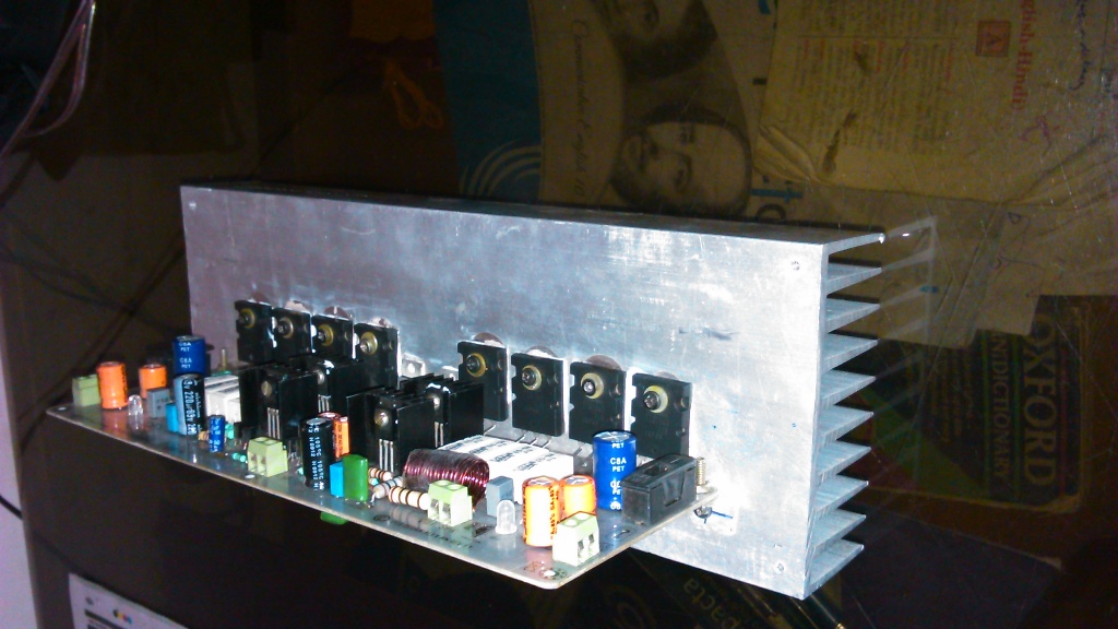

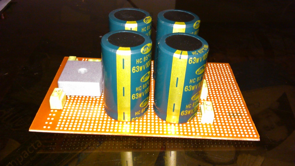

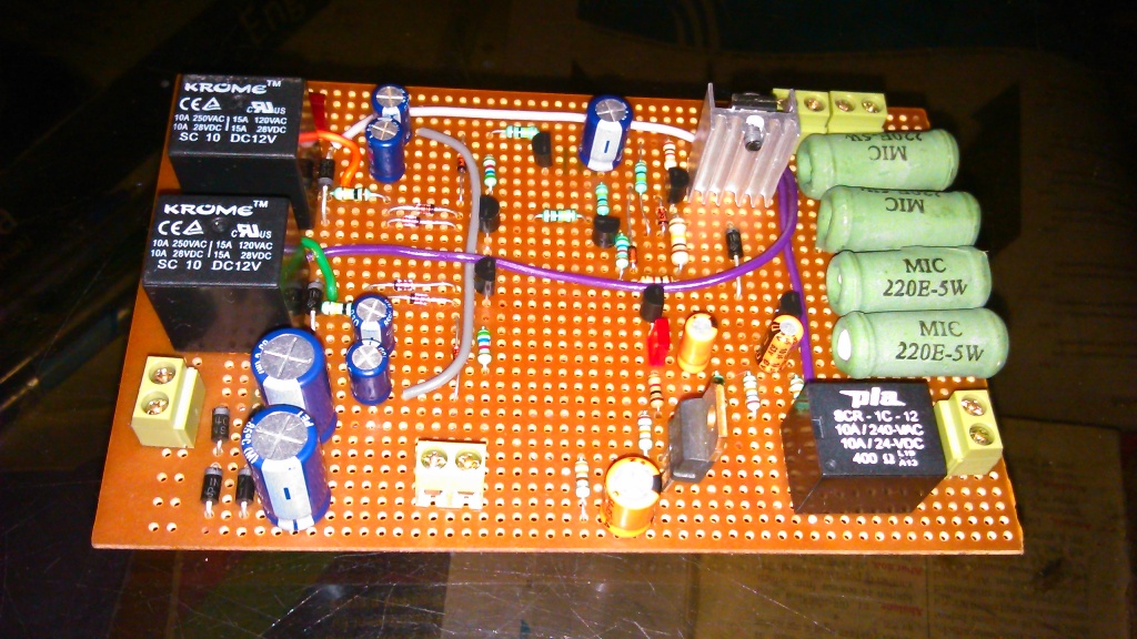

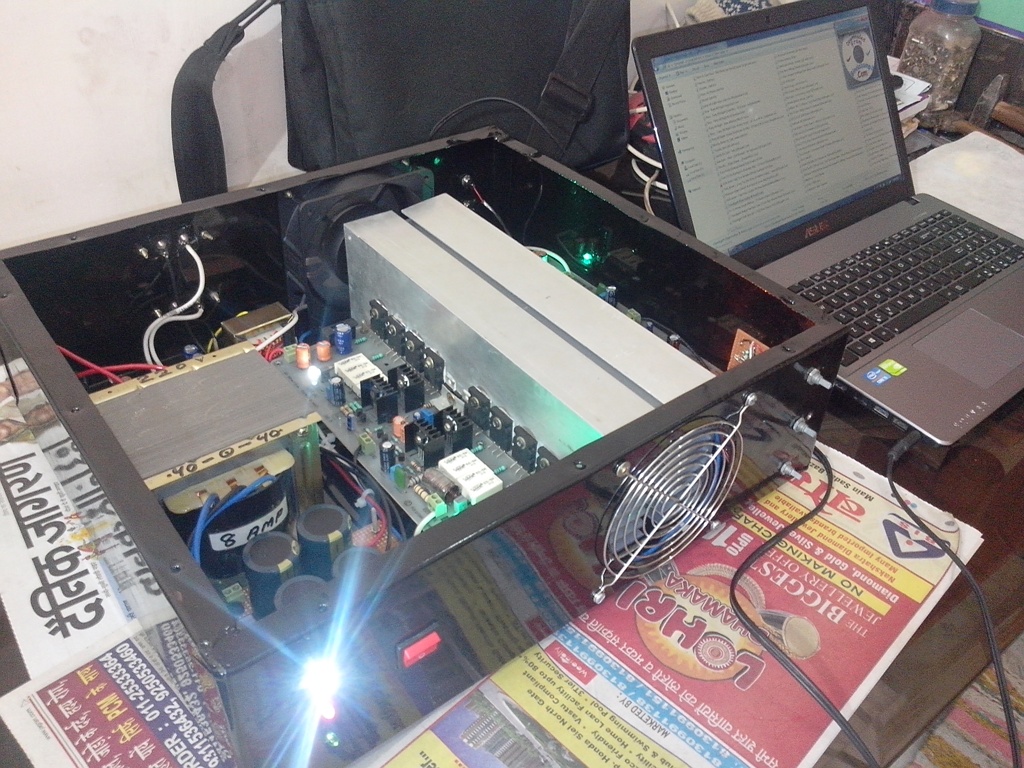

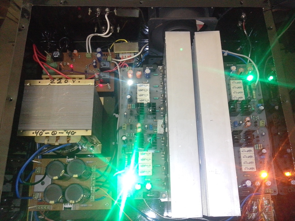

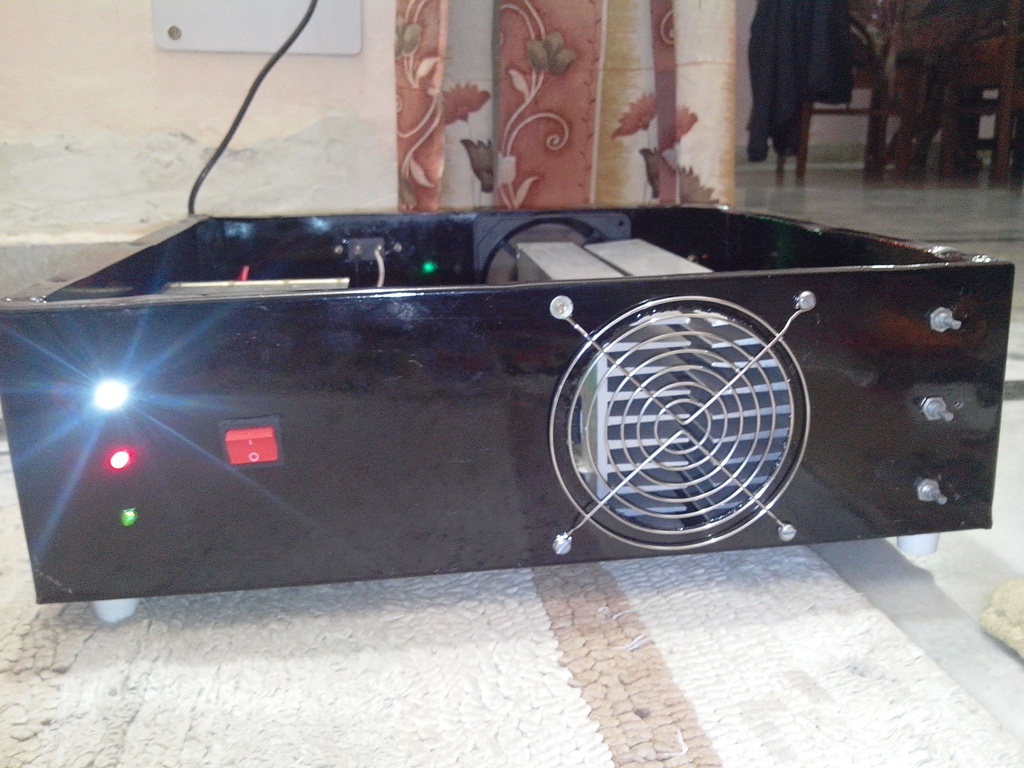

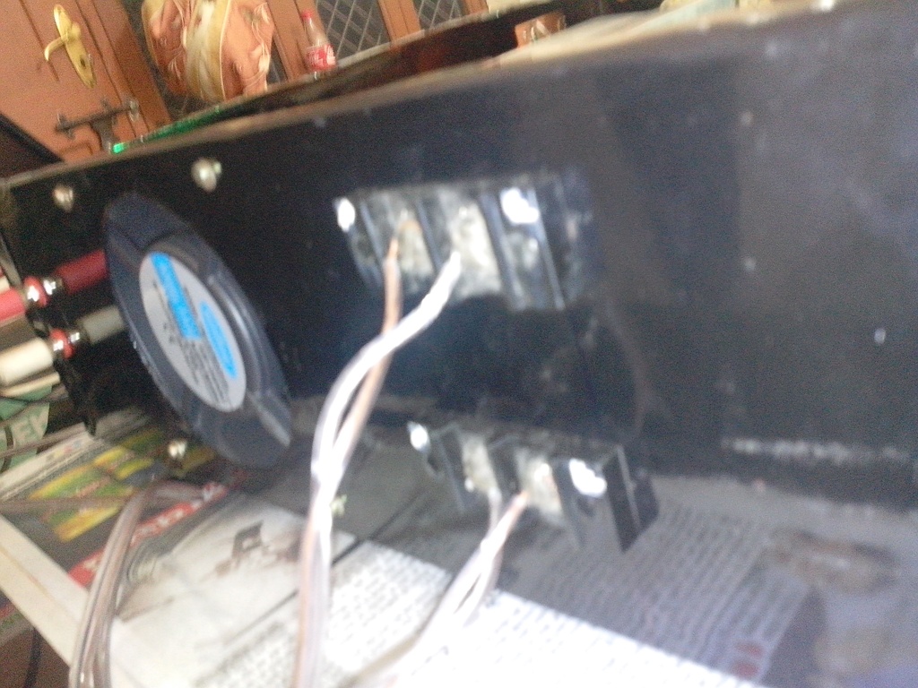

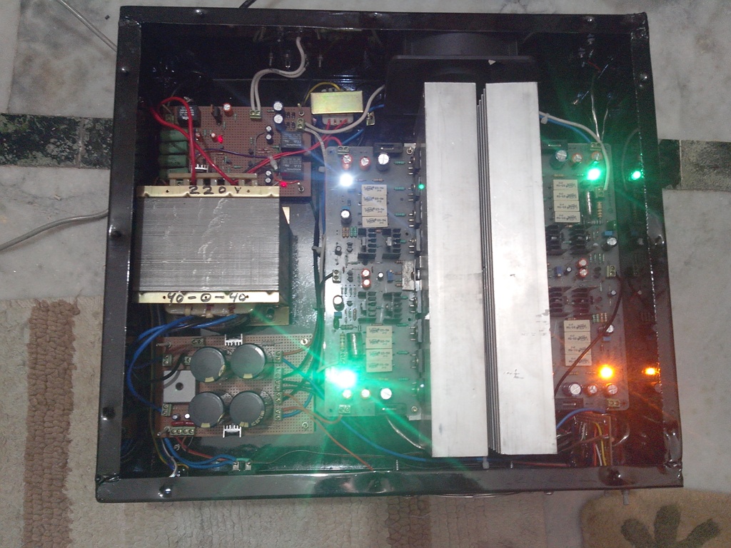

Finally
It's been long since I designed my 250W amp.
Finished the beast at last. Attached are some pics of the build.
Cheers!!!
Cheers!!!

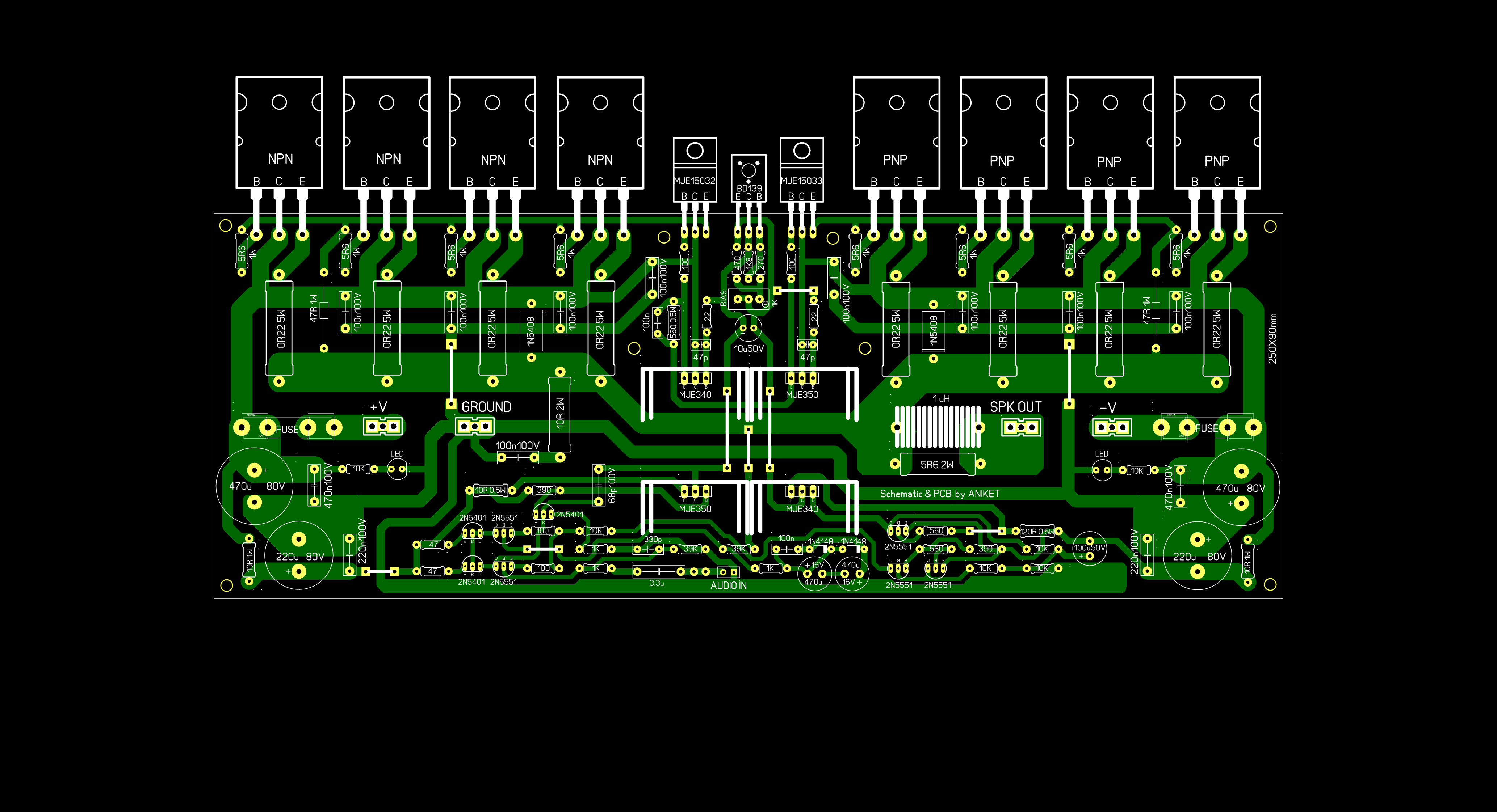

The Signal Ground/Return and the NFB network are shown attached to the Power Ground.
Is that the way you built it?
The signal ground and the NFB ground share the same ground which goes back to the main star ground on the PCB. Infact, lifted ground for the signal and NFB could also be done, it just need a 5~10 ohm resistor which could be mounted down left in place of the jumper.

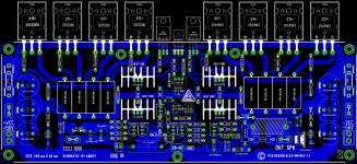

The pics of the amp shown on post #357, have the PCB's designed by AlexMM(attached).
