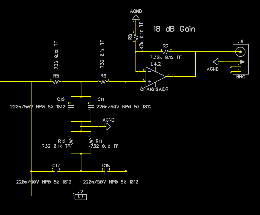

I just got my Silentswitcher and powered it with a 9v battery. It is being used to run an opa1612 amplifying the output of a passive notch filter below. When I do this I end up with about -28.8v on V- and about +1.2v on V+ on the op amp and of course nothing works( when there is no load on the silentswitcher, its +/-15v output is fine).
In the past I have produced +/-4.5v and virtual ground to power it with just an lm4562, 2 100k resistors to the non inverting input as a divider and a 50 ohm series resistor on the output as a virtual ground.
This works fine.
Any ideas what might be unbalancing the voltage on the rails? Can’t I use the ground ouput from the silentswitcher as virtual ground for the circuit below?
Thx for any help.

View attachment 1006403Never mind. User error!
The supply voltage seems OK (30V total) but your ground is no longer in the middle.
Looks like the artificial ground is messing things up.
Now that you have genuine + and - 15VDC, throw out that artificial ground stuff and Bob's your uncle.
Jan

I had replaced my lm4562 virtual ground/rail splitter with the silentswitcher. The problem was me being careless with cables. After I fixed that the power situation was fine.The supply voltage seems OK (30V total) but your ground is no longer in the middle.
Jan
However I encountered a new problem. This was a setup to measure very low noise dacs at 1khz using a quantasylum qa402. It has been working properly measuring dacs with thd+n down to -120db(SMSL SU-9).
When I replaced my lm4562 rail splitter with the silentswitcher, the qa402 started to go into auto attenuation meaning it didn’t like the input range. I had to go from normal 0db input attenuation to 18db attenuation to get it to stop.
I measured the output from the opa1612 attached to the notch filter going into the qa402. 25mvac and 75mvdc(I should block this but the qa402 is ac coupled so it has never been a problem in the past). These voltages are the same as when I used just the lm4562. Something in the power from the silentswitcher is producing this erratic behavior. No idea what could be the difference.
Are there any gotchas I should know about on the silentswitcher?
The SilentSwitcher is just a simple +/-15V power supply.
If you have any issues in your circuits, the best thing is to measure the power supply voltages at the output of the SilentSwitcher, and at the various opamps and see where the problem arises.
Jan
