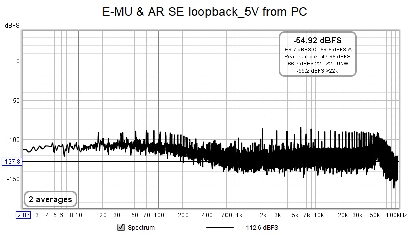

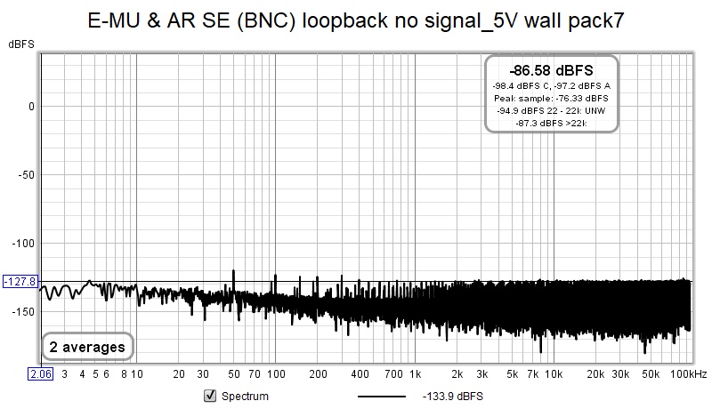

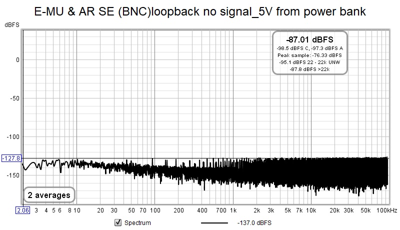

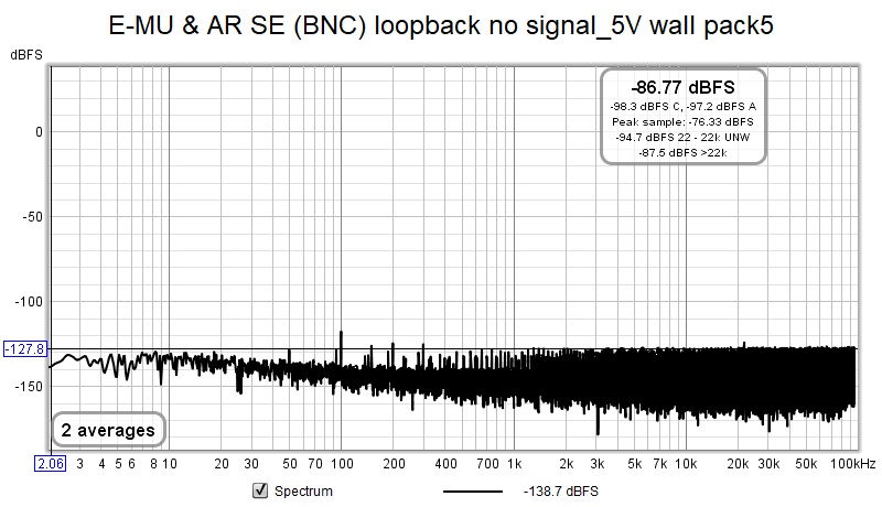

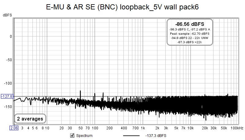

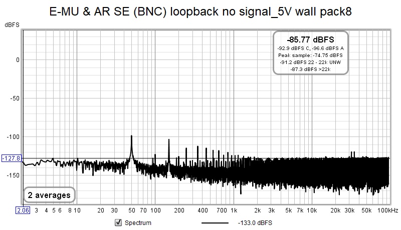

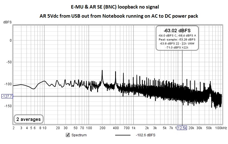

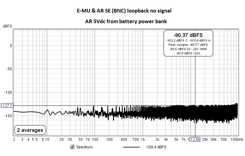

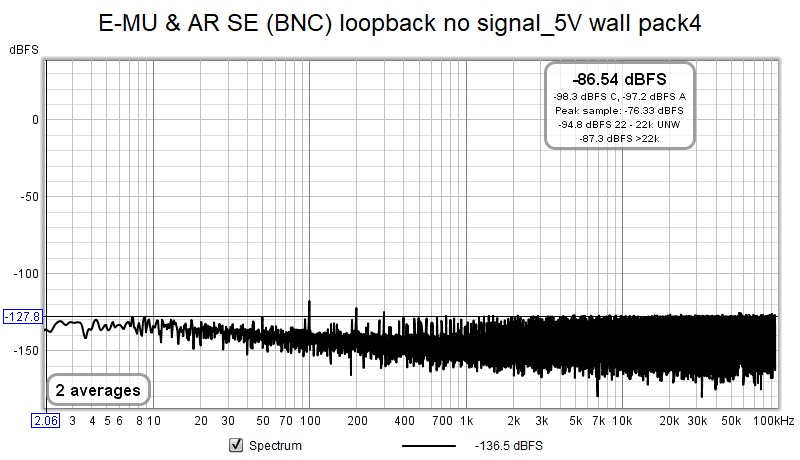

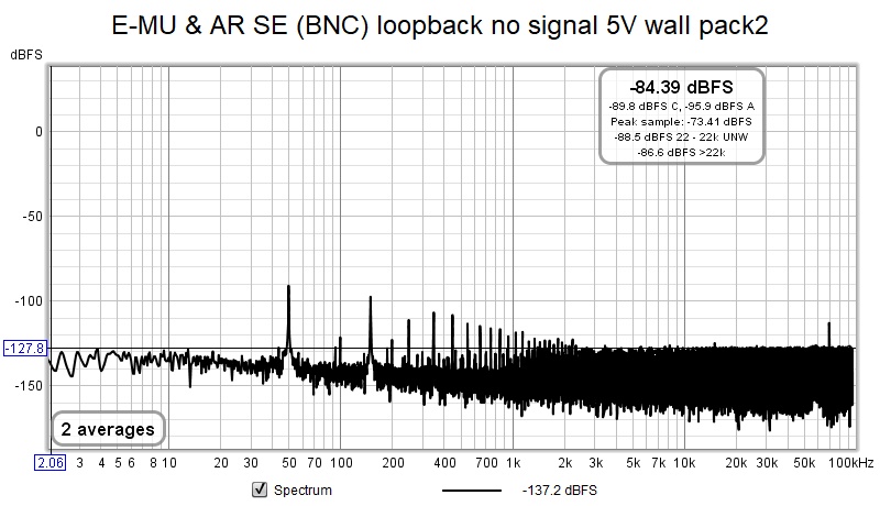

I had a few USB chargers around and it seems that quality of external 5Vdc source does matter.
AR draws around 350mA from it’s 5V DC source. Higher current capacity of 5V source doesn’t equate to cleaner output.
See spurae at the audio output of AR with different 5V sources.
Here E-MU0404 & AR in loopback, no signal.
AR in SEin -SEout.
AR gain +18dB (Auto).
E-MU Gnd Lift sw to Lift
1: USB Charger (0.55A) OLYMPUS Model:F-2AC-3D
2: USB Charger (3A) Schenzhen Jihongda Power Co. LTD Model:JHD-AP015E-050300BU1-C
3: Battery Power Pack (1A out) Powertech Model: PT-802 (10000mAh)
4: USB Charger (1.55A) SAMSUNG Model: EP-TA50EWE
5: USB Charger (0.7A) LG Model:STA-U17ET
6: USB Charger (2A) XIAOMI Model:MDY-08-EO
7: USB Charger (0.35A) Jiangsu Chenyang Electron Co.Ltd Model: 2G61907W240579C
8: USB Charger (0.5A) SONY Model: AC-UB10C
9: USB out Desktop PC Lenovo ThinkCentre M91p with an internal 600W PSU CoolerMaster SILENTPro
10: USB out Notebook TURBO-X with an external 12V/3A PSU
George

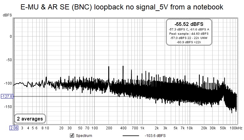

That's interesting George, thanks for taking the trouble.
What I find of note is the hash when fed from the notebook or laptop.
Could it be that in those cases there is a gnd connection between the notebook/laptop and the AR which is not the case when fed from standalone packs?
Jan
Jan
May be Jan. But it's also the HF dirt which pops up at intervals not related to 50Hz.

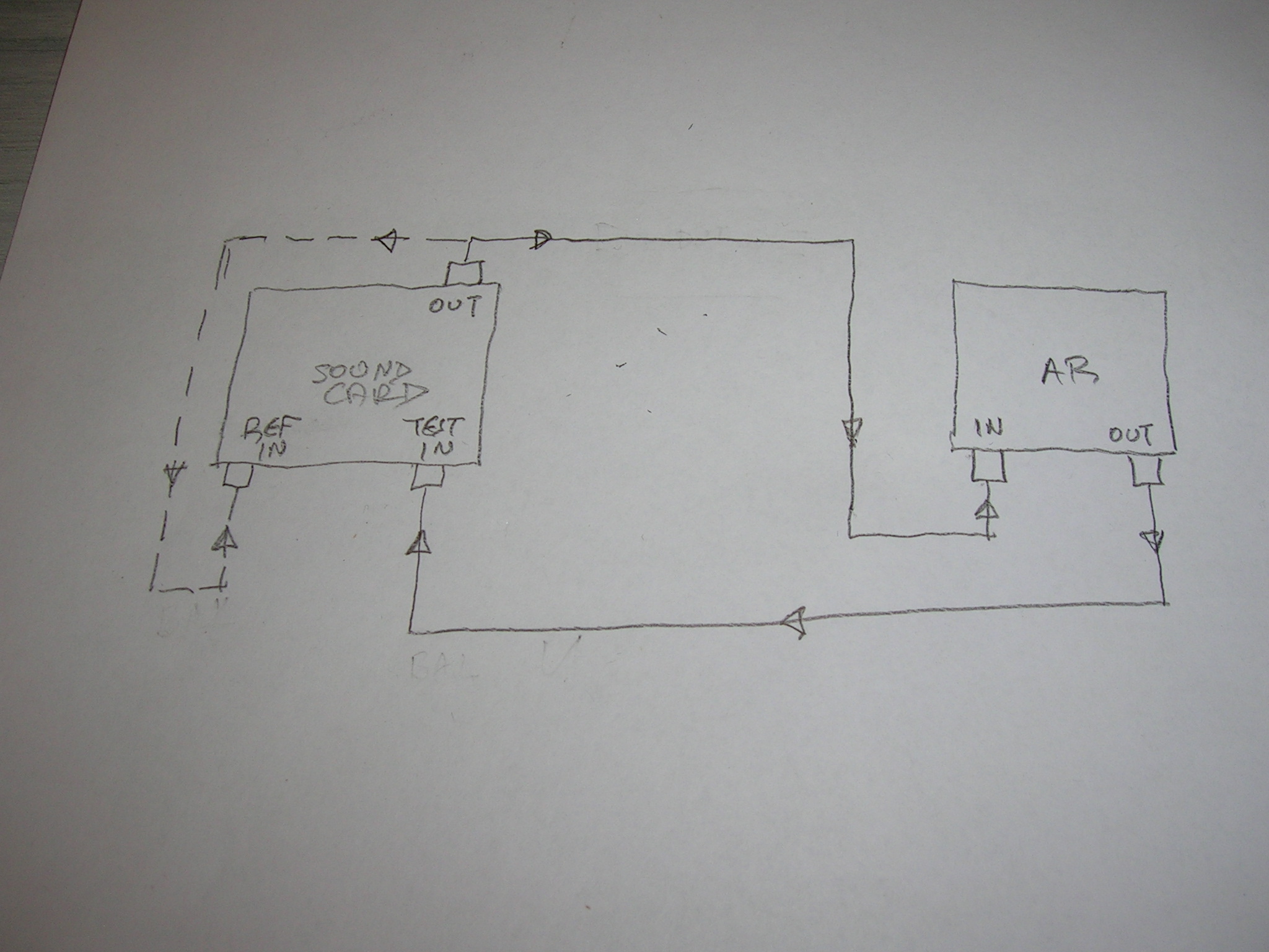

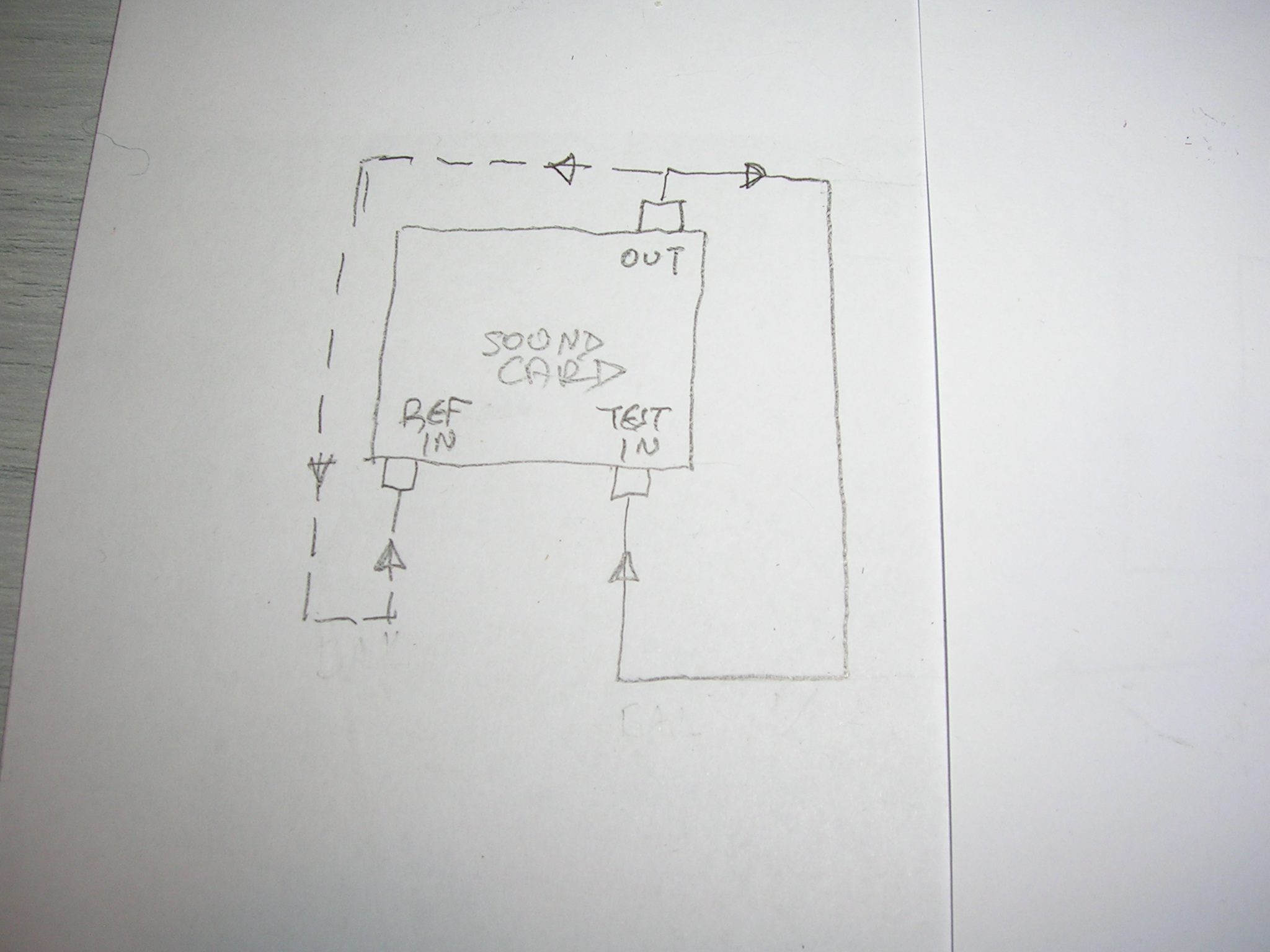

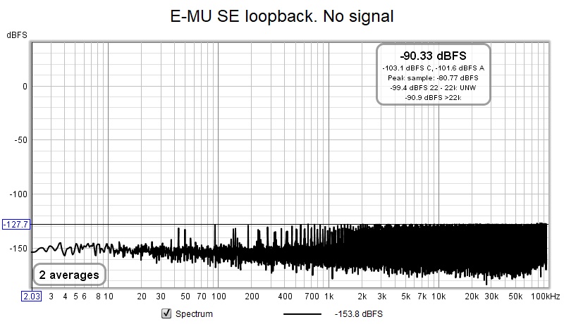

But to make it clear, AR fed by a clean 5V adds nothing to the noise floor spurae of the sound card’s noise floor.
First att. schematic of E-MU loopback and second att. it’s noise floor.
Third att. Schematic of E-MU & AR loopback and forth att it’s noise floor (Battery power bank as 5V source)
George
George

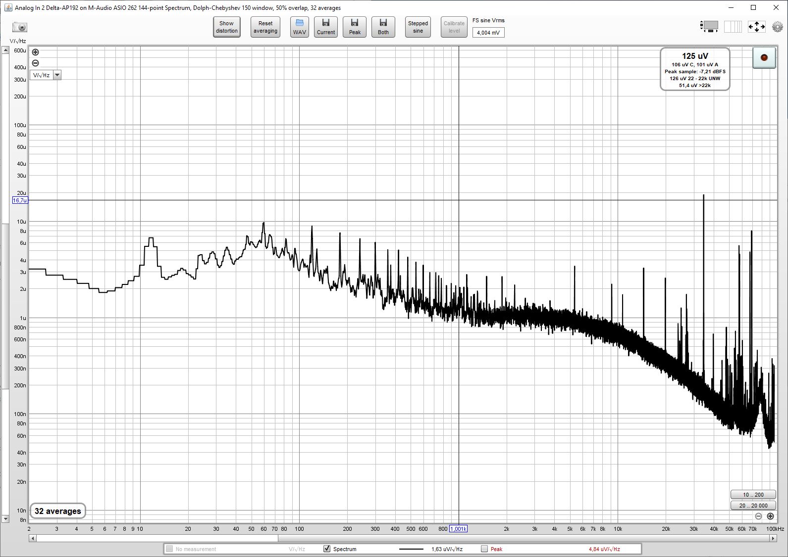

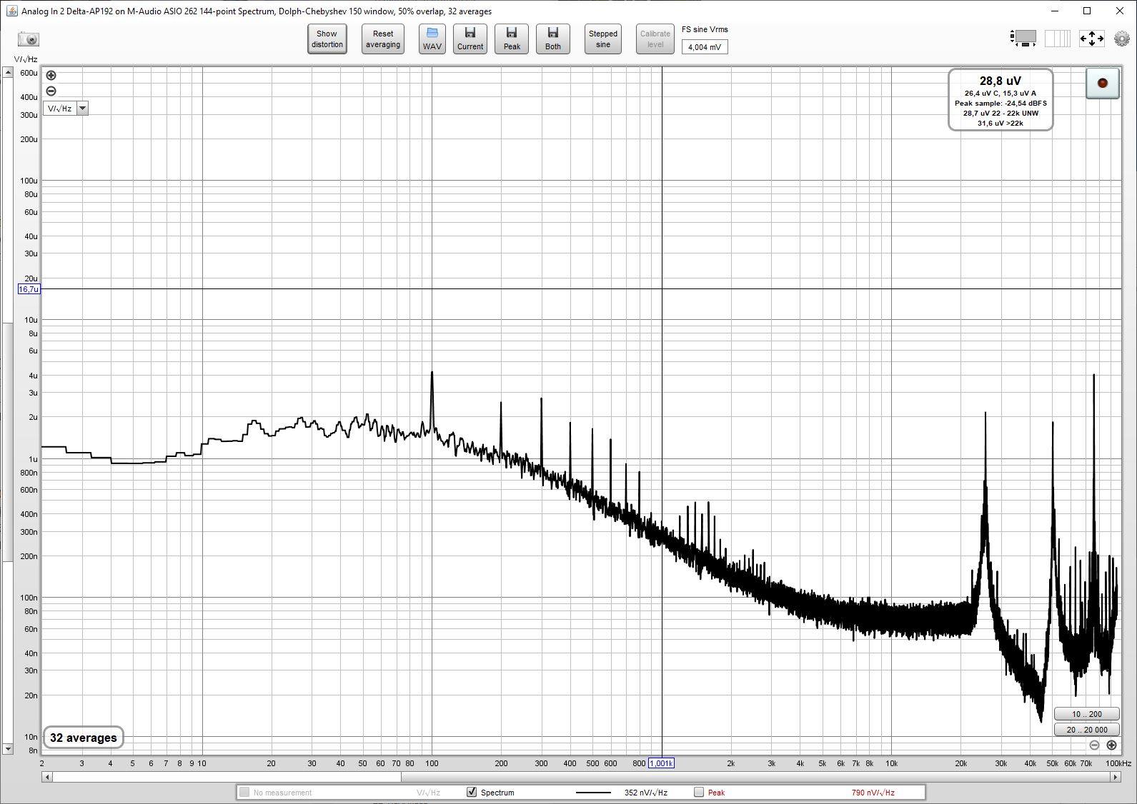

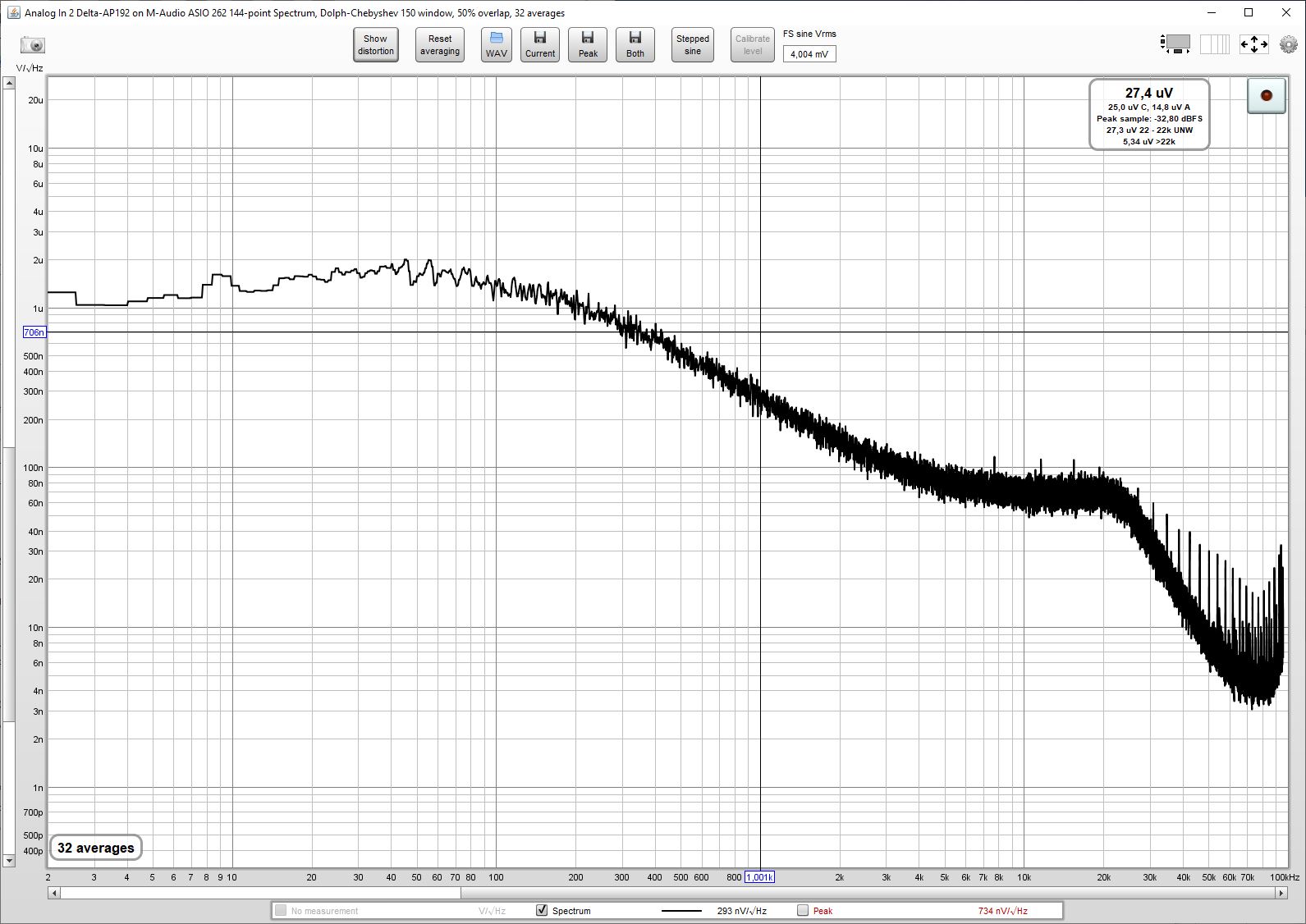

I have also measured much higher noise from SilentSwitcher when powered by computer USB port. Especially on +15V/-15V output.
Here are noise measurements of SilentSwitcher -15V output when powered by
1. battery power pack 10000mAh
2. wall-wart
3. computer USB
Sorry about the varying y-axis. Even the battery pack seems to have some hash above 30kHz. This hash is not visible if powered by 8x1.2V NiMH accus.
A battery pack is not just a battery, it has an internal boost switcher to make 5V from the 3.7V battery. So it is possible to get some hash from it, but it is rare.
If you see it check the grounding because 9 out of 10 cases the hash comes in through some surprise ground connection.
Jan
Jan

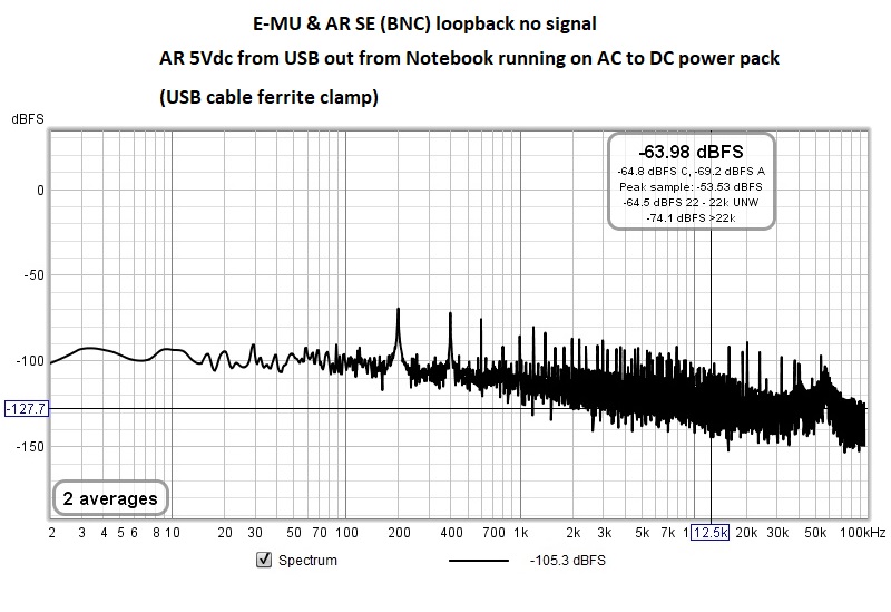

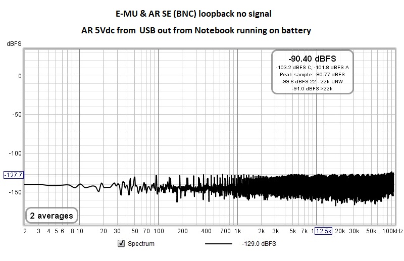

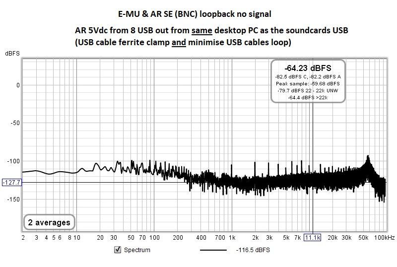

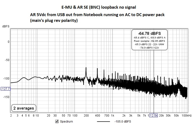

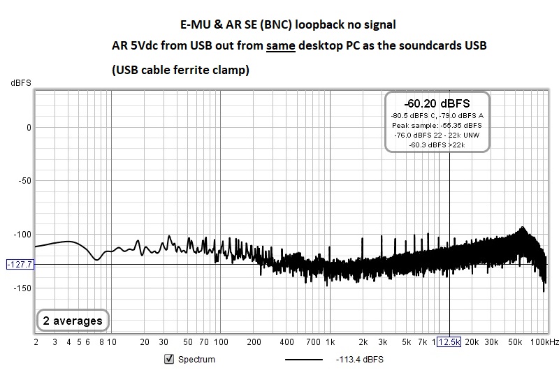

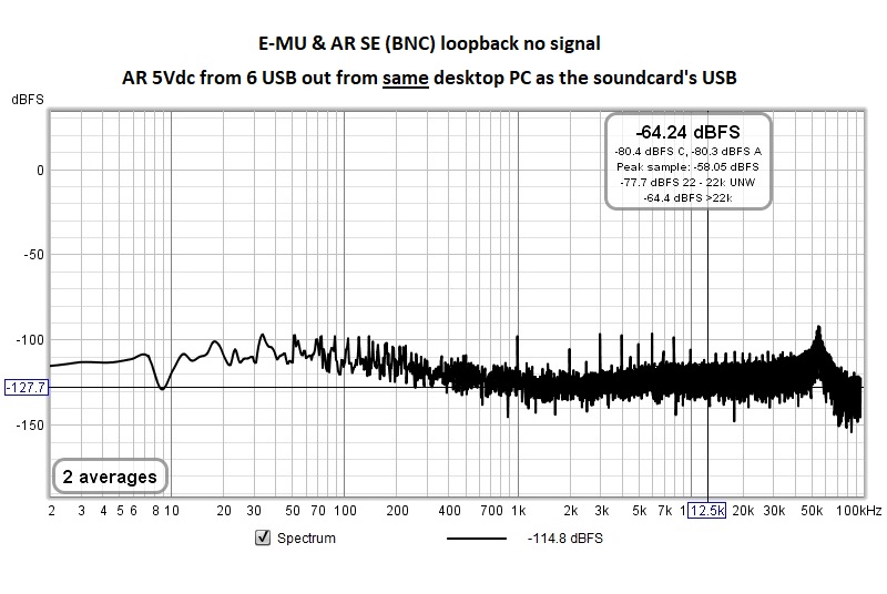

Jan as usual you were right.
The noise seems to be due to USB ground loops. The “noisy” 5V from the main’s powered Notebook’s USB-out is not noisy any more when the Notebook runs on it’s internal battery.
When there is no alternative to using mains powered PCs, laptops or Notebooks for 5V source, then use the same PC’s USB outlets to connect the USB cables of the AR and soundcard plus twist the USB cables together. Both reduce the audio noise-floor pollution.
George
7 USB out from same desktop PC as the soundcards USB (USB cable ferrite clamp).jpg124.1 KB · Views: 157
6 USB out from same desktop PC as the soundcards USB.jpg120.2 KB · Views: 141
5 USB out from Notebook running on AC to DC power pack (USB cable ferrite clamp).jpg128.8 KB · Views: 317
4 USB out from Notebook running on AC to DC power pack (main rev polarity).jpg126.5 KB · Views: 317
2 USB out from Notebook running on AC to DC power pack.jpg120.9 KB · Views: 331
8 USB out from same desktop PC as the soundcards USB (USB cable ferrite clamp and minimise USB c.jpg133.5 KB · Views: 160
I always use several of those clamp-on CM filters on the USB cables, at both ends. At least that decreases the CM noise.
