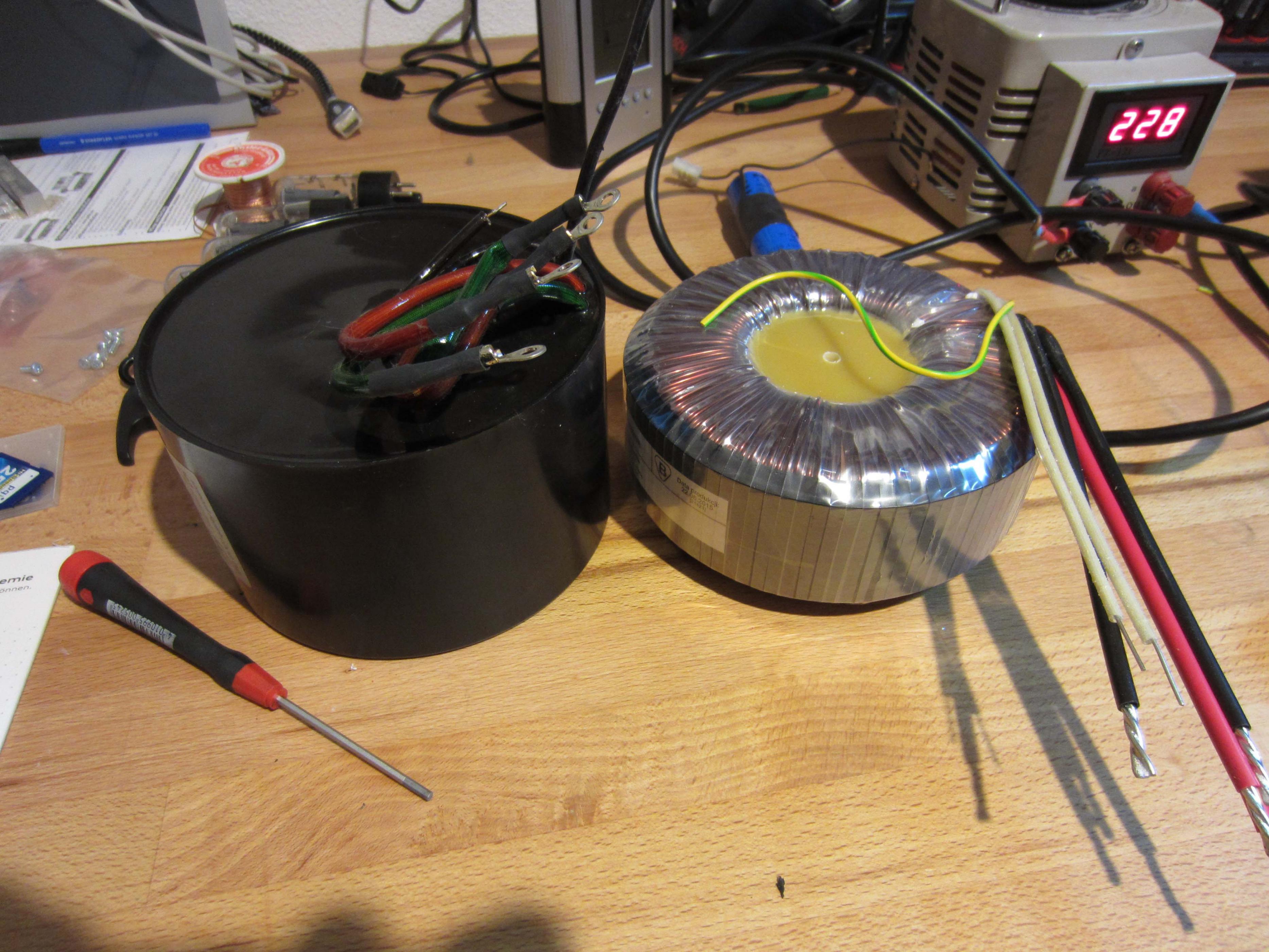

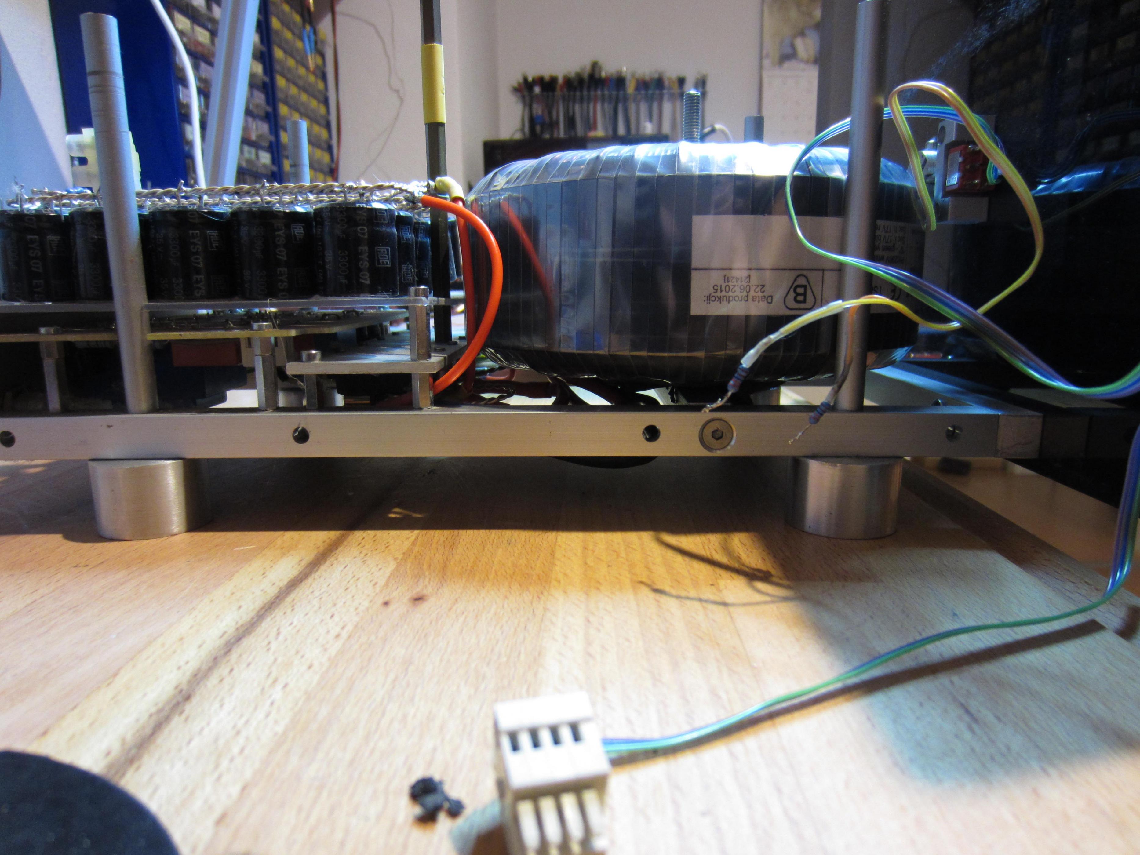

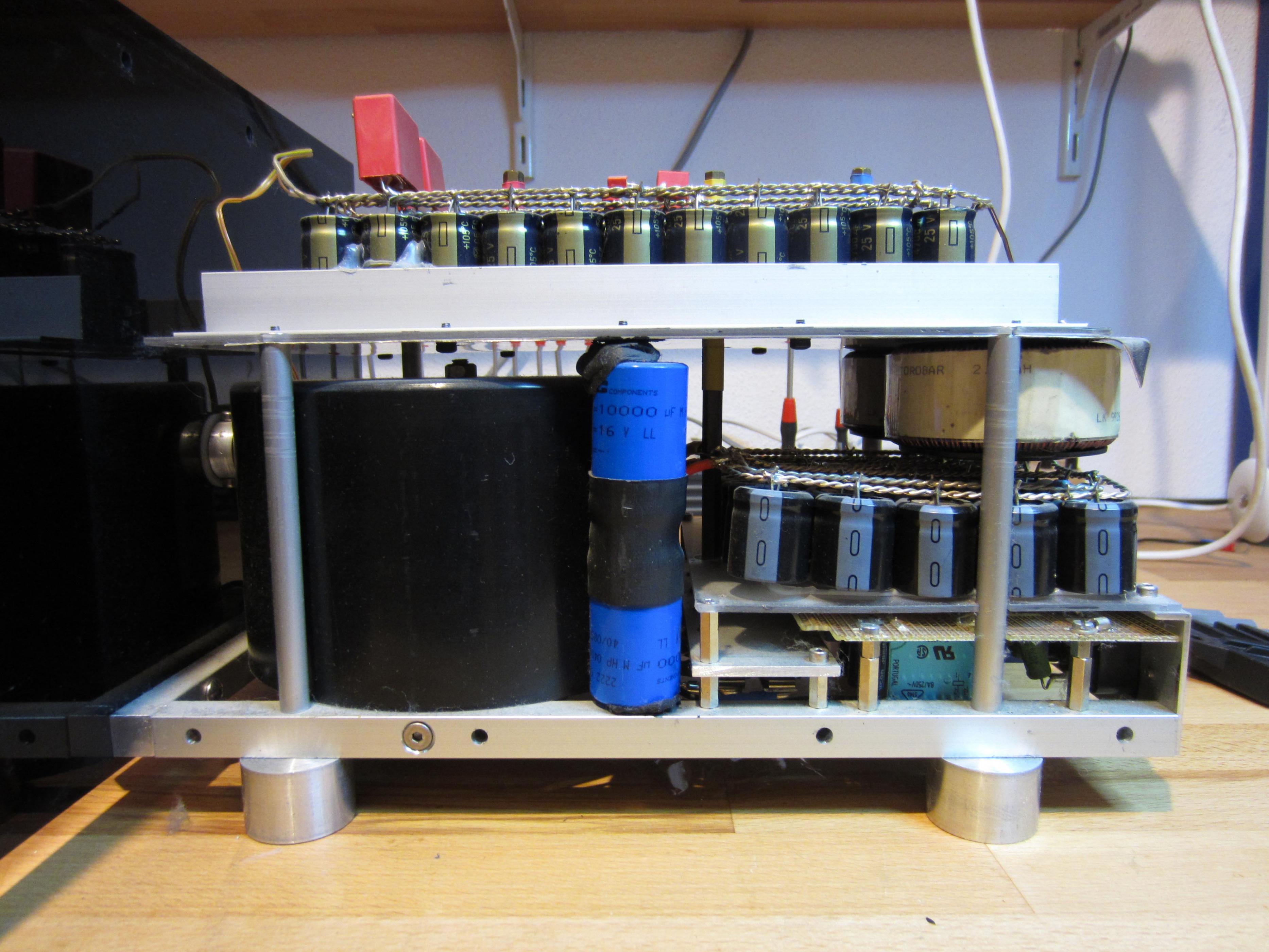

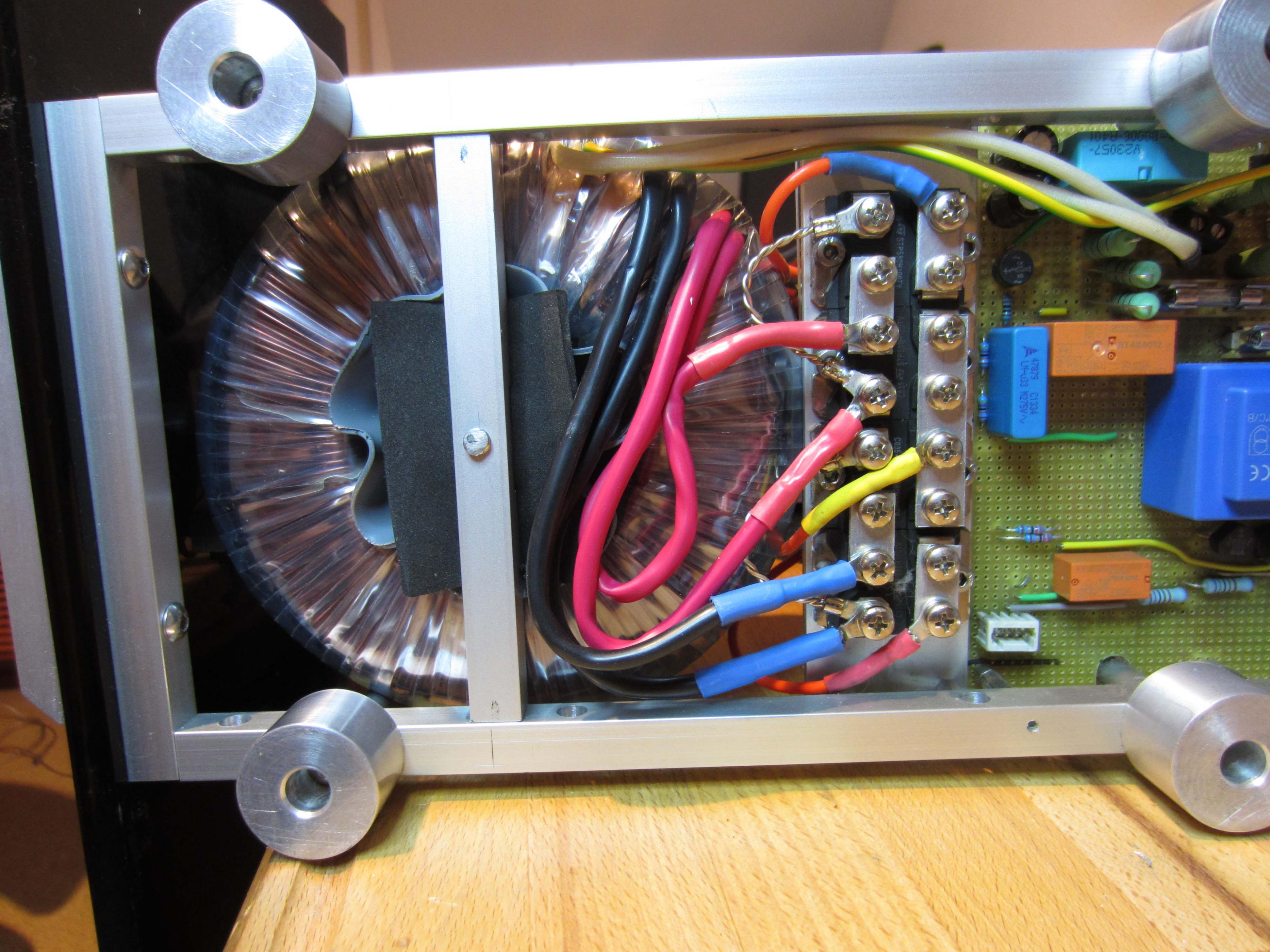

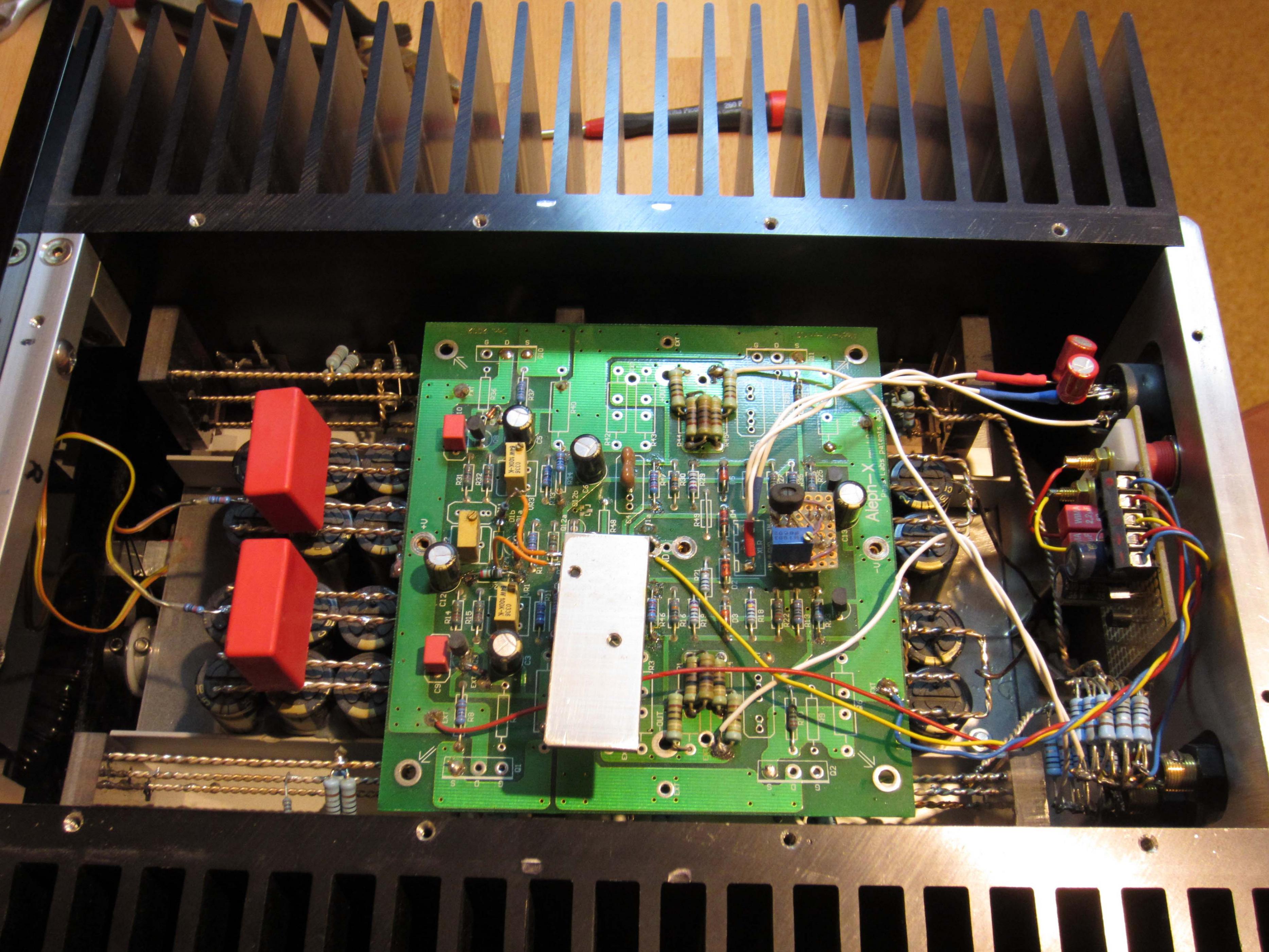

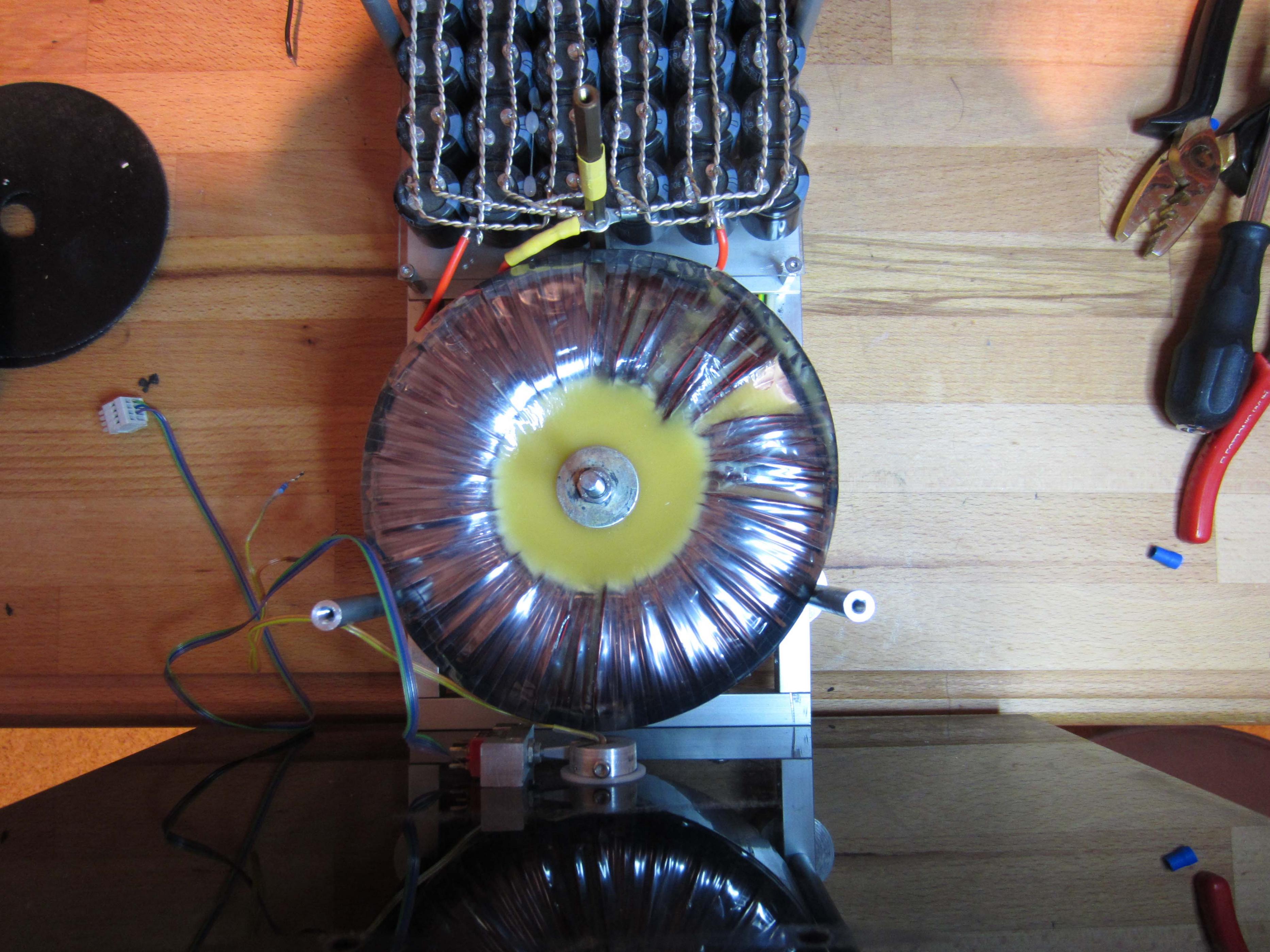

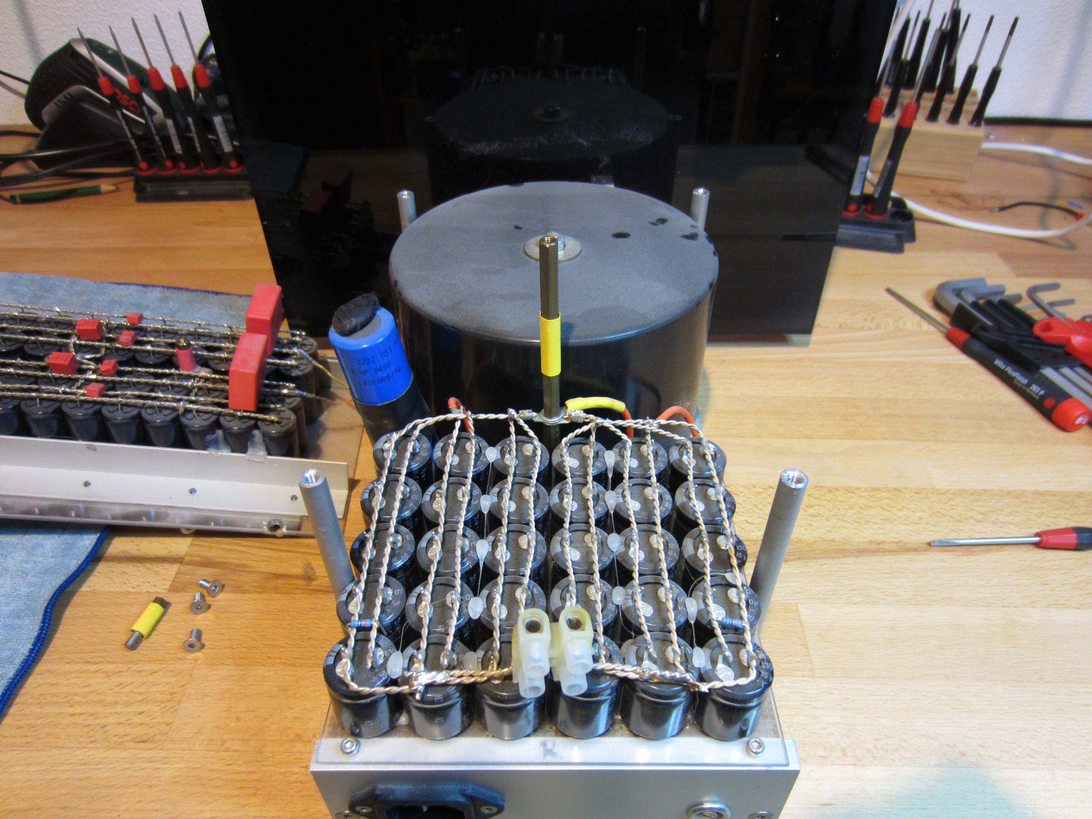

I finally managed to put a new toroid in one of my Aleph-X.
It even fitted without machining the heatsinks.
First impressions are very good. I can only hear some noise with my ear against the case.
Here are some pics of the old and new toroids.
You can see the new ones are much smaller although rated 800VA against 600VA for the old ones.
I didn´t put the DC filter back in you can see in the second pic and noticed I´ve got some 0,22R resistors on the primaries (directly at the 230V socket).
I probably can remove them too.
William
