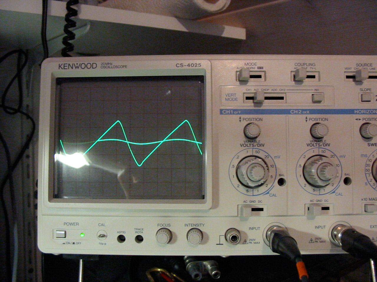

Could you expand on this?It is not too difficult to simulate the peak value of the current pulse once you know the inductance and resistance of the winding.
You can simulate one secondary as a 50Hz voltage source with an inductance and a series resistance.
These you either have to measure or ask your Tx supplier.
Then you connect the rest (rectifiers, caps, regulators, load, .....) and can run Spice to check the pulse current through the series R.
The load in a balanced Class A is easiest, as a constant current sink.
That will give you a good idea as to what the peak current of the secondary would look like.
For our purpose, it is accurate enough.
You can pretty much use this also to check your snubbers and whatever else ......

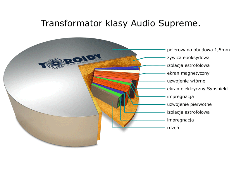

l also use these
http://sklep.toroidy.pl/en_US/c/Toroidal-transformers-SUPREME-AUDIO-GRADE-V2/99
and they are simply amazing!
Dead silent in my XA30.5 clone.

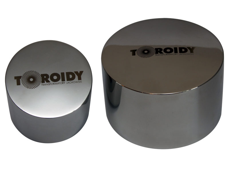

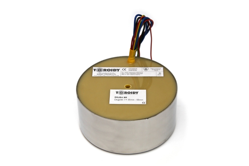

The Toroidy 800VA without case is dimensioned at 153x65mm. So it should fit.
http://sklep.toroidy.pl/en_US/p/TTSA0800-Transformer-AUDIO-TSA800VA-voltage-to-50V/321
The case with potting will add at least 8~10mm in diameter.
Their potted version 800VA is even 170mm.
http://sklep.toroidy.pl/en_US/p/TTS...rade-transformer-TSAS800VA-voltage-to-50V/418
The unpotted 1000VA is too large for you at 168mm :
http://sklep.toroidy.pl/en_US/p/TTSA1000-Transformer-AUDIO-TSA1000VA-voltage-to-50V/322
But then you already use an isolation transformer and a "large enough" Tauscher.
So maybe the hum (50Hz/100Hz ?) is caused by something else ?
Have you tried replacing the L's by R's ?
Patrick

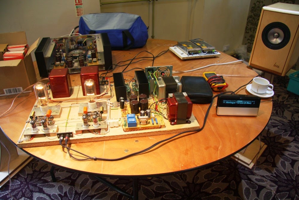

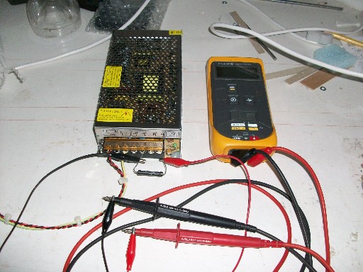

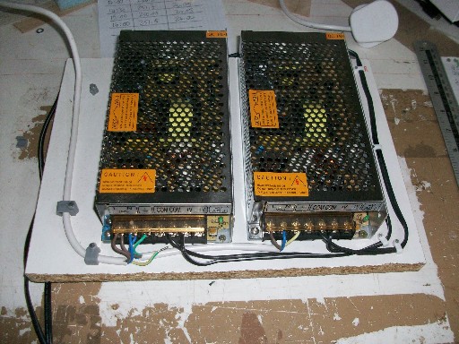

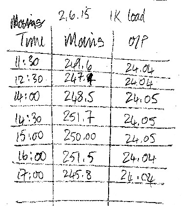

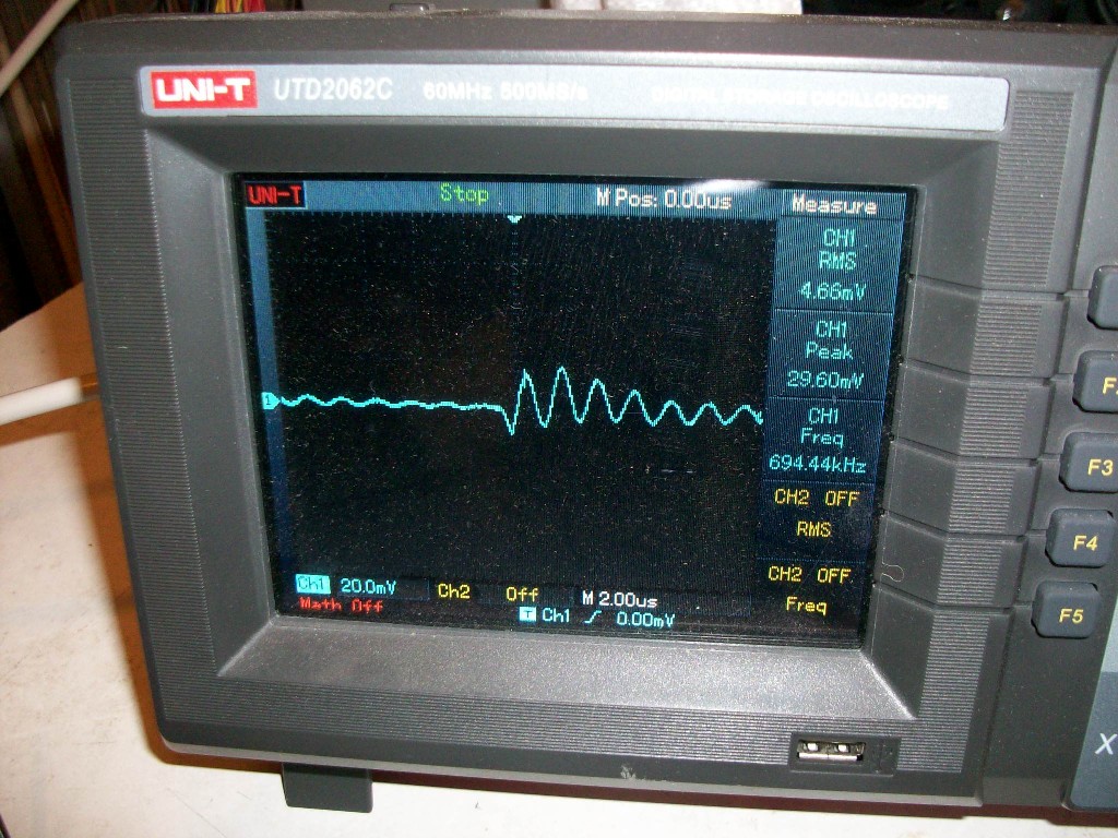

vitalstates - can you show any photos or provide more info with your experiments / uses of SMPS?
I've had these for some time but never considered them for firstwatt power supplies. The pair on the white board are for all the heaters on the sv572 amp, shown on the breadboard. They are 12v 12a, large current because the regulators for the heaters are very demanding. The one under test is one of a pair 24v 5a for gm70 heaters.
I can't remember where they came from but the ebay example I gave in the earlier post seems to show the same type.
the standard linear power supplies on my firstwatt amps show about 990uv ac on the lines and output and the thd graphs I put up in the F6 thread show some 'features' at 100hz...I will be looking at the ac on the output and rails and also the thd when I've hooked up the F6 to some smps.
The scope shows the 24v5a supply with 1k load to have 4.66mv hash at 694khz. Whether this affects SQ is one of the things to find out. I'm just curious at this stage and I might have to persuade myself to part with £30 to conduct this test(cost of 2 supplies 24v 10a)...
Ed
