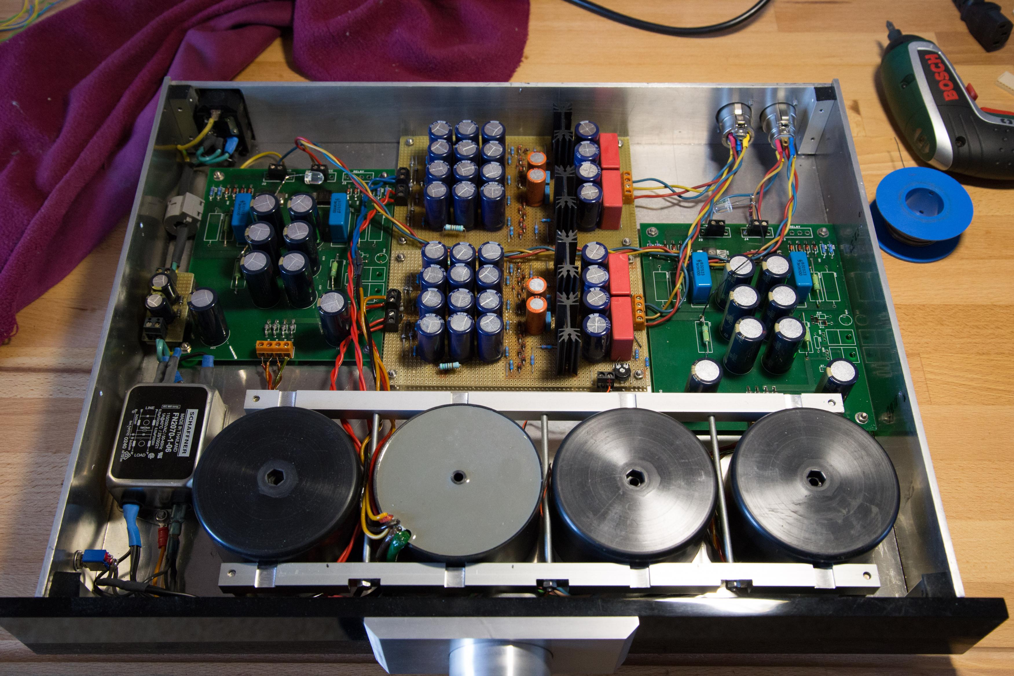

here a pic of the 4 Transformers in my X-BOSOZ power supply.
They are clamped by two aluminium bars which sit on 4 very soft rubber decoupling elements.
They still humm but you can only hear them from a few cm`s away.

the transformers from Toroidy have arrived. They look fine. They could just fit without machining the heatsinks as they are not really round. Will try this weekend.

DC blocker has been tried (and still installed), doesn´t help in this case.
Exactly balancing does help but is not so simple in an Aleph-X unless I use a servo to keep the absolute DC at exactly 0V. I tried this but the amp still hummed.
I got my toroidys and will try them in the near future. Let´s wait and see (hear)
William

Are you still referring to a mechanical hum from the transformer/s?
Is there any measurable hum/buzz/noise at the amp output?
