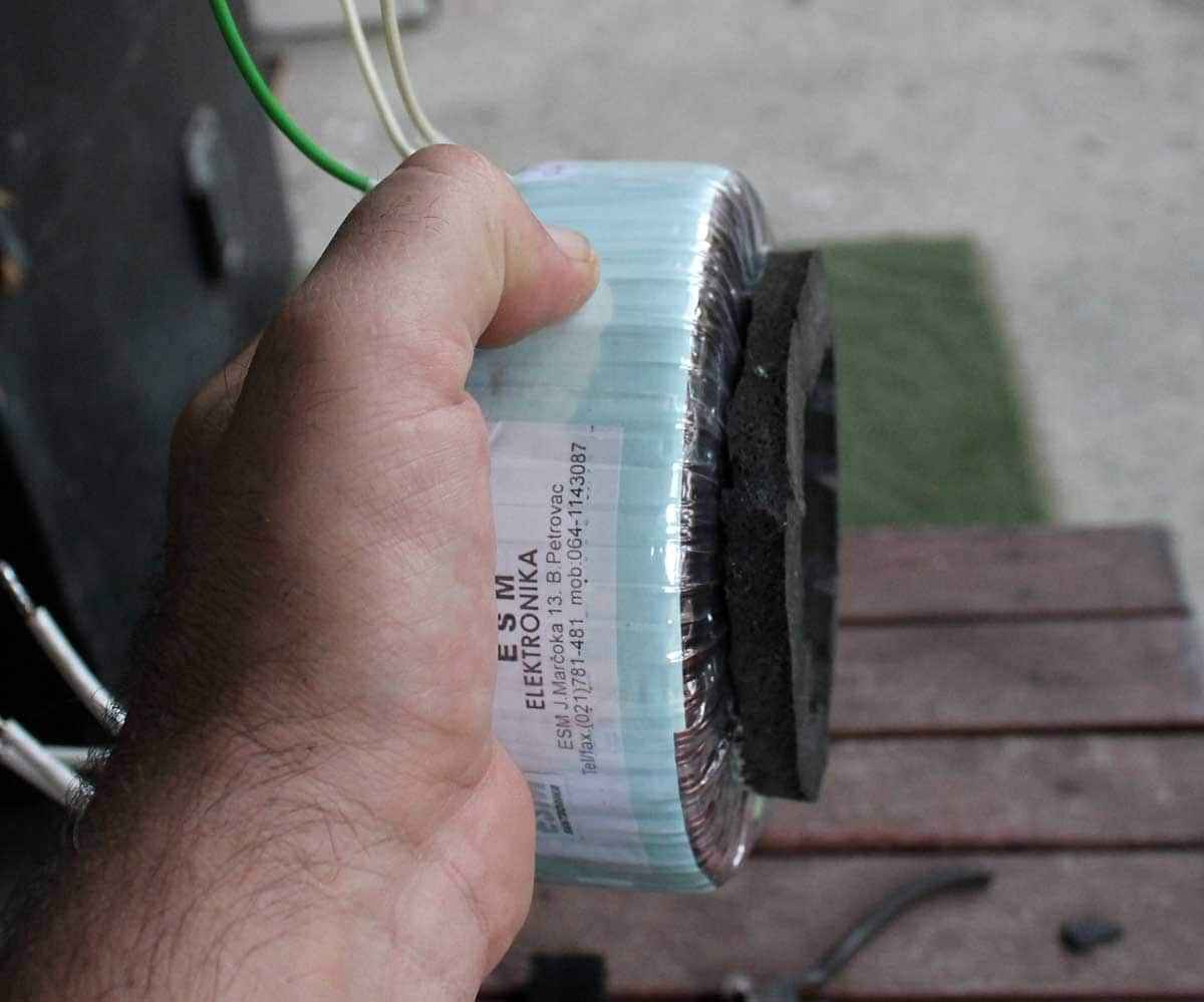

What I seem to miss in the amp picture is ample mechanical damping of the potted Tauscher.
(Vacuum resin injection of both windings works wonders, but stuffing an entire transformer in a plastic bag is very diy. Typical Dutch is buying pants three sizes larger, at a 30% sale discount, so that it may fit perfectly in 10 years time)

The transformer is held to the frame by one big bolt, I tried to reduce the contact points to the frame and tried to avoid some kind of resonance body.
Changing the torque of the bolt didn´t change the sound of the transformer.
I also tried to put it on some rubber sheet which also didn´t change the sound.
In my X-BOSOZ power supply the humming was reduced by building a "suspension " for the 4 transformers so they didn´t touch the case, in the Aleph-X this is not an option.
When I look into other amps (non DIY) I see simple non potted transformers which don´t seem to be mounted in a special way and which are silent (F1-F6etc). I just would like one of those (transformers)

Bit mute as I generally have R-cores for serious stuff, a lot easier with a stand-off in four corners.
The noise source is not the core (toroidal donut + DC-blocker to prevent the core from saturating due to mains phase mismatch)
And if it's not mechanically transmitted noise, only remains the windings at such high bias current levels. Makes me wonder about your Torobars.

still into suspensions. The problem exists not only in my Aleph-X but also happened in my Aleph-5 and my Crescendo.
The only silent amps with toroids where a few pairs of UCD´s from Hypex with almost zero load at idle and funny enough a pair of Aleph5 monos I build for a friend with some no name toroids from Pollin or Reichelt.
I tried a lot except enclosing them in a vacuum (which would help).
Suspending them only helps when the vibrations are transmitted to the case and amplified (as was the case in my X-BOSOZ power supply) but in my case the toroids are loud enough even if they don´t touch anything.
The torobars are silent.
I always thought it was the cores I heard, the noise is not always the same (but the bias is) so I think it is influenced from outside. Turning on another device (tuner, DAC etc.) makes the humming louder for a few seconds.
So for now I will try the toroidy non potted ones and see what happens. Maybe I´ve just been lucky with the ones I got until now.......
