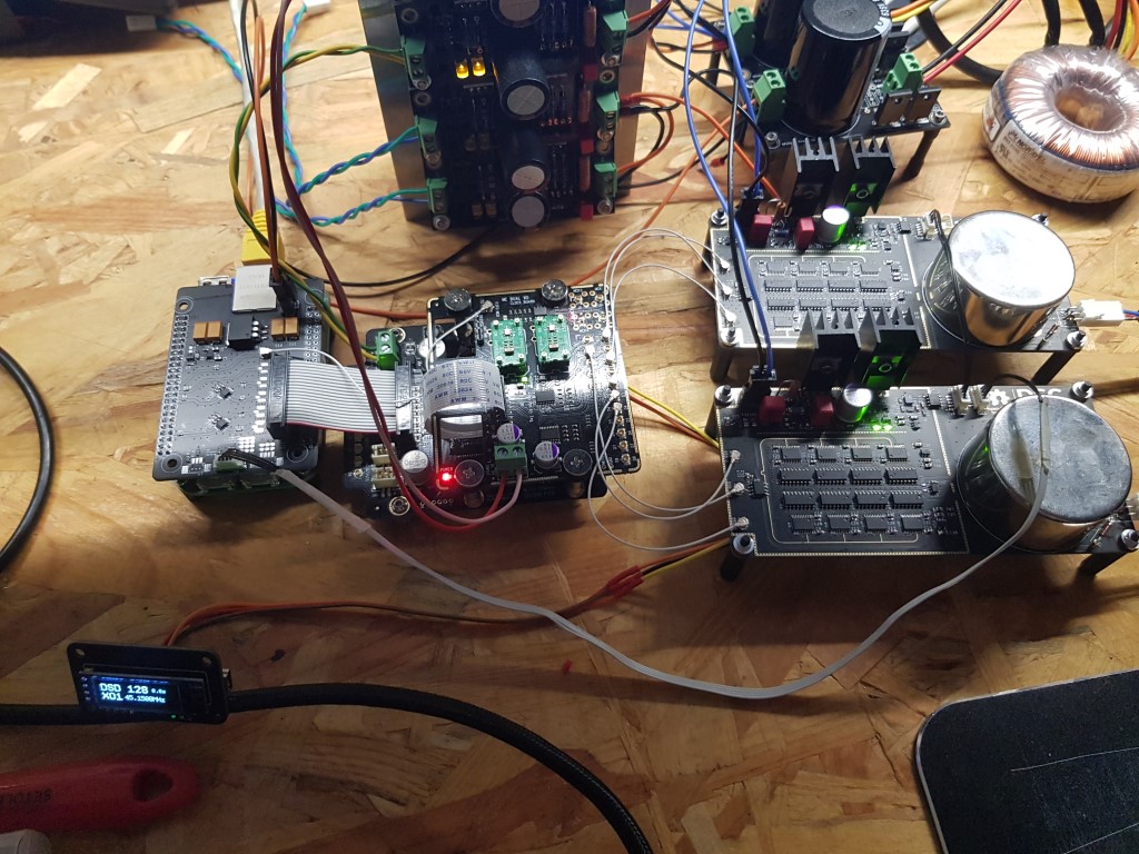

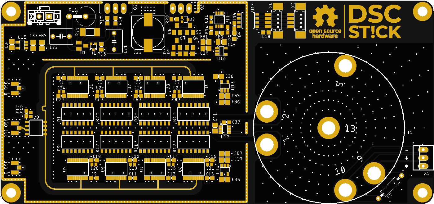

little update on my work-log.
both the "sender" and one of the two mono output boards was assembled and (electrically speaking) they are working.
i will proceed with the reflow of the second channel, and then i will report you back my finding on how it performs playing some music 🙂

Very interesting,
Seems that you made extensive use of Salas' shunt PSU, also in a smd version, onboard.
Keep us informed about your work!
P.S. I'm sorry to hear about Pavel stopped development, anyway I hope the community can keep this little diamond alive. Gionag's one is certainly a first step in that direction.

I had every time modded each to uses the Reflektor's from Salas. instead of the integrated regulators. I found (personally...) that the sound improved a lot using shunts. never tried the ultrabib though.
I have made a transposition from the published Reflektor-D mini schematic making an SMD version (almost every component used had their direct counterpart in smd).
Will keep you posted on how it sings

i feel the urge to explain a little better what is the "routing" is... but will be addressed in the future ...
btw, the mute signal is coming straight from the beaglebone, isolated on the St!ck's.

ok... it sounds amazing. not sure what found pavel on the new shift register/resistors...
but this re-arrangment of the topology is flawless to me. improved almost in every regard.
i want to experiment with the mute signaling coming from the fifo... maybe i will re-spin the board one more time with that...
