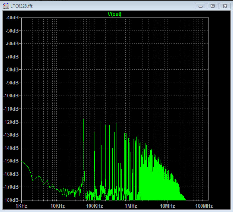

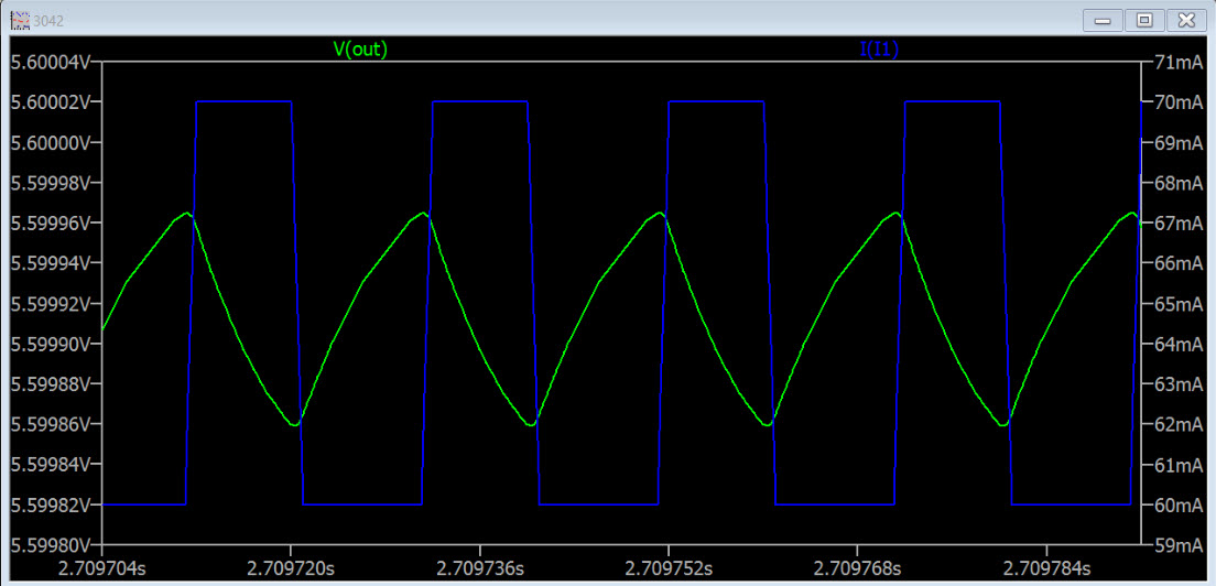

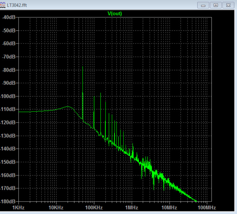

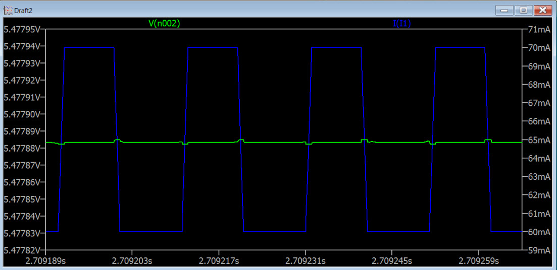

The DSC resistive matrix is a dynamically changing load of ~15mA. The registers also at the time of switching create high-frequency interference on the power board. My voltage regulator does this efficiently.
DSC voltage regulator and load current +-10mA/50kHz:
LT3042 voltage regulator and load current +-10mA/50kHz:

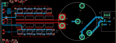

4 layerThe board will be 2 or 4 layer ?
i am eager to see the schematic to "rob" some great ideas from you.

Pavel, your simulated 3042 output shows 10mohm Zout, and, more importantly, the FFT starts to fall very fast.
May I ask at what standby current did you do the simulation?
I have real life outZ measurement for 3045 ~5mohm min, and less than 20mohm out to 2MHz bandwith almost without a resonant peak. All this with 10uF effective capacitance on the output.
Other, more refined results show that lt3042 can go below 1mohm, below the 10kHz range.
On the other hand, having 40-60dB less than 10mohm Zout is in the 10/100uohm range. In all honesty, I would like to see real life measurements, up into the MHz land, of such results..
I understand that your topology 'could' achieve that level, in theory, but real life trace impedances, stray inductances and capacities will make it a real hm.. adventure. Your array is not a small area, how do You intend to distribute the regulator output with low impedance?
