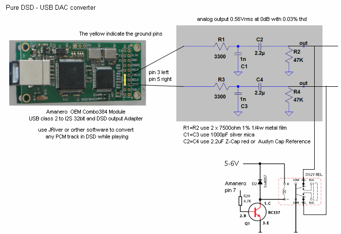

Vit123 the mute circuit using the "MUTE" pin as a trigger is the same schematic like attached pic?
TIA
Felipe

Pavel (ppy) published his schematics for early version of DSC v2 at russian DIY forum.
You can have a look at the end of the first page. Sorry, but I can't publish schematics directly without his permission, that's why just link.
He is working now on the project documentation (DSC 2.5.2, 2.6.2) and will publish it soon.

May i ask if this BBB driver is available ? I have a BBB going into a DSD dac (different design from DSC2) but would need a MUTE trigger to stop the pops. I will have to come out with a MUTE circuit but thats another story. Thanks
@nautibuoy and I discussed BBB/Hermes/Cronus before and I'm glad to announce that the pops have been resolved. At least for me.
I managed to recompile and modify the snd_soc_davinci_mcasp driver for the latest 4.8.13-botic7-rc3 kernel. I am sure @miero will be outraged when he sees what I've done, but as far as kernel driver development, I'm more or less a noob.
In any case, I supply HIGH at rest to configurable Cronus data pin(s) and supply this to pin 11 of DSC2. I wait for the stream to initialize and I supply LOW the the same pin, thus enabling playback and avoiding the pop.
There is even a configurable mute delay in milliseconds, but I'm not sure it is needed - it works fine without it.
