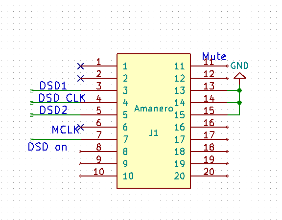

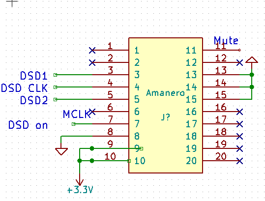

I am looking forward to getting my DSC2.5.2 board thru the group buy, in the mean time I have a few questions:
1. The instruction manual shows set up for Amanero board. However I am currently using DIYINHK XMOS board, in a linux system running at DSD512 and don't really want to buy a new USB board (especially when I have read in this thread that Amanero does not play well in Linux). So what are connections if we use an XMOS board? I assume that we need to input DSD left' DSD right, DSD clock and 3.3V to the DSC2 board, but its not clear which are corresponding input pins.
2. I will be dispensing with the output board and taking the output of the main board to my TVC (chinese eBay device, which I am happy with). This TVC has 2 primary coils, I use them in series and 'centre tap' on primary side is grounded. Now the diagram in the DSCv2 instruction manual for the LL1527XL shows the primary centre tap going to ground via a capacitor. Is this correct?
Thanks, Hazard
DSC pinout for Amanero board in correct orientation is attached. Pin1 is marked on PCB. Beware of huge pops when using XMOS USB board.
You can omit capaсitor from centre tap to ground.
Thanks Vit, sorry to be dumb but I just need to be clear on this - the attached diagram doesn't show 3.3V input (pins 9 and 10 on Amanero board based on diagram in the instruction manual). Does this mean that DSC 2.5.2 board doesn't need 3.3V input? DIYINHK board of course has 3.3V input so I will already have a voltage source if also required fpr DSC board.
