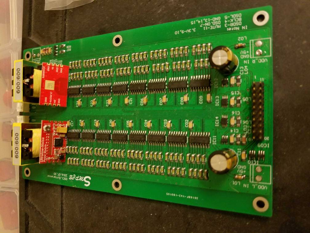

One more beginner question : The dac is built and all I have left to do is to wire up the output RCA's. My version is the Chinese balanced output board with the 600:600 ohm transformers (10k ones are on their way). I want to convert the balanced output to single ended and read that I need to connect the -ve phase to ground and the positive phase to rca +ve , ground is connected to rca negative.
Would come kind soul let me know if this is correct.

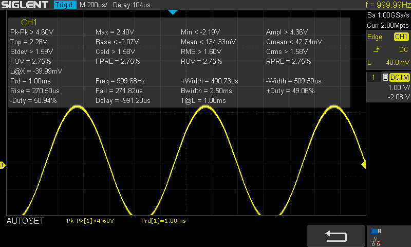

Frequency response of stock DSC v2 transformers 10 Hz - 150 kHz +/- 0.2 dB. That's why there is practically no LPF in DSC v2 from my point of view. In attach you can see DSC 2.5 measurements 5K+15K signal (DSD256). I have no problem with ultra sonic noise with my Prima Luna Dialog Premium amp and DTQWT by Troels Gravesen.
Output voltage 1.6V Rms. Zout ~ 700Ohm.

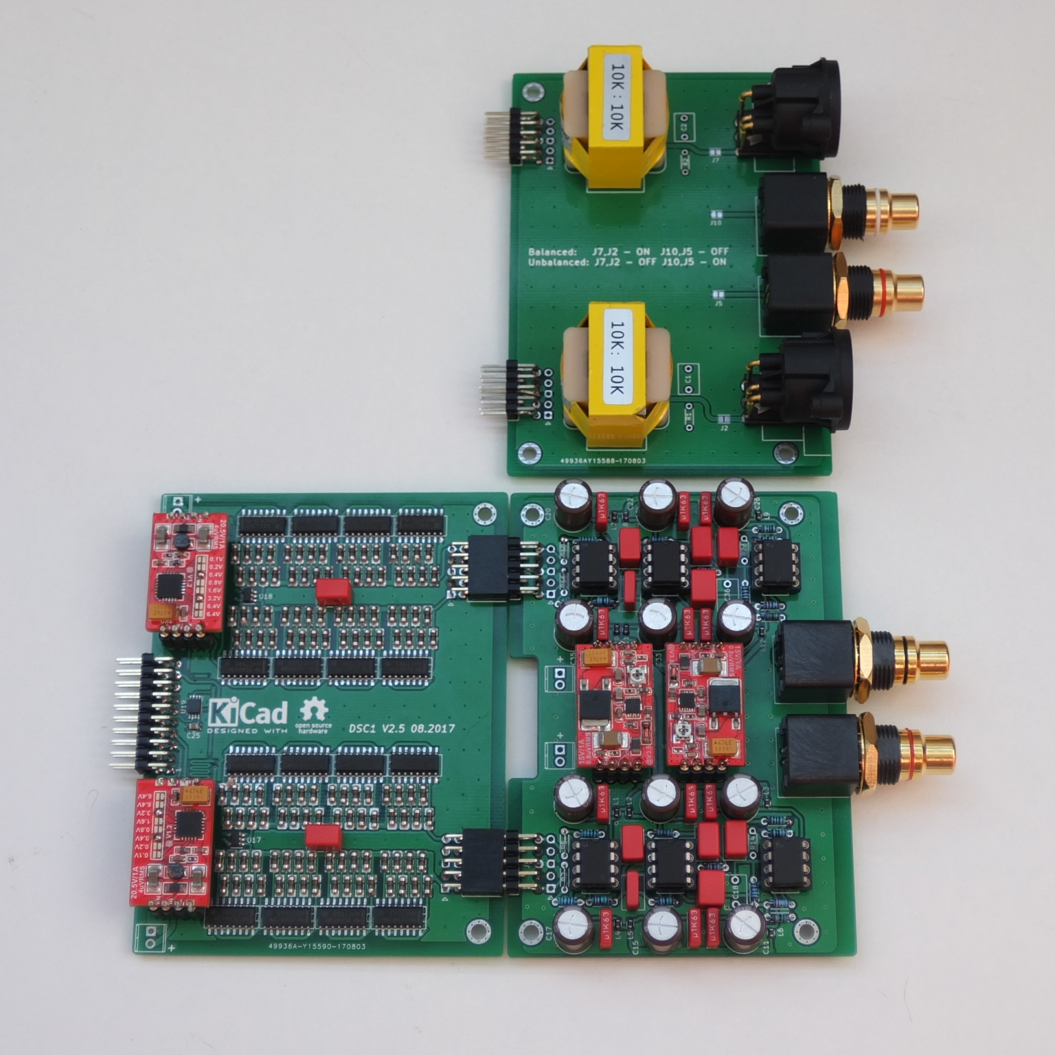

Hi guys , got my build up and running and tested it with the CD transport last night : big improvement over my previous dual 4495 build from the same chinese manufacturer (Ustars).
This morning I flashed the Anamero board with CLPD 1080 and CPU 1099c ,installed drivers for the card on win10 pc running Jriver. The card shows up in usb output devices in Jriver but I was getting "Jriver can not out files to you device in 44.1khz" format. Tried Wasapi and KS and these both appear to play but there is no sound from the speakers.
I reflashed the card with the CLPD 1080 slave firmware and the situation was the same except now the SRC indicator light is coming on as it did with the cd transport. The display on the dac either shows not locked or 'Other' when the usb board is selected.

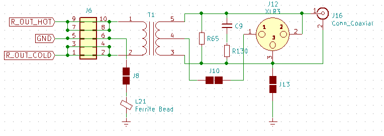

Here is a schematic of output module of DSC 2.5.2 with stock transformers.
