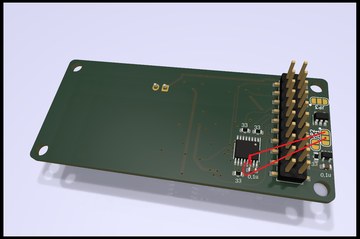

I solved the noise problem by giving the master clock some extra delay. The U7 74LVC157 Mux had a spare 3rd channel with inputs connected to ground. I removed the connection to ground and connected the master clock coming from the DAC to it. Master clock signal is taken from Jumper 1. The output of the Mux channel is routed back to Jumper 1. Normally the used Jumper 1 pads were connected directly. Now through the mux.I am very content with how the DSD'it sounds but I have a problem when feeding DSD from HQPlayer. PCM from HQPlayer works perfect. But with DSD I get a very strong, audible noise floor. I will have to dig into this further. Maybe one of you can help. The DSD'it board 5V is coming from the Beaglebone power supply.
This problem it not new. Someone else is experiencing the exact same thing, but then not in combination with Xing U30 but with Beaglebone. See this post: https://www.diyaudio.com/community/threads/simple-dsd-src-for-beaglebone.358147/post-7345755
Now the DSD'it also works flawlessly with DSD input coming from HQPlayer. Direct comparison between the AKM4137 modulator and HQPlayer modulator is easy now. And yes, with recordings were it really matters (such as good classical recordings), HQPlayer is better with a rather large margin. But with mainstream stuff, DSD'it modulator is already doing a very good job. But in direct comparison, a bit rough, less smooth and resolving, a bit further away from how instruments really sound. HQPlayer is still worth it when you do not need the ease of DSD'it which enables any USB streamer source.
