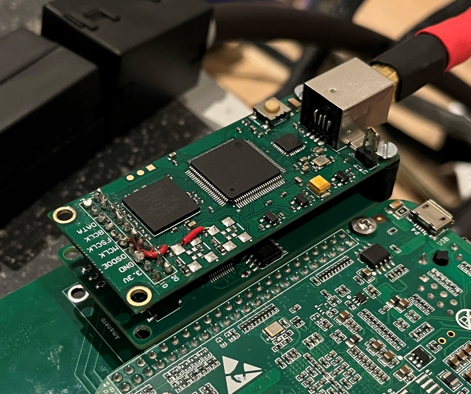

Pavel, or someone else, I am busy with the DSD'it Amanero version and I need help.
I am trying to program the ATTiny85 but Arduino gives back an error in compilation of the sketch file 'Scetch_for_ATtiny85.ino' that Pavel provided.
I've verified that the ATTiny works correctly, I can succesfully upload a simple LED blinking test program on the sparksun Tiny AVR programmer board with the ATTiny85 on it and the LED blinks nicely.
Well, thank you all very much for your help!!!
In the meantime, I was able to fix it. I discovered that with the standard Arduino software the Wire instructions did not work with the USBtinyISP programmer as provided in the online manual for the Sparkfun Tiny AVR programmer board.
You have to install an extra boards manager named ATTinyCore: https://github.com/SpenceKonde/ATTi...-head-submit-PRs-against-this/Installation.md
After installing and selecting the ATTinyCore board under tools and selecting a new programmer USBtinyISP (ATTinyCore) FAST, for parts running =>2 Mhz, the compilation and uploading went like a breeze.

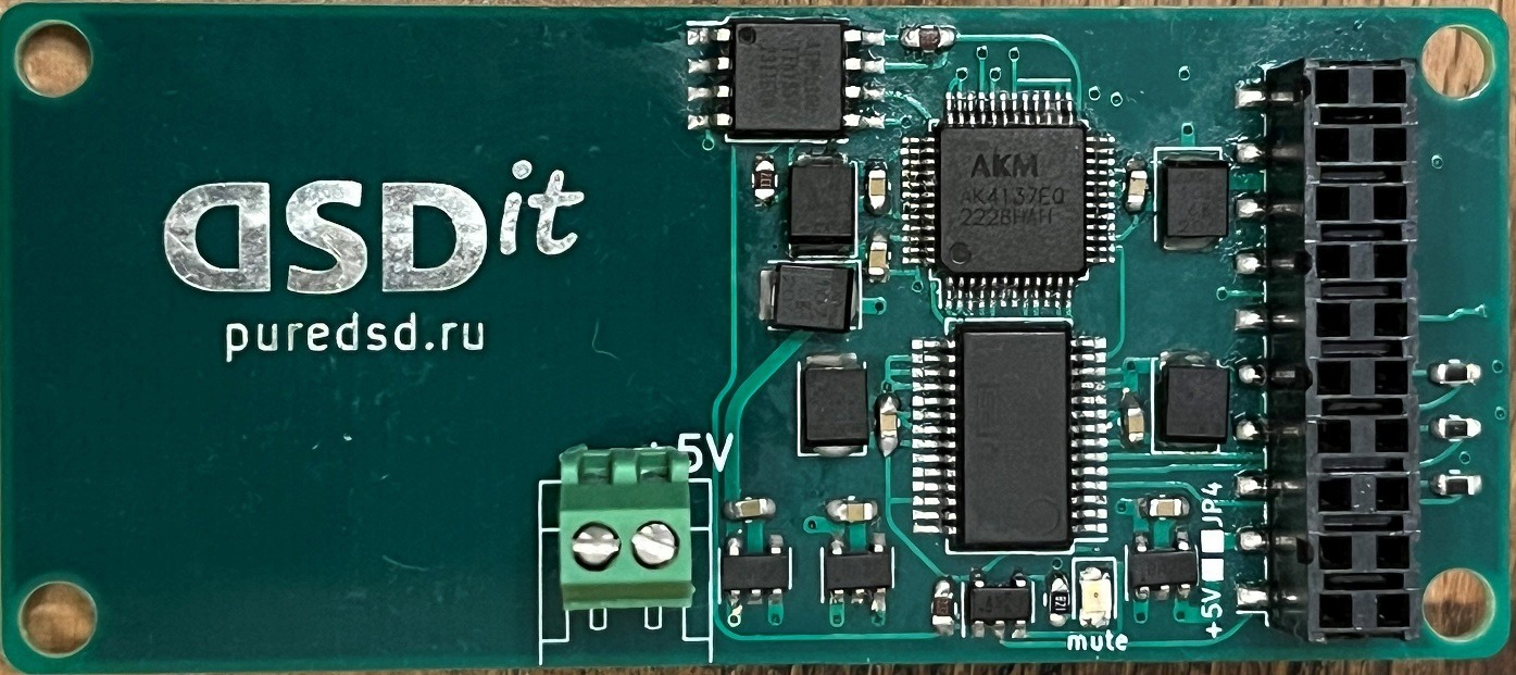

The DSD'it works! And sounds surprisingly good! I expected a bigger difference with HQPlayer. It is there of course but this little board sounds very nice so I can imagine that Pavel himself also plays with this a lot for convenience. Pavel, thanks a lot for this design!
It does its job nicely under the Xing U30.
