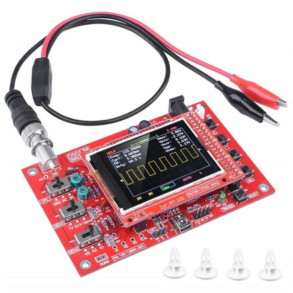

Show them this.When I were 'lad you had to build your own oscilloscope from a kit and you tell the young folk of today that and they don't believe you... [ with apologies to Monty Python! ]
DIY $20 Oscilloscope - YouTube
~$25, build the kit in 2 hours. 200kHz analog bandwidth, 12bit vertical resolution, hand held.
But this is OT as everything past post #14

FYI - if affordability is the main issue, they’re almost giving these away on ePay. Mine arrived last week, haven’t unwrapped it yet though. At these pricess I can put one in every amplifier chassis....
Specifications:
Maximum Real-time Sampling Rate: 1Msps
Accuracy: 12Bit
Sampling Buffer Depth: 1024 bytes
Analog Bandwidth: 0-200KHz
Vertical Sensitivity: 10mV / Div - 5V / Div (1-2-5 progressive manner)
Input Impedance: 1MΩ
Maximum Input Voltage: 50Vpp (1: 1 probe), 400Vpp (10: 1 probe)
Coupling Modes: DC / AC / GND
The Horizontal Time Base Range: 10μs / Div - 50s / Div (1-2-5 progressive manner)
Supply Voltage: DC 9V
PCB Size: 117 * 76mm / 4.6 * 3in
Screen Size: 52 * 40mm / 2 * 1.57in
Weight: 132g
Note: the power supply is 9V 1A with 4.0x1.7mm DC connector (not including)
