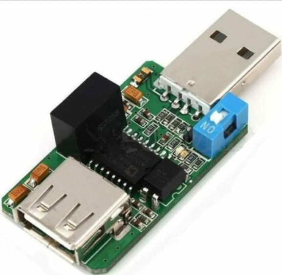

If you're connecting to the computer via USB, I can vouch for these cheap little isolators -- they can seemingly do miracles in some test setups. I have used three at a time in some setups. Only work for FullSpeed (12Mbps), though, but good enough to pass 96kbps sampled USB audio.
Cheap USB Isolator
There are some USB3 compatible ones, but I haven't tried them (haven't needed yet, and they are pricey

I still have reservations about the sound-card-as-oscilloscope plan, but a big "Thank you!" to everyone for their helpful suggestions. (That USB-to-USB isolator board is a great find!)
