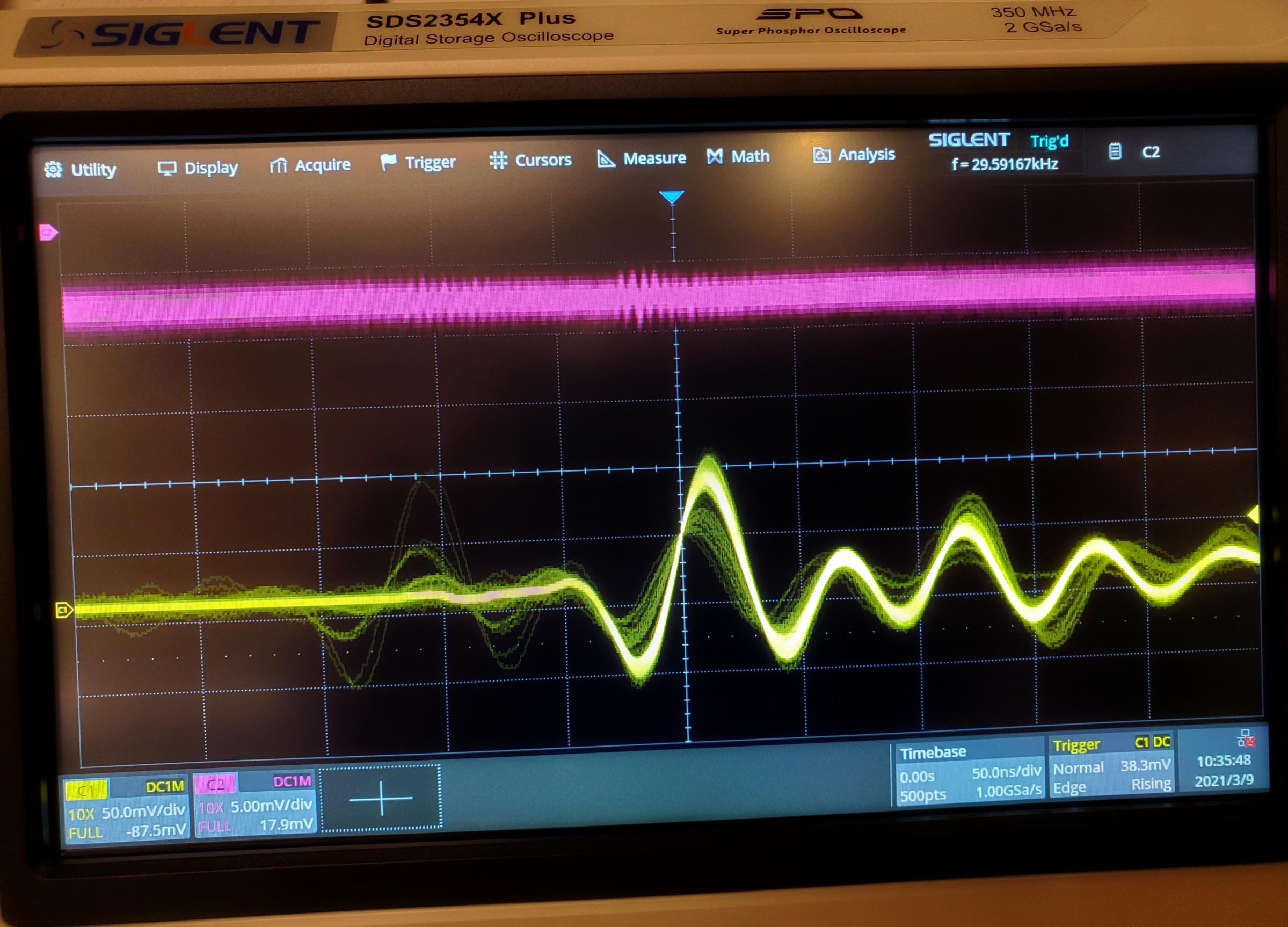

My first scope photo from the new Siglent SDS2000x-plus series scope.
Cool now plug in a usb stick and press print! Or connect via a web browser and you have complete control.
I think a digital phone photo is fine & quicker.
Someday I may add a WIFI extender/router to the garage
Unless you need to read the fine-print measured values amidst the glares 🙂
