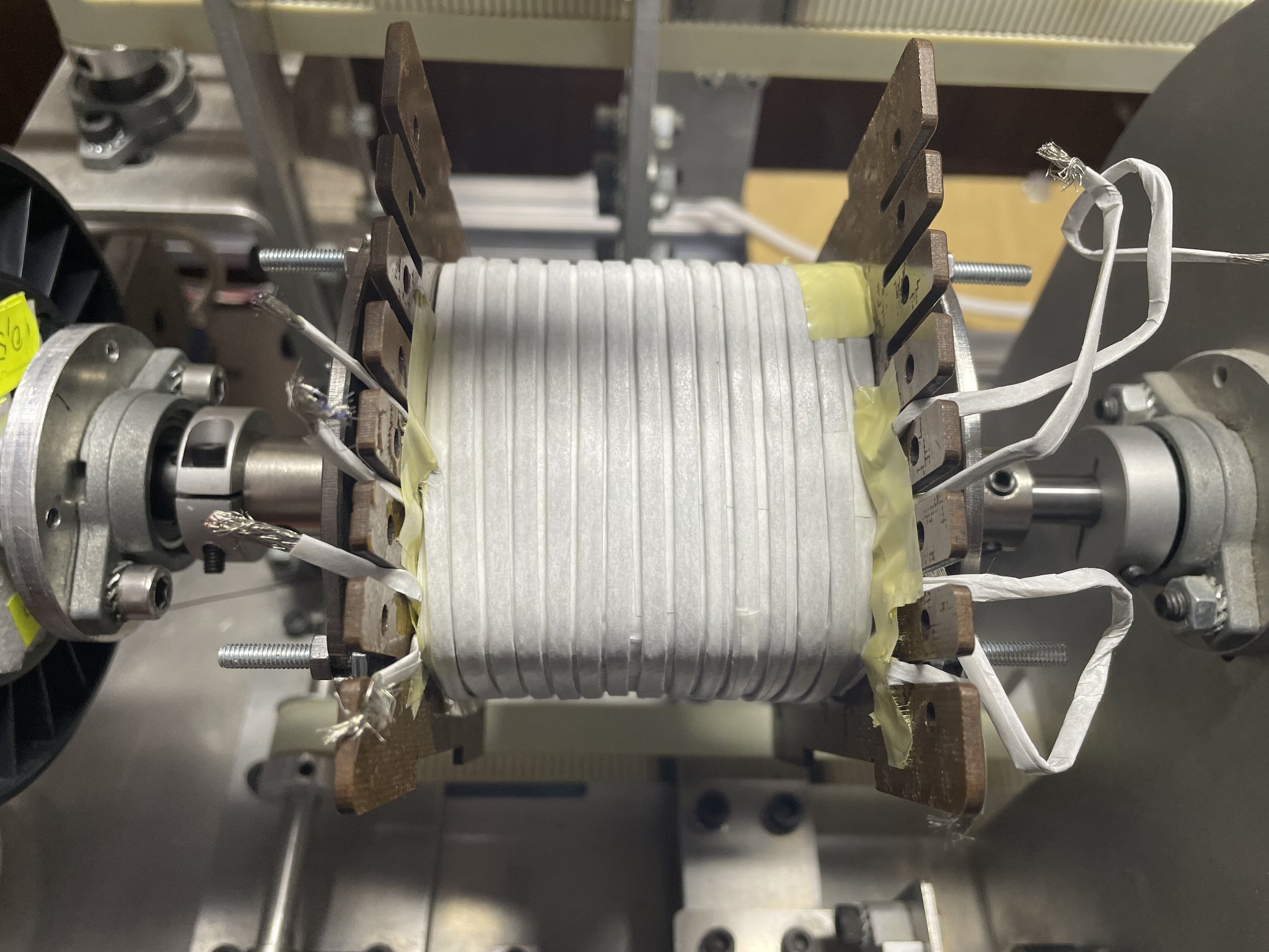

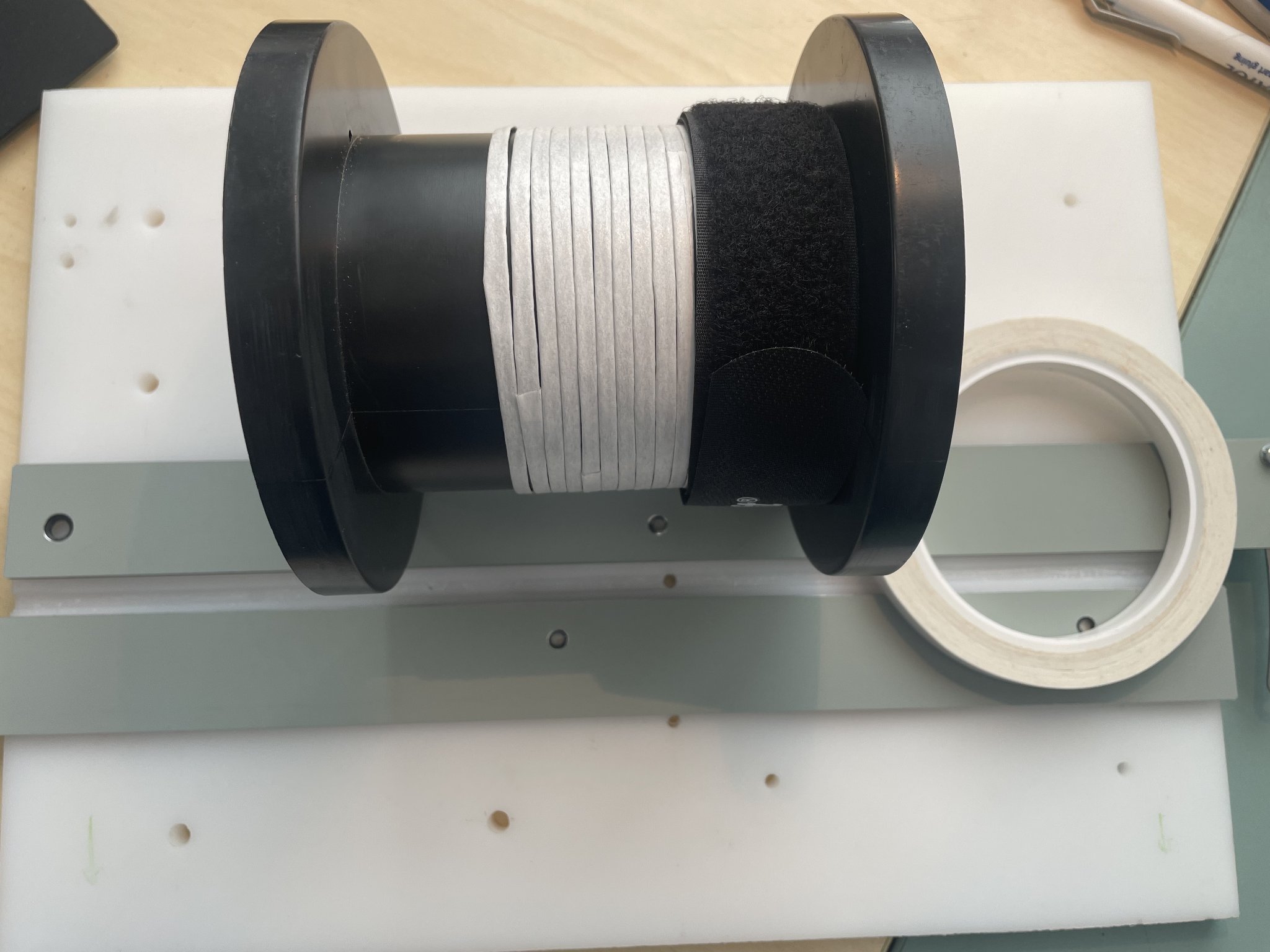

I wind with all the secondaries in parallel, but the question is if has anyone wound the secondary in series with a similar diameter as the parallel configuration, using Litz wire?
I did with one of my prototypes, took flat (ribbon) copper braid wire 1.5mm2 (4mm width), wrapped it with Nomex self-adhesive film all over entire length. Quite time consuming job to say at least. All secondary sections were connected in series to form 5 Ohm impedance.

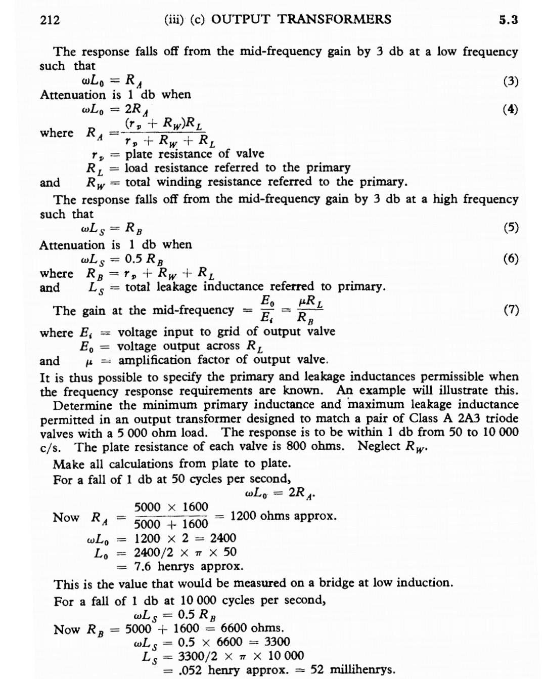

Are you sure about it? Here is a screenshot from RDH4, output transformer section:
As you can see Low F falls where RA is equal to 2πf*Lo , so Lo = RA / 2πf
And RA equals to RL in PARALLEL to (Rp + Rw), so what happens if you take Rp into account? RA would be lower, so your calculated Lo would be lower, right?
Yes I am.
Your spreadsheet is not good and will mislead users.

Oh sorry, probably I couldn't explain my point well enough; I meant aiming for a little more Lo (or Magnetizing Inductance) wouldn't hurt, and it will lead to better bass response not weaker bass, because as you mentioned before, Rp (plate resistance of the output tube) is in parallel with RL (reflected load into primary or Zp). So if we don't take Rp into account it would lead us to a bigger value for Lo, not lower number.
Also if you look carefully in the spreadsheet formulas you will see that this calculated inductance will not play a part in further calculations and it is only there for seek of knowledge! Actually primary number of turns is practically always calculated based on the Bac and Bdc (AC and DC flux desity), which is entered by the user.

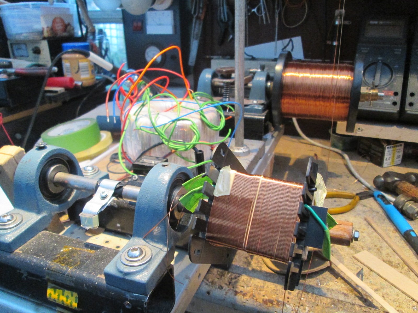

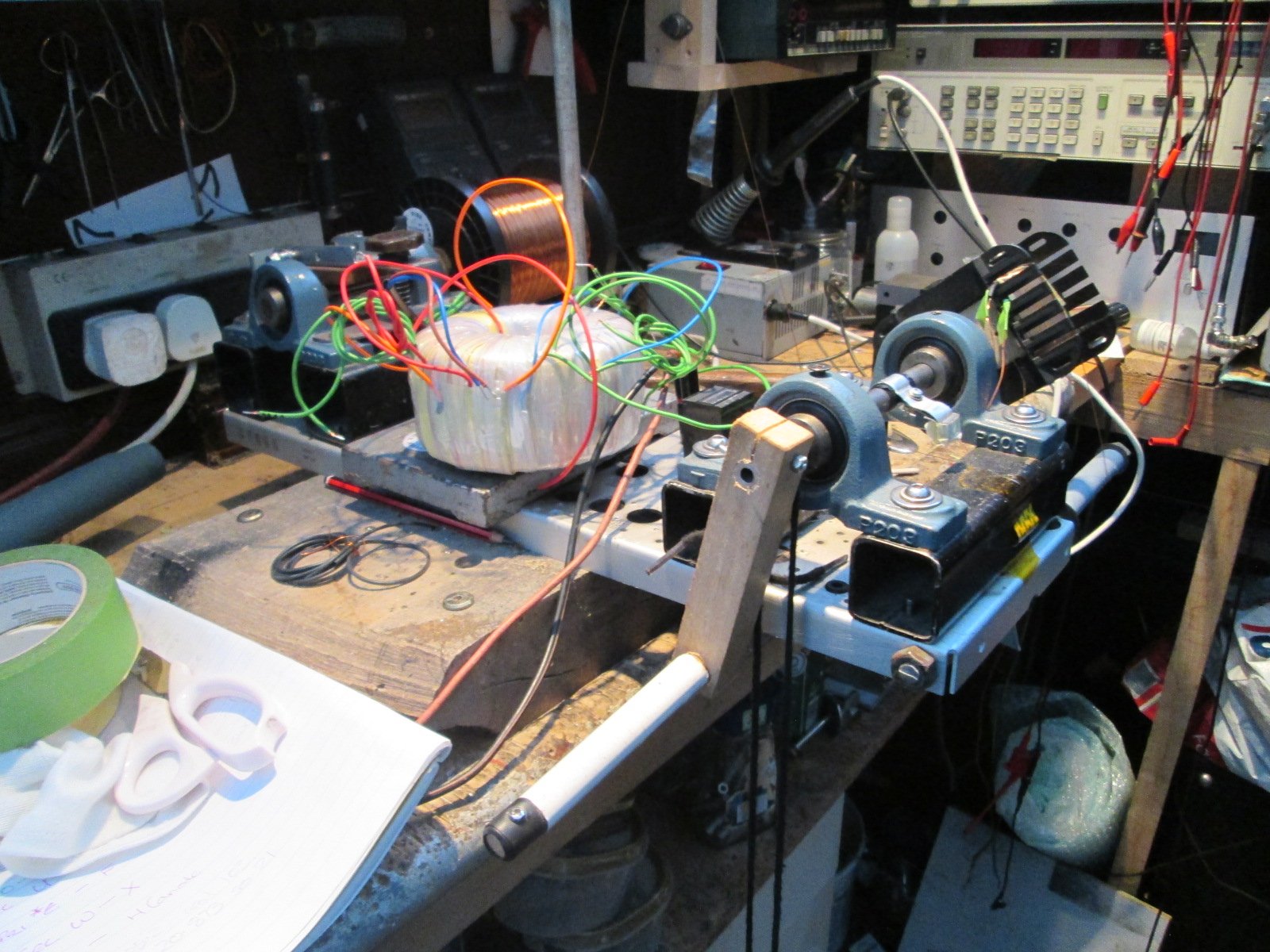

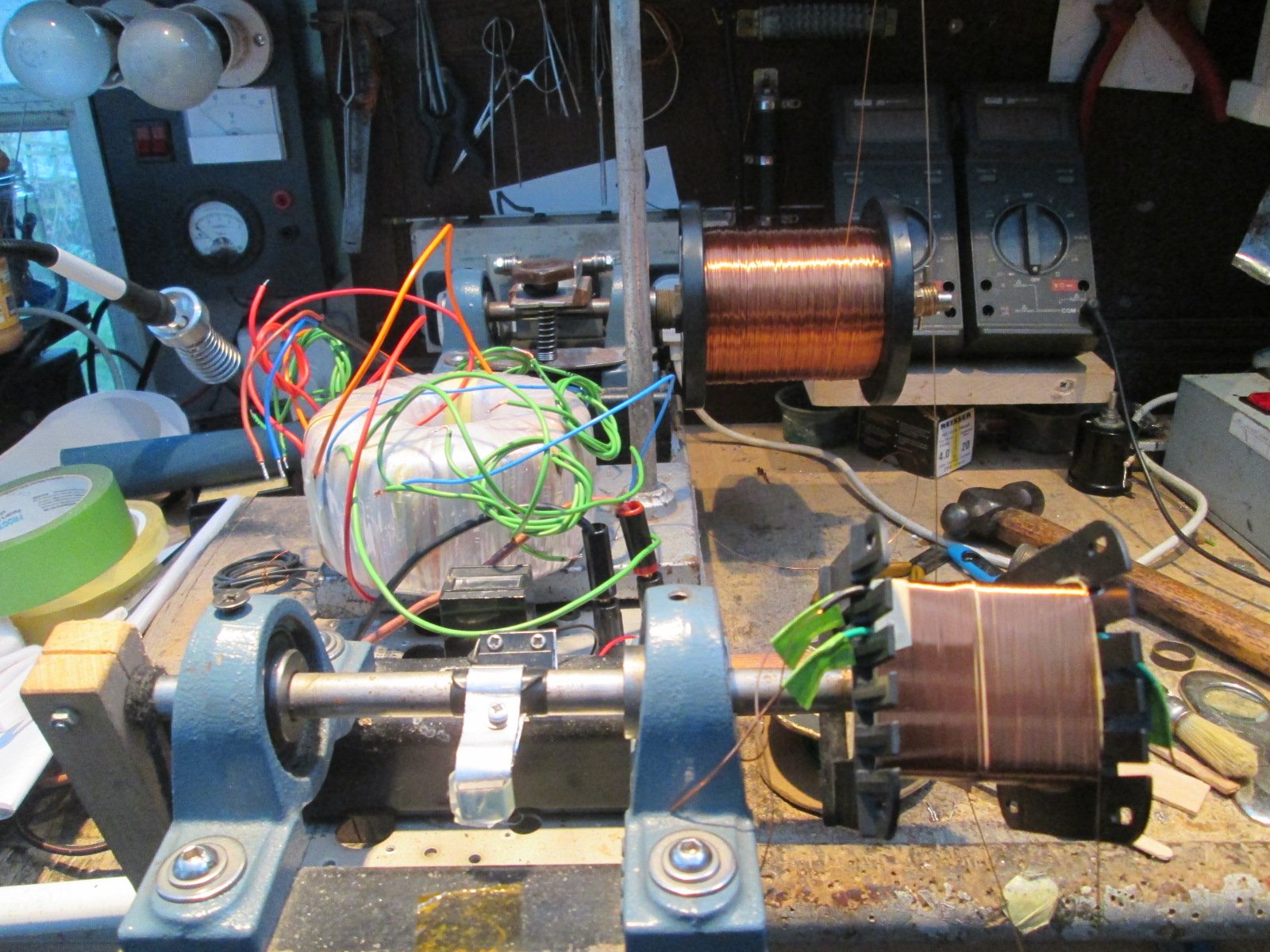

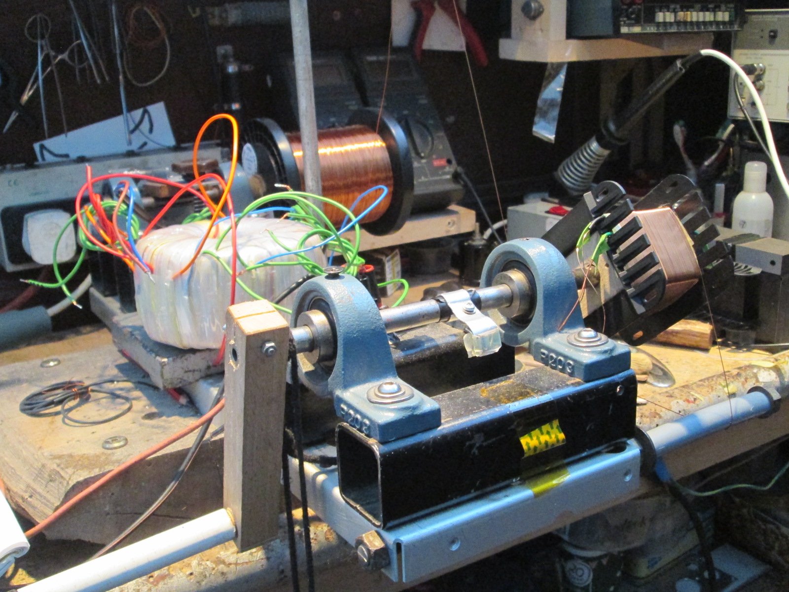

First proper OPT wind for a PPP triode AB2 amp. 2P of primary, 1/3 of secondary & 1 layer of 4P laid down, se pic.
BTW, how do others deal with partial winding layers? EG first pri wndg = 3 1/2 layers, popped the 1st sec wndg - 34T of 0.72mm in the 1/2 of layer left, but wondered if this is the EMF best coupling. So, is it better to center a partial layer, spread out the turns to fill full width of window or do as I have done to preserve/get the best layering?
As you can see the 1st layer of the next pri doesn't sit well.
Andy.

Probably better to design the transformer so all layers are either full or close enough to full, if this means that the impedances are not exact but only close to the design target that's ok ie if you design for 2.5K primary and by juggling the primary and secondary turns AND wire size you end up with full layers and 2.1K primary that's ok, the Lux transformer I recently rewound was marked 5K but measured 4.4K - designing and making an output transformer almost always results in making a compromises.
Thanks all. By multifilar I presume that means a sec 1/2 of width for instance that one winds 2T of pri to 1T of sec on the same layer, but in that case pri/secisolation is compromised isn't it?. Foil, how does that work re turns ratio? If I was to use 1 layer of foil, that's 1T?? Looks like spreading out turns is the best solution here but it don't half make winding the layer on top more difficult which means gaps like in the pics which means less window fill.
I have 2150T pri and 102T sec with a 2P, S, 4P, S, 4P , S, 2P layering, 2 x S is one layer so I guess I could have added more pri T or jiggled turns ratio/layering so that sec is two layers, ehm. What's the consensus re what I've already wound IE 1/2 layer of sec (you can see where it is by the gap, sec is on the LHS) with one layer of pri on top: remove what I've done & redo?
Andy.
